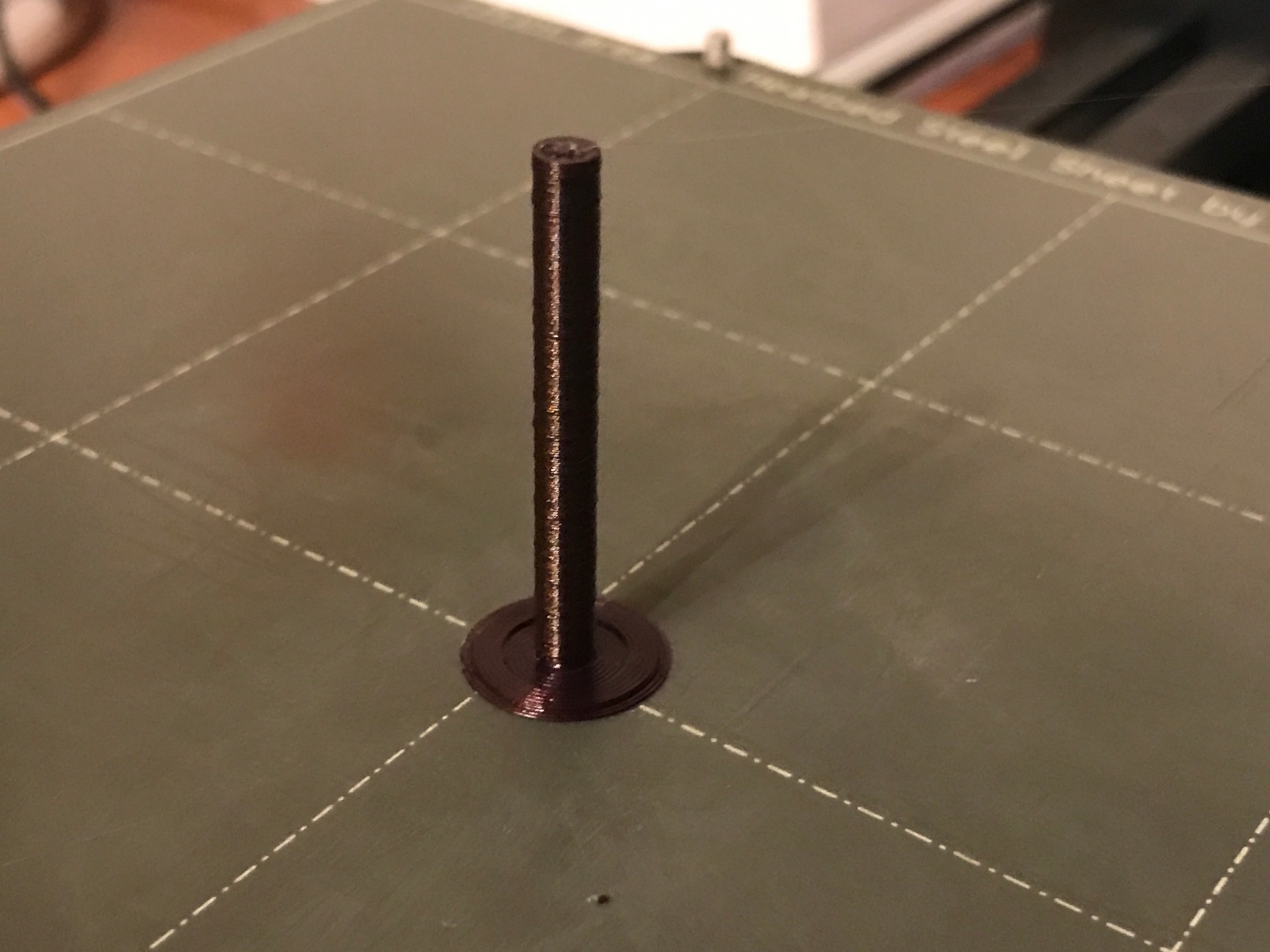

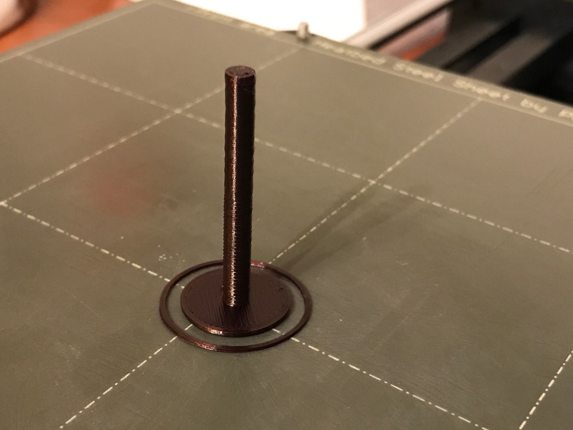

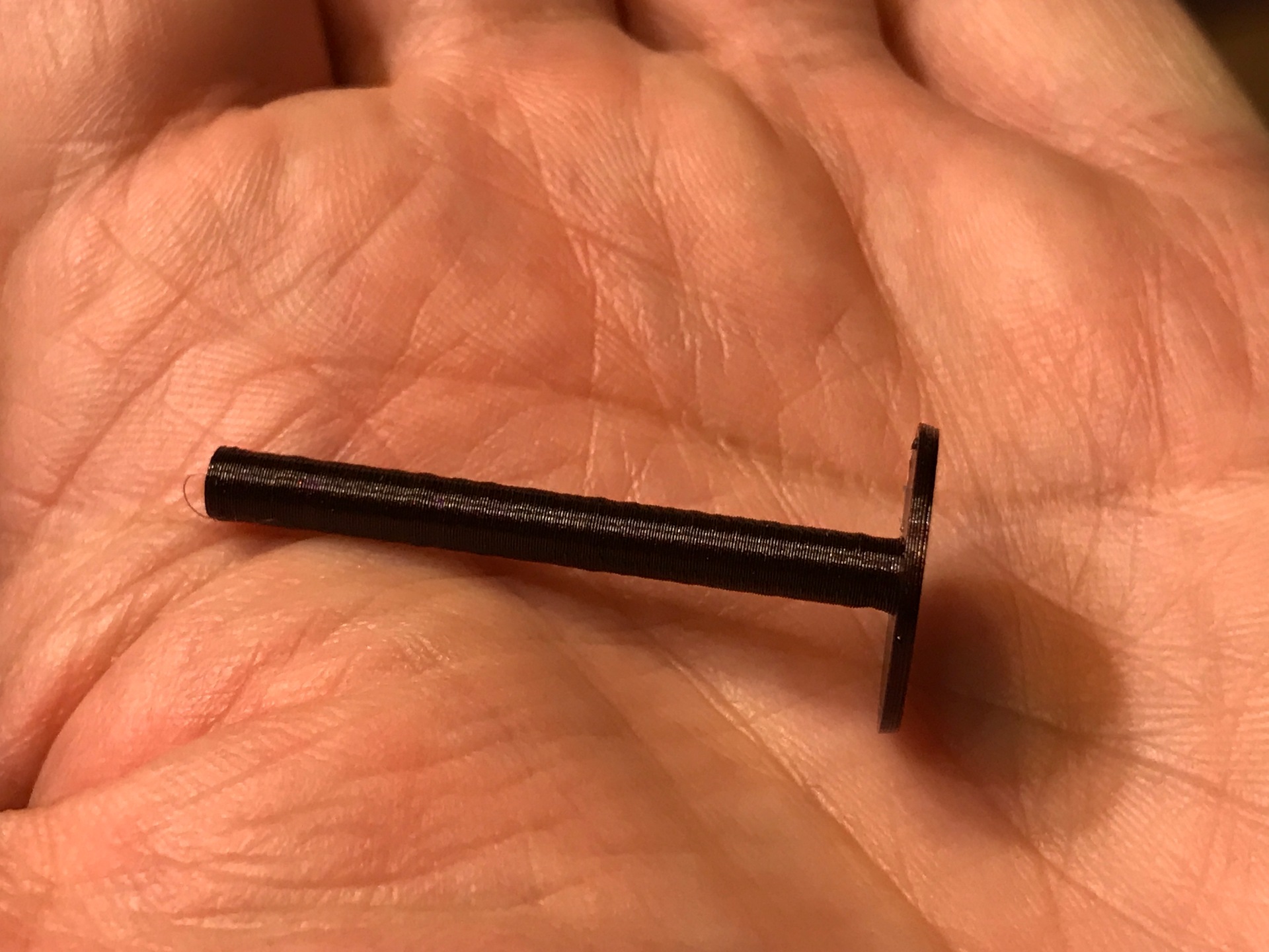

Printed using my defaults:
Posted : 19/10/2020 7:03 pm
RE: How to set consistent printed layers
I printed off 2 of them in mystic brown.  The first with your settings but my printer selected, the second with my usual print and filament settings.  Left is your settings, right is my settings.  Both had the brim for printing but mine has a tuned brim setting which mostly came off when I removed it from the bed.
Neither exhibit anything like your prints.  The left one has some seam artifacts, the regular pattern on them is caused by the seam being moved in response to where the infill is located with gyroid as it moves up the part.  For the right hand part I just used rear seam and rectilinear infill as I think its better on tall thin parts like this.
I think whatever is happening with your prints is down to the printer rather than the output gcode, unless of course there's something weird going on with the filaments Linear Advance settings.

I tried printing using this recommended settings:
- lower retraction and de-retraction speed = 35mm/s.
- The wipe is changed from 70% to 10%.
- Retraction distance is reduced to 2.2mm.
Here are the results following the 3D printing sequence:
- 01_Bondtech settings_215C.jpg - 1st print: Using your recommended settings at 215C. When I was removing the cylinder it separated from the brim. The cylinder separated from the heatbed easily and brim fell once I removed the cylinder.
- 02_Bondtech settings_230C.jpg - 2nd print: Using your recommended settings at 230C. The cylinder separated from the heatbed not so easy.
- 03_Default settings_230C.jpg - 3nd print: Using default settings at 230C. The cylinder separated from the heatbed very difficult.
- 04_Default settings_230C.jpg - 4th print: Using default settings at 230C. The cylinder separated from the heatbed very very difficult.
- 05_Default settings_215C.jpg - 5th print: Using default settings at 215C. The cylinder separated from the heatbed very very difficult.
- 06_Bondtech settings_215C.jpg - 6th print: Using your recommended settings at 215C. At the end of the printing process the cylinder wobbled at the upper part and separated from the heatbed very very easily.
- 07_Bondtech settings_215C.jpg - 6th print: Using your recommended settings at 215C. I put supporting base (another low wide cylinder) and as you can see at the button it's OK while going up causes problems.
My conclusion is:
- If the tall cylinder is stuck to the base very very well it does not wobble and does not cause the visible rings - see print 03,04,05 and 07.
- At 230 degree the filament is more liquid and does not cause wobbling of the cylinder so - no rings. The Prusament Mystic Brown is a very dense and sticky filament at temperatures like 215C.
- I think that PINDA probe is also involved as it is not temperature compensated (like MINDA) and changes its readings during printing process and stickiness to the base.
- The Gyroid pattern causes irregular levels building in this case.
- Heaving a sticky heatbed surface is also very important.
Any recommendations or thoughts?
This post was modified 5 years ago 2 times by PrusaTester2020
Posted : 20/10/2020 7:07 am

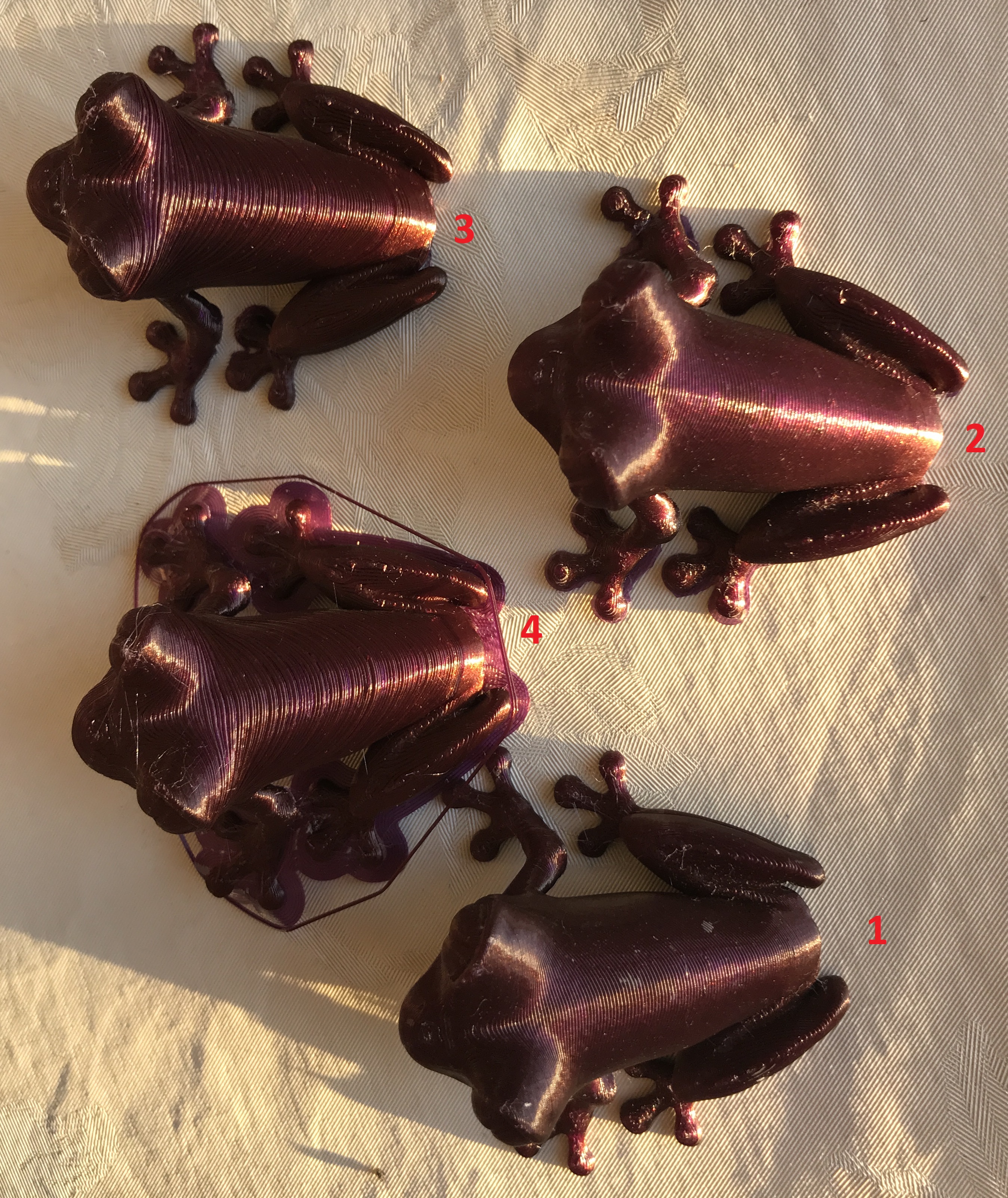

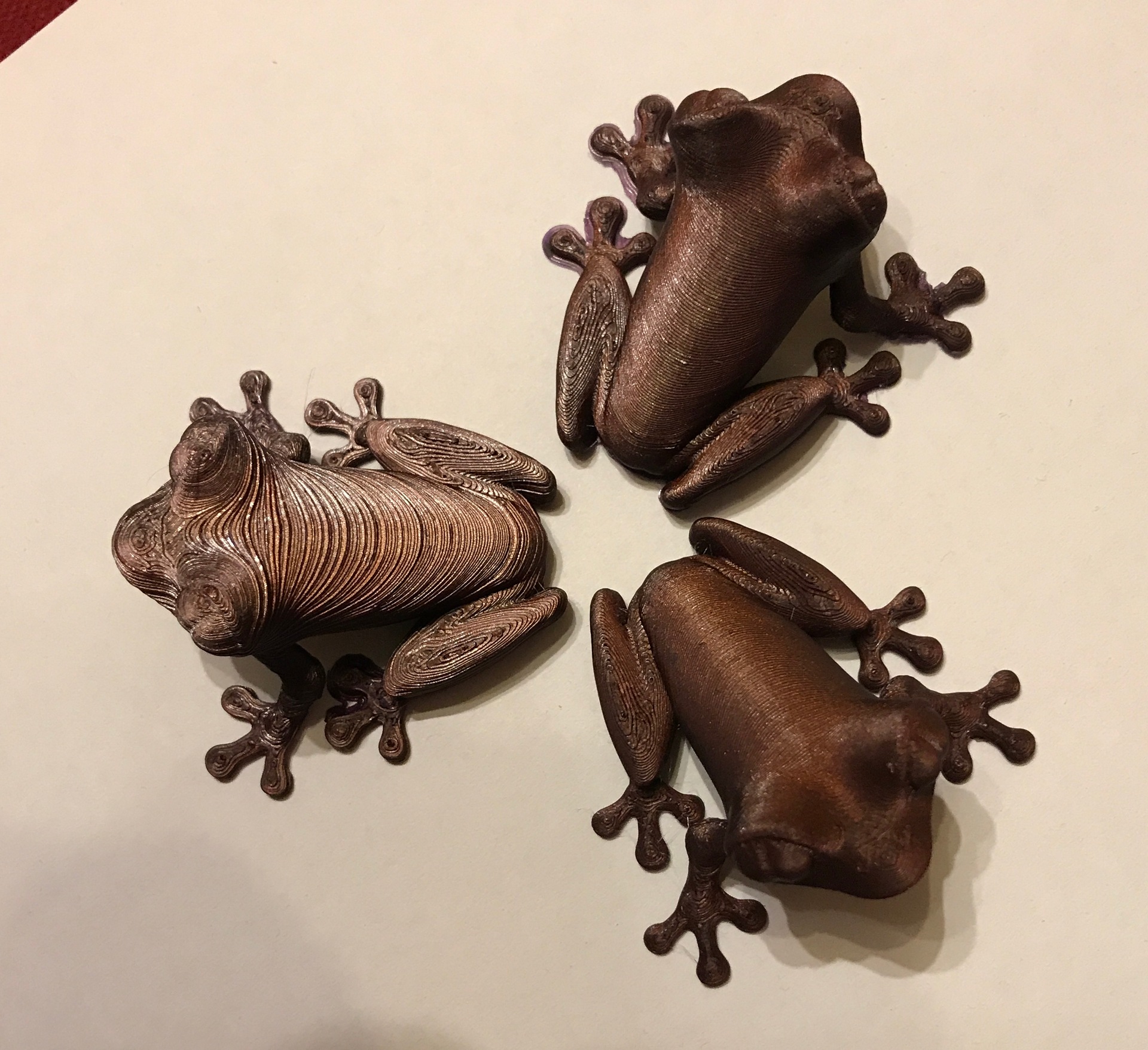

Hi!
I think I managed to find what causes all my problems.
On the following picture there are 3 frogs. Two of them are printed before upgrading to Bondtech extruder and hot-end, one of them I printed now. Guess which is the new one?
You are right! The one with thicker layers!
According to everyone recommendations I rechecked all the X,Y,Z, re-checked the Bondtech extrusion calibration (M92 E415 was pitch perfect). The extruder gives the correct amount of filament. Also did a lot of other measurements and checking, including a video how exactly the 3D printing is done in order to get clues - here it is: https://www.udoma.org/tmp/21102020/TallCone_Print.avi ).
I disassembled the hot-end block – everything was just exceptional. And finally I remembered that when I changed the hot-end I also changed the (Fu.. Da.. !?!%$#) nozzle with a brand new one ordered from the manufacturer. And according to the site it was 0.4 original nozzle for Prusa Mini. I compared it with the old one and they do not look the same – the new one had а little more thread.
I carefully re-assemled the hotend block using the old nozzle. And here are the results at 215C from first print:
It seems the new nozzle is just not OK and is more then 0.4 mm:
Any ideas how could I measure it’s diameter?
This post was modified 5 years ago 4 times by PrusaTester2020
Put it in the extruder, set Slicer to extrude a 0.45 mm wall cube, print the cube, measure the wall. If not 0.45 mm thick, the nozzle isn't 0.4 mm.
I guess the upside is your printer is working as expected again. +1
This post was modified 5 years ago 2 times by --
Posted : 21/10/2020 2:05 am

Sorry but the problem appeared today. It seemed it's not only the nozzle.
Frogs 1 and 2 are from before, 3 is with the new nozzle and 4 is with the old nozzle printed yesterday:
I also printed a first level calibration shape and found that there are zones which were printed later during the printer process (the thicker triangles marked with red) which are higher/thicker then the rest part of the squares. Is this normal or it's a indicator that Z-Axis does not position the layers consistently? MINDA is not involved in this process isn't it?
Posted : 22/10/2020 2:14 pm
