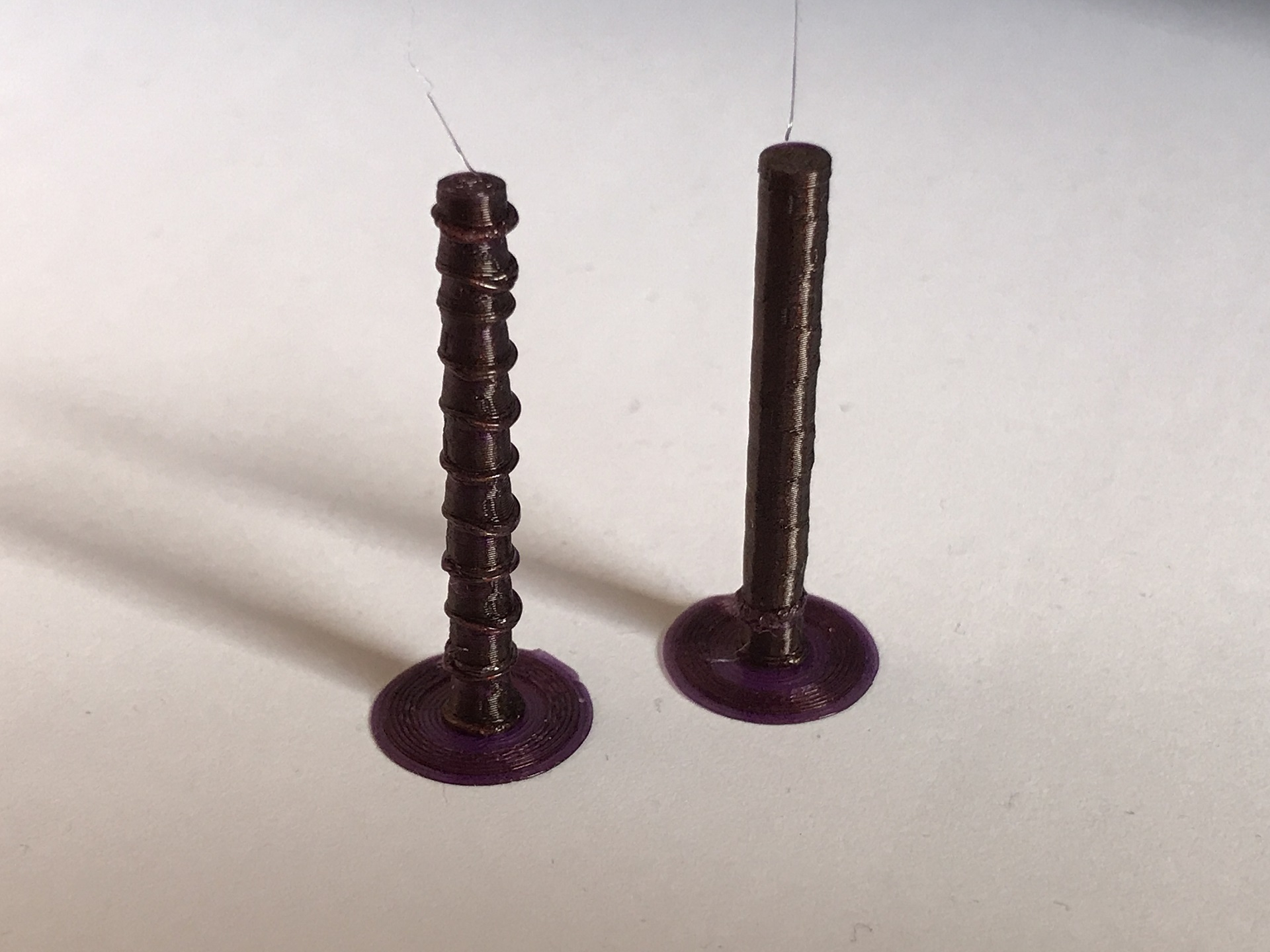

I was printing a fox figure with thin legs using my Prusa Mini at 0.15 mm thickness using Prusa filament “Prusament Premium PLA Mystic Brown”. All settings were default using PrusaSlicer. Suddenly the thin legs became inconsistent and I cancelled the print. I managed to reproduce the issue by printing a simple tall cylinder 4x4x36 mm with a brim using the same settings.

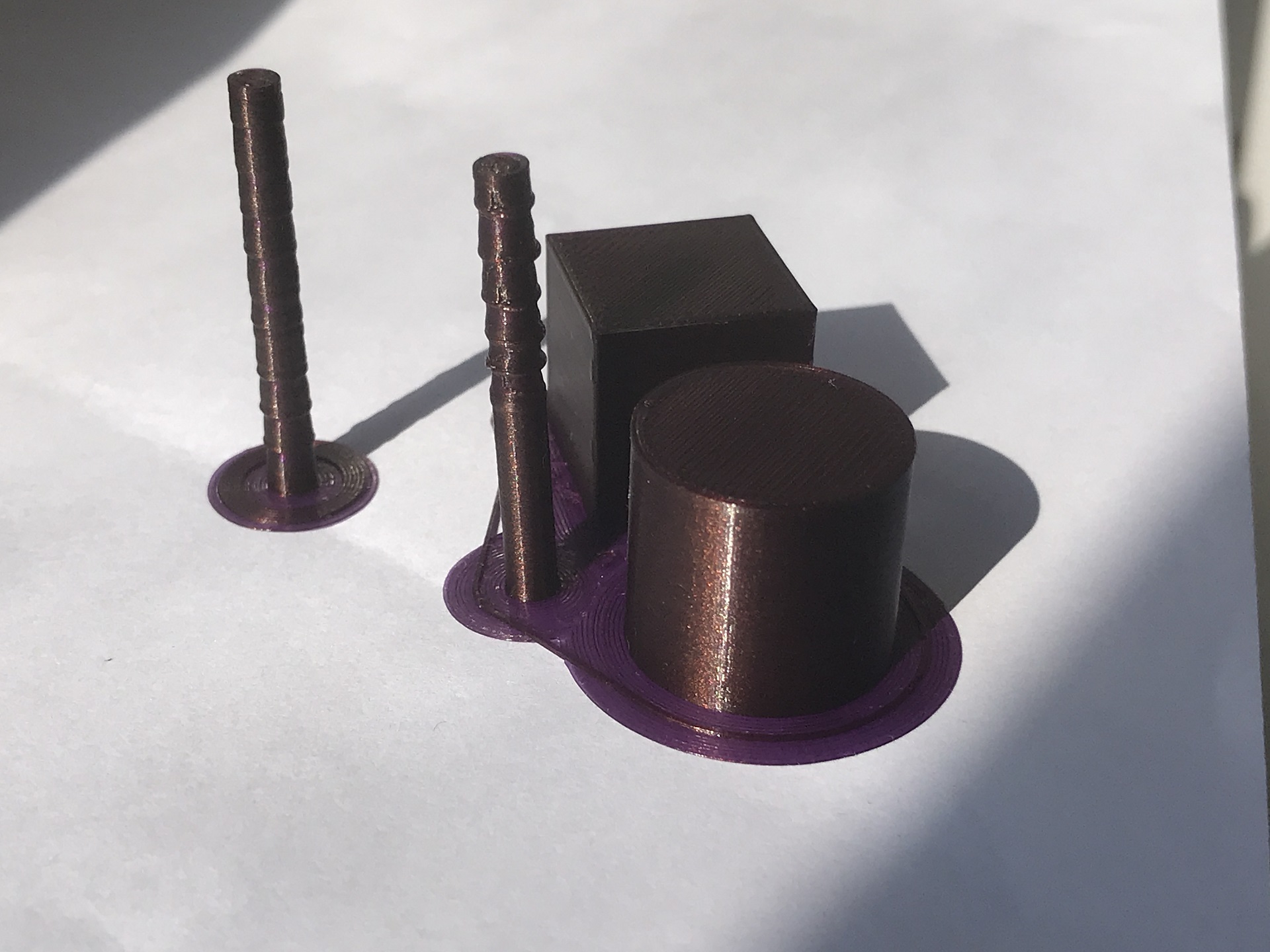

The result was that every few millimeters on Z axis the tall cylinder produces a thicker layer/s. I printed the same tall cylinder together with a cube and another cylinder and the issue did not appear until all three figures were printed together. The issue appeared again after the tall cylinder remained the only object to print, as seen from the picture – on the left is the stand alone printed tall cylinder and on the right is the same tall cylinder printer together with the two other figures:
Left Printed Standalone - Right Printed Together
I tried slowing down the printing speed which worsened the problem. Also printing at 0.07 mm. thickness (again using default values from PrusaSlicer) worsened the problem. Finally raised the default temperature from 215 to 230 degree Celsius and this nearly solved the issue as seen from the picture – on the left is the tall cylinder using 215 degree Celsius and slower speed and on the right is the same cylinder printed using 230 degree Celsius:
Left At 215 Degree Using Slow Speed - Right At 230 Degree
I carefully monitored the whole printing process and found that on every layer the Bondtech extruder picks some filament until suddenly it skips picking up filament for 2-3 layers then continues and may be this is causing the described issue. For me there is a problem with inconsistent/uneven flow of the filament.

As a small recommendation - don't print tall thin pieces alone. Print something else next to it, second piece or something. If you print only one print like that, material has no time to cool down and you get ugly melted print. Head moving to another object gives enough time to cool down.
Ok, but when at the end you have tall ears or horns of animals? Put a tall cylinder next to the animal to solve the issue?

That's actually a valid solution people sometimes use when printing minis for example, or print more copies at once. Horns and stuff are hard to print, 2 ears or 2+ horns may be doable but one is tough and those prints usually don't look as good. Only thing I can come p with is maybe increasing cooling, but if you don;t want to do that for the whole print (Filament Settings -> Cooling) you may need to do kludges like do a filament change at certain layer height and pretend it's different filament with different cooling parameters.
