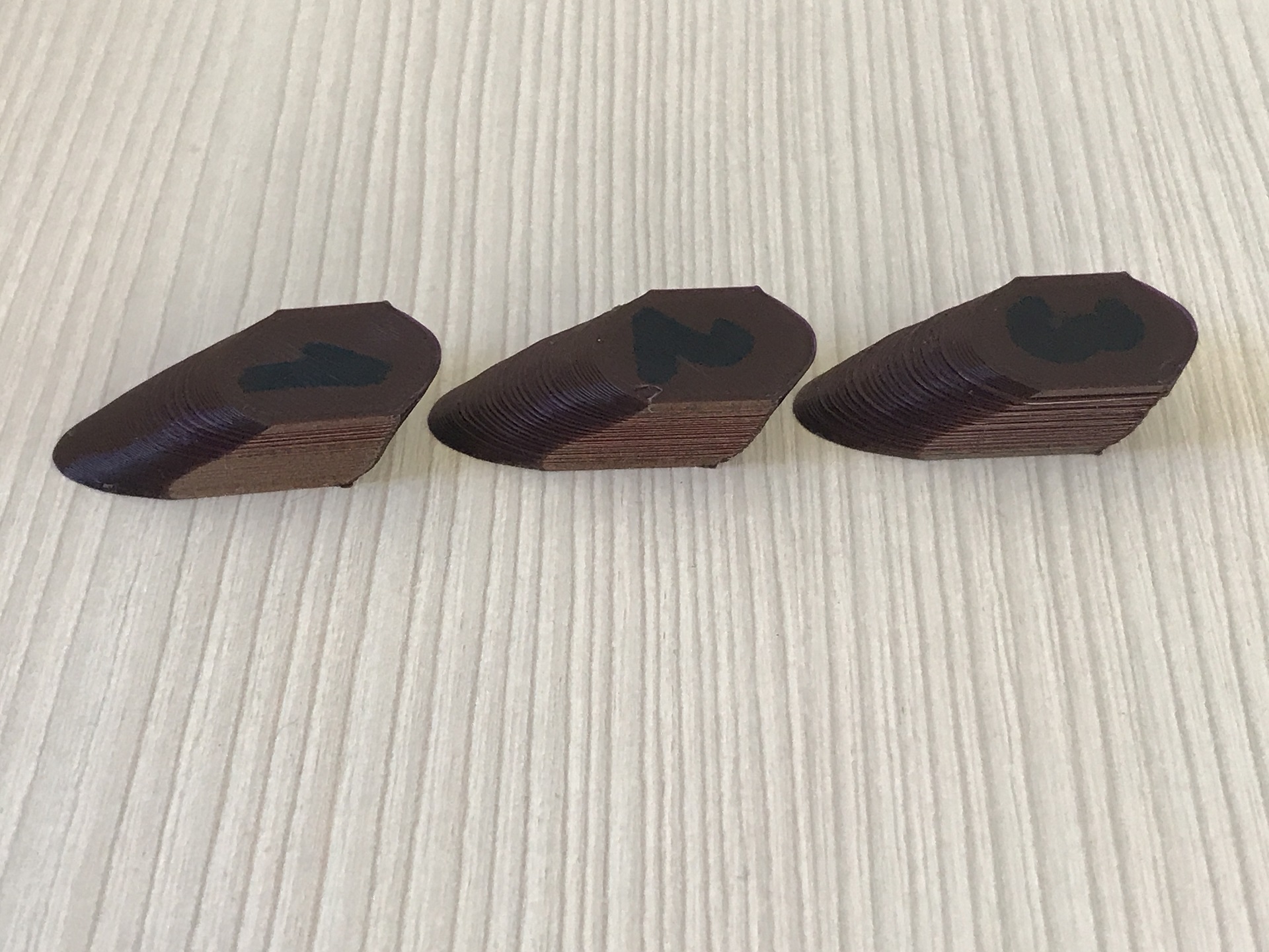

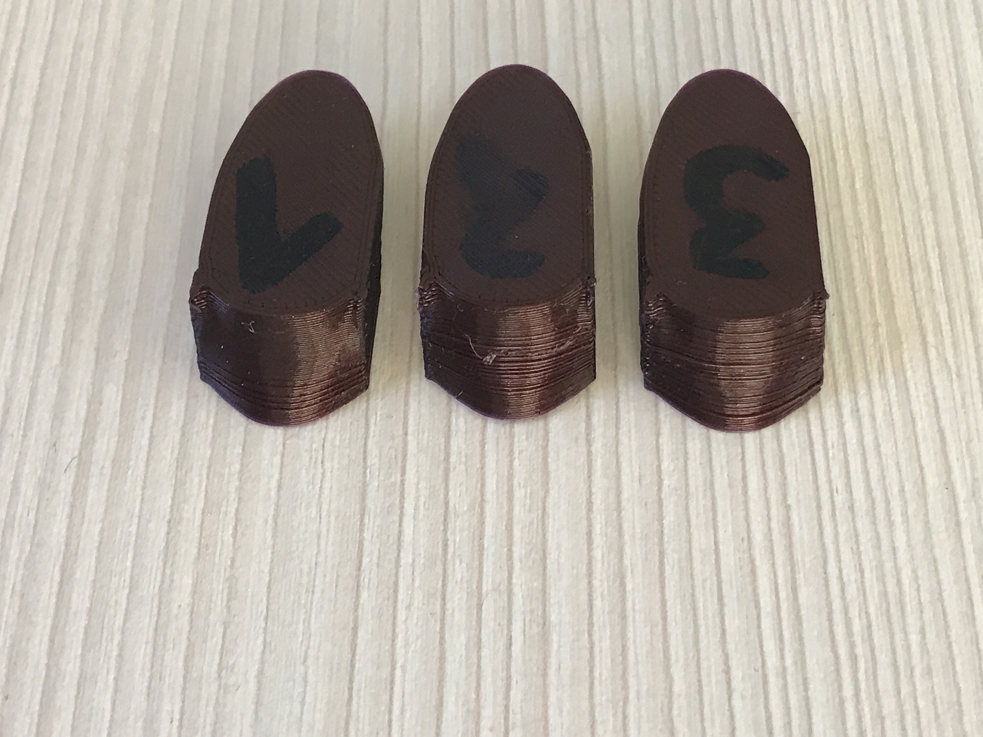

RE: How to set consistent printed layers

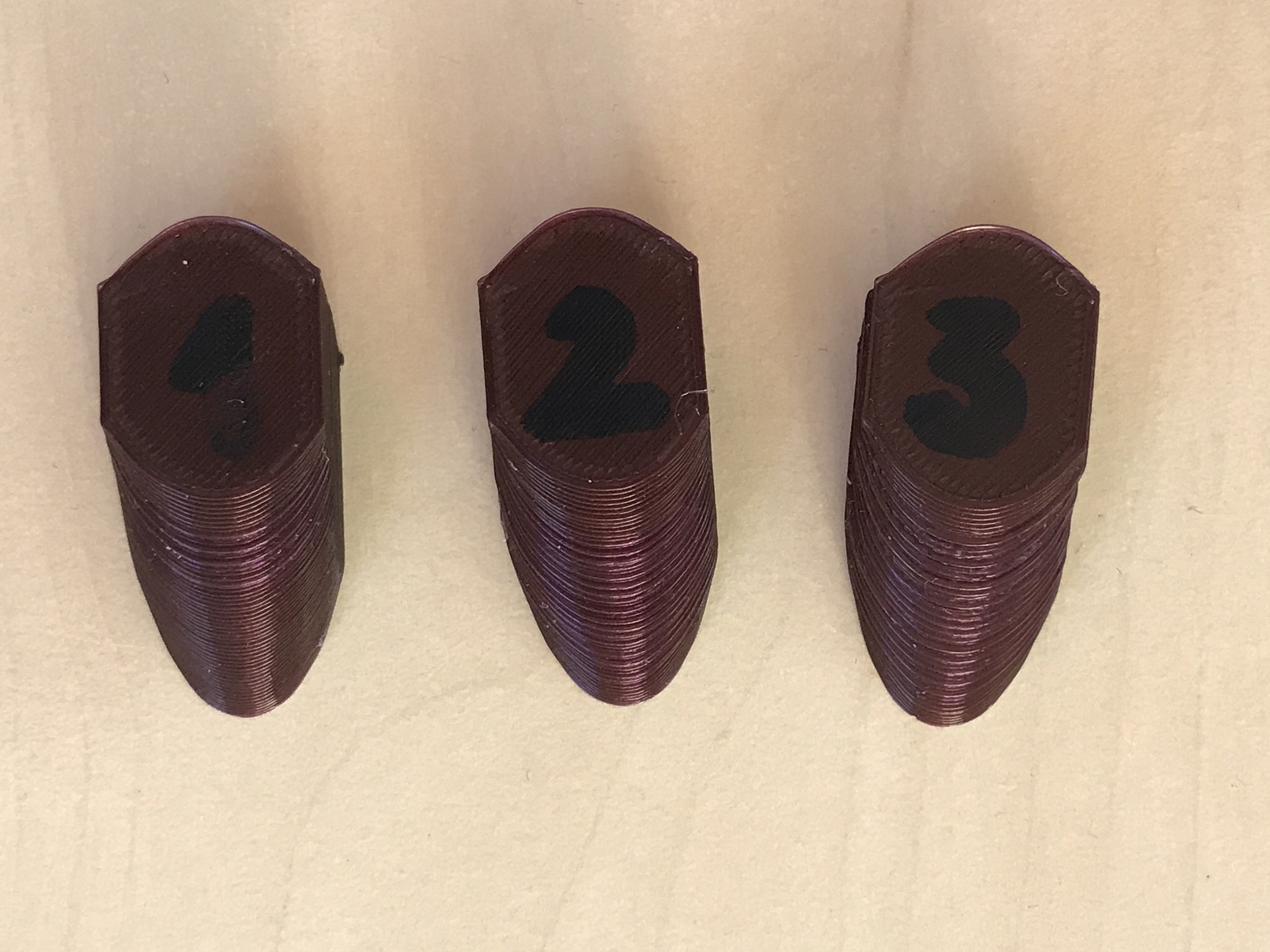

I adjusted the belt tension just before the frog print. They were not too lose and not too tight. Will print a cone figure to see the layer shift type.
Here are prints from just the back of the frog. 1 is OK until the middle, while 2 and 3 are mostly not ok:

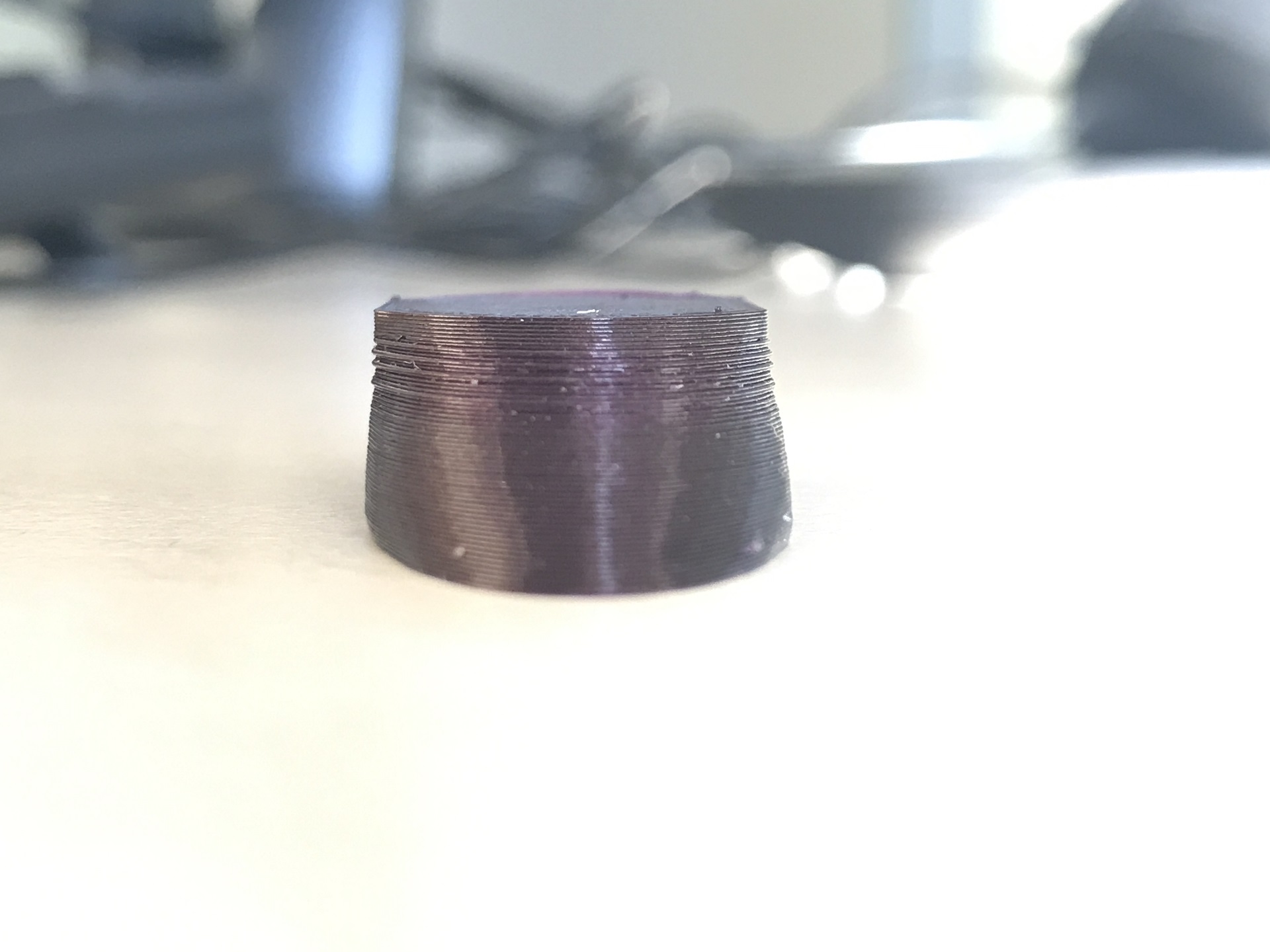

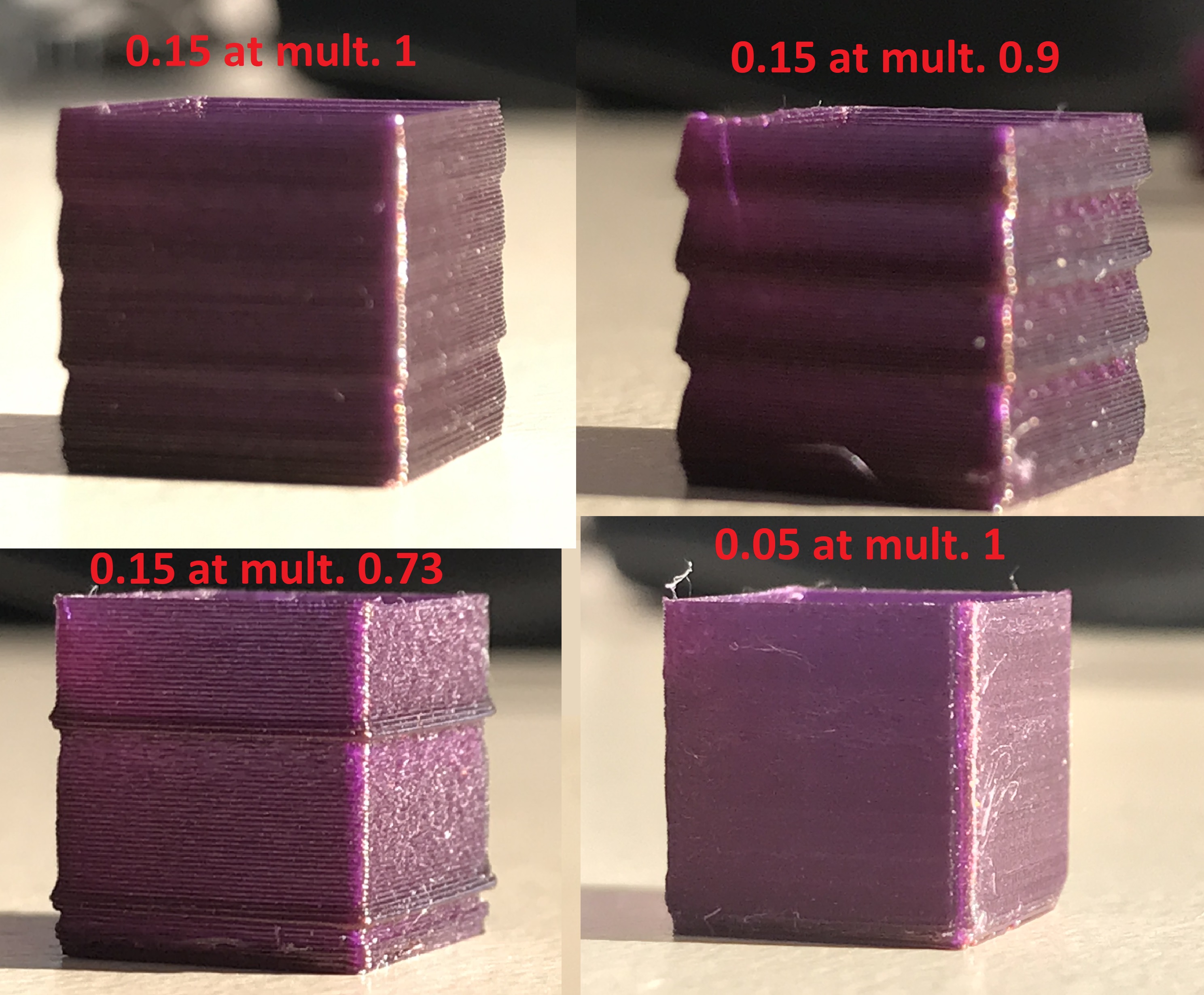

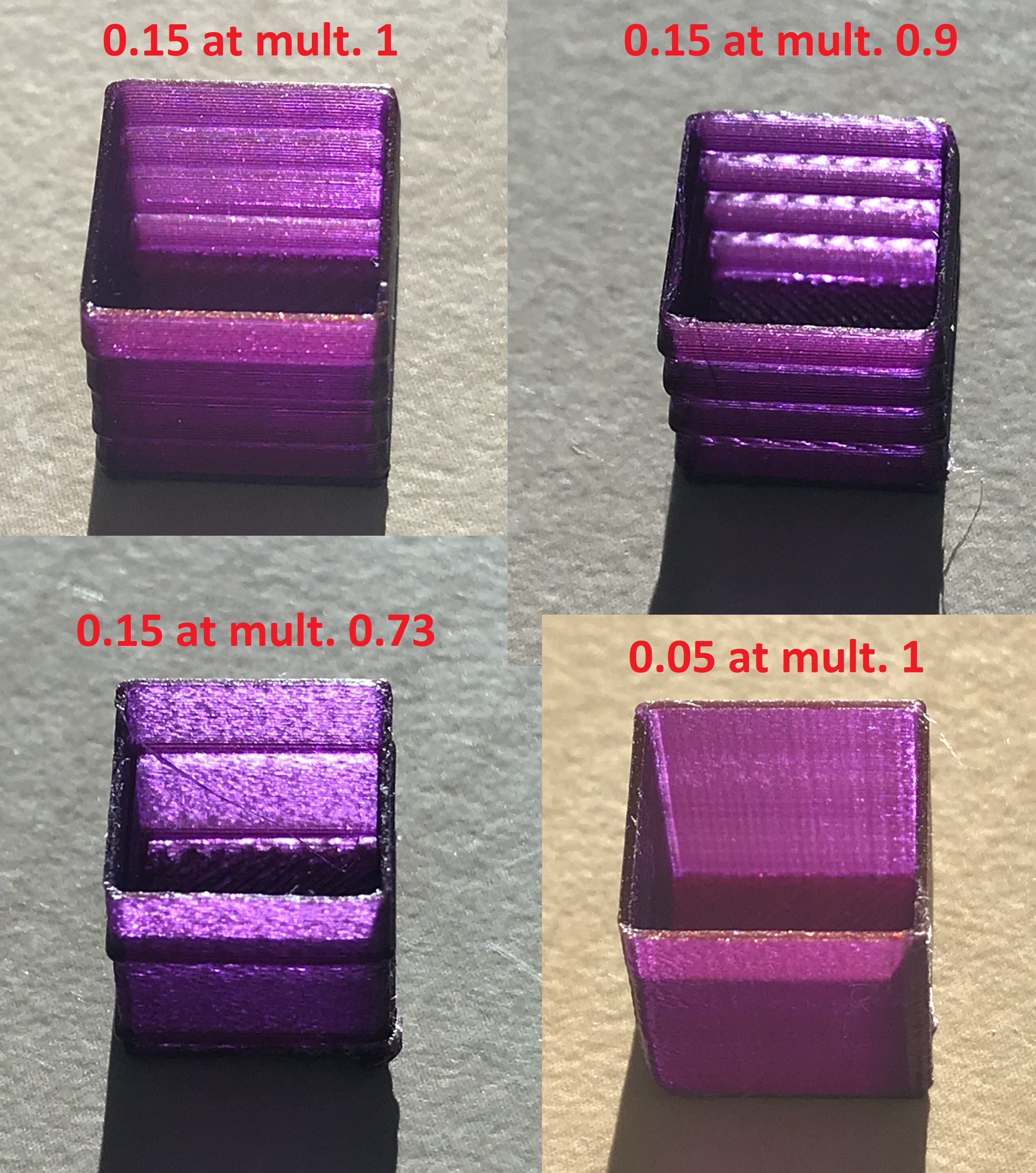

I tried printing a calibration cube 10x10x10mm in vase mode using 0.15mm default profile with Filament | Extrusion multipliers 1, 0.9, 0.73. Also tried 0.05mm profile with multiplier 1.
https://www.udoma.org/tmp/23102020/Cube_015_x090.3mf
https://www.udoma.org/tmp/23102020/Cube_015_x073.3mf
https://www.udoma.org/tmp/23102020/Cube_015_x1.3mf
https://www.udoma.org/tmp/23102020/Cube_005_x1.3mf
Here are the results:
Also here are the results using sunlight passing through the front wall:
What I see is that if I use 0.05mm default profile everything is OK and the wall is flat.
Using 0.15mm default profile the extrusion is not regular at all – there is a thick part which causes a bulge both on the front and back side of the wall. Going up the bulge then decrees until the next bulge appears. The interesting part is when printing with 0.73 extrusion multiplier the bulge transforms into thicker line.
What causes these bulges and are they normal?
You have a belt or pulley or dry bearing problem.  Check both X and Y belt drive gears are properly affixed to the motor shafts. And rods should have a light coat of oil or grease on them.
Loosen both set screws enough the belt drive gear can turn freely on the shaft; first, align the gear and tighten the set screw on the flat of the shaft; then tighten the locking set screw on the shaft round.
Next, use the MINI user assembly manual and properly adjust the belt tensions on X and Y belts.
In any case, those test cubes show a hardware/assembly problem, not a software problem.
Did all that. Prove me I am wrong but if X and/or Y axis were involved then the X/Y coordinates should move. What I see is that the walls are strait with symmetrical bulges that are fat at the bottom side and thin at top. To me this is an overextrusion (hotend or extruder)  and/or Z-axis issue. Otherwise the cube walls would be shifting, but they don't.

No need to prove you wrong - you've already done that by posting images of test cubes with axis problems.

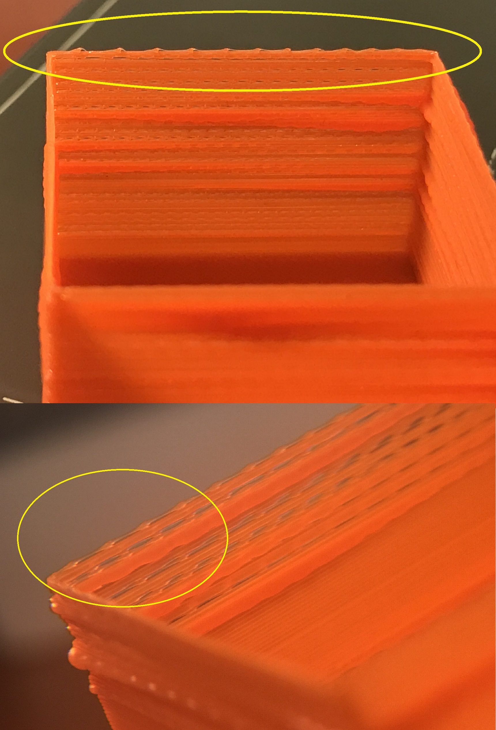

This is a picture from my last print of 30x30x20mm figure using Prusament orange and Prusa Mini defaults for 0.20mm Quality print ( https://www.udoma.org/tmp/23102020/DropsBumps.3mf ) at 215C:
I paused the print to show the latest layer. Looking at the layer building using a magnifying glass I saw that the nozzle covers the layer using drops/bumps (marked with yellow) - it's like it came from a sewing machine. Raising the temperature to 230C most of the time fixes this issue and the layers become normal.
I am using Bondtech heatbreak and extruder. Does any of you have a slightest idea what is causing these behavior?!?

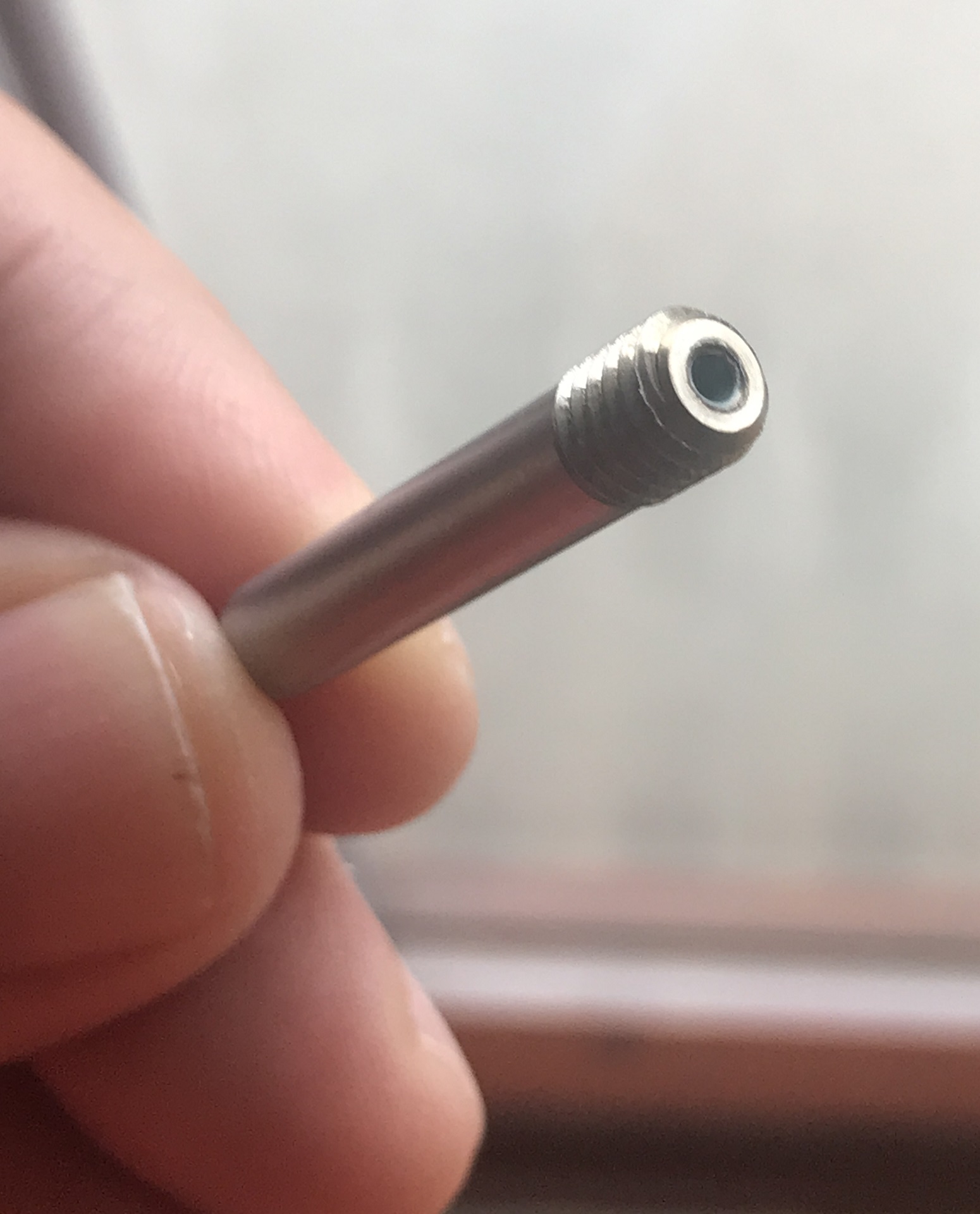

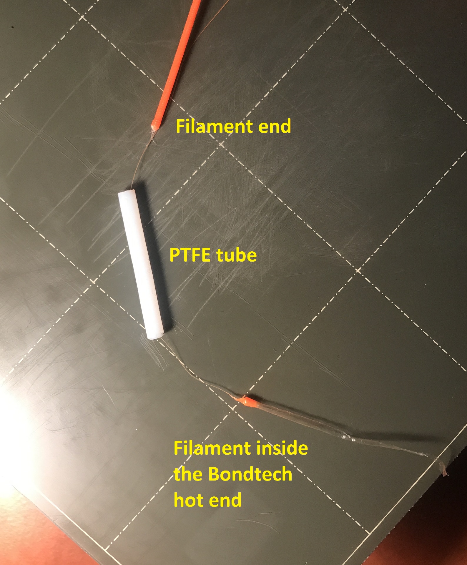

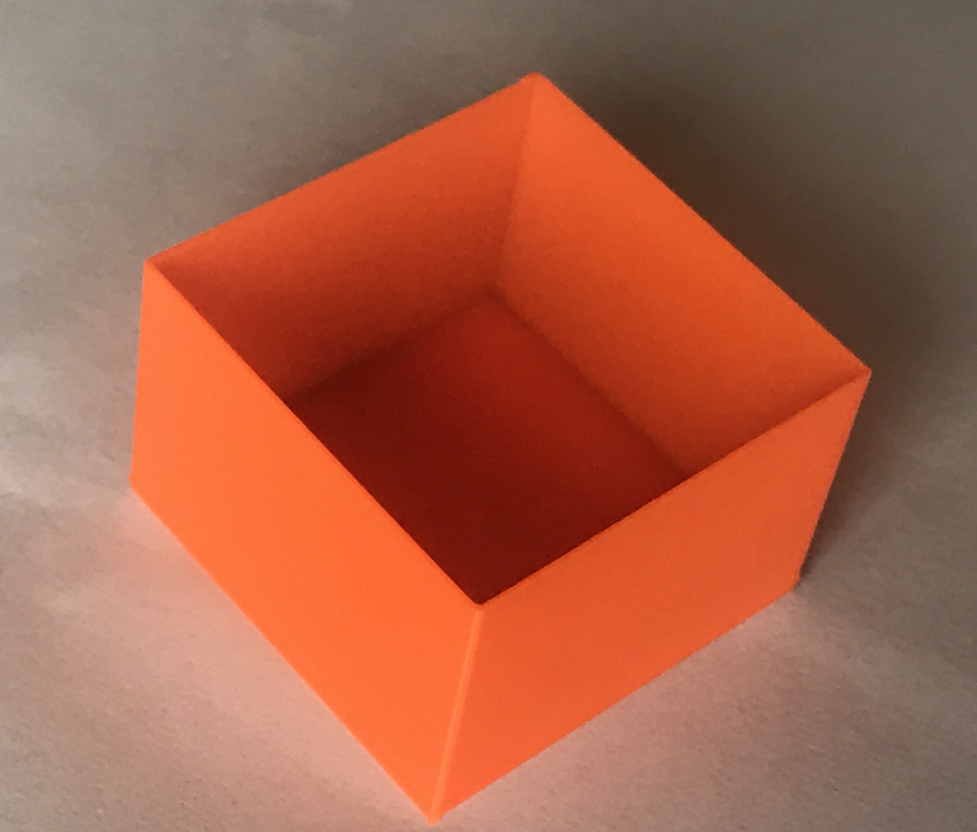

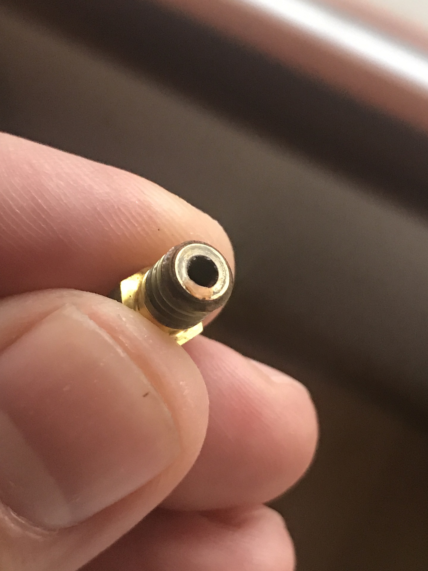

Hi!
Finally managed to completely fix the problem by putting back the original Prusa Mini hot end.

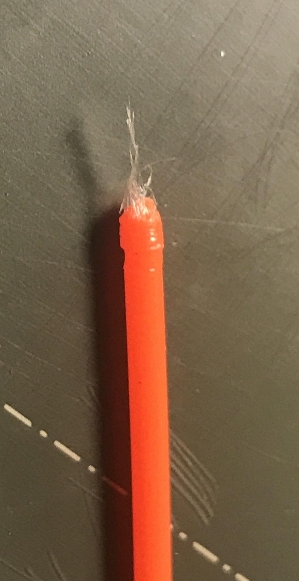

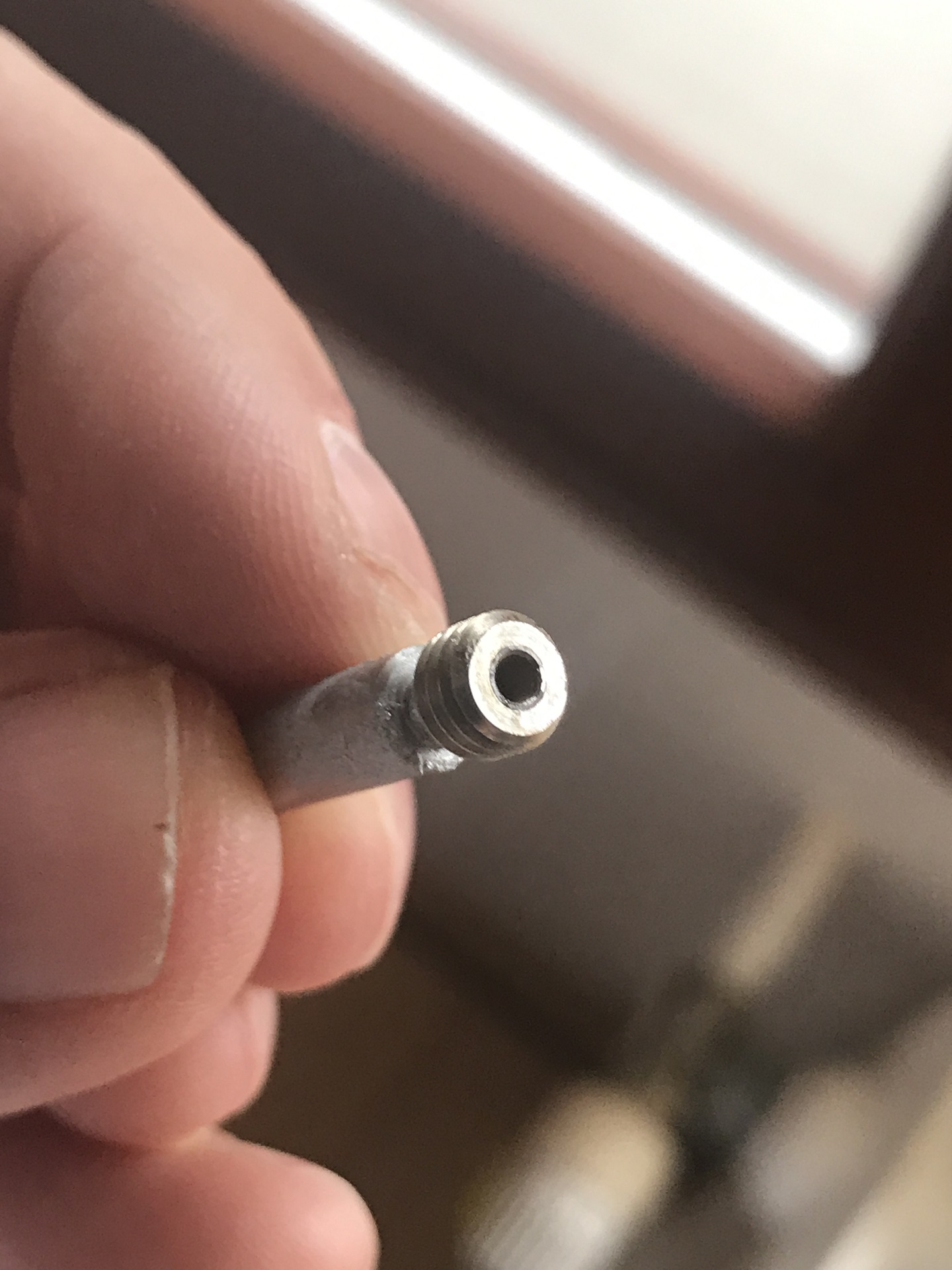

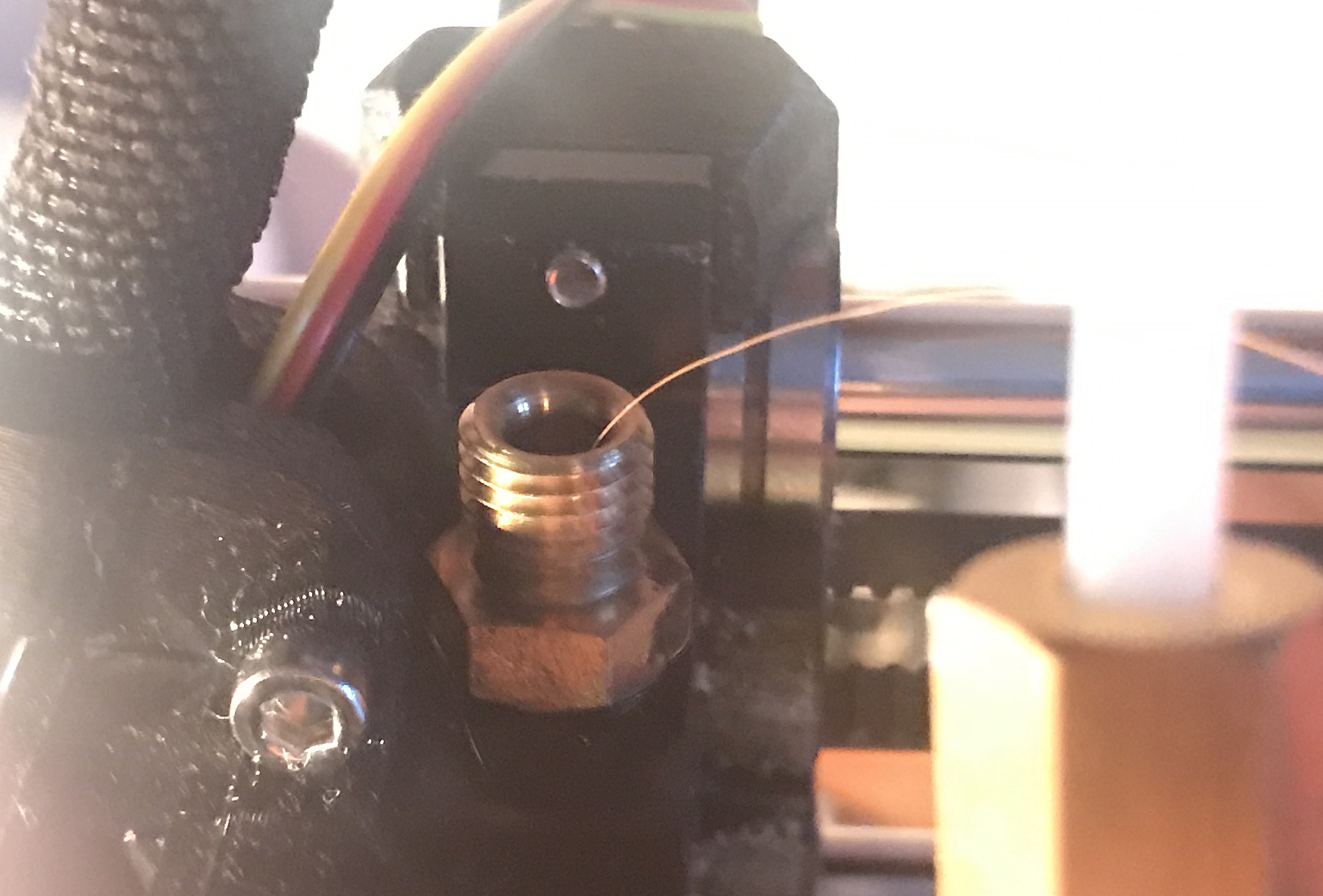

During the Bondtech hot-end disassembly I carefully looked what could potentially cause the problem when using it. Here are photos of different components during the disassembly:
1. The filament when unloaded from the printer:
2. A thin string was present when I opened the heat-break section from above:
3. After raising the nozzle temperature, I managed to easily extract the PTFE tube pulling the string. Here is what I extracted:
4. Nozzle end (there is a filament on it!):
5. Bondtech hot end:
6. Prusa Mini hot end with slightly cone-shaped end that could help when tightening to the heat-break:
7. Calibration cube perfectly printed using Prusa Mini hot end:
As I see from the nozzle end (photo 4) there is a filament on it which means that there was a gap between the heat-break and the nozzle OR this filament dropped there when I unscrew the nozzle at 280C.
The gap could explain the issue - could it !?! Any other suggestions?

It looked like before the nozzle the filament was held or redirected into a container while the nozzle itself was dripping material drop by drop as seen on the pictures. At certain point of time the container/suction was then released by increased pressure causing the filament to overflow for some time. Raising the temperature over 225C most of the time prevented this to happen.
