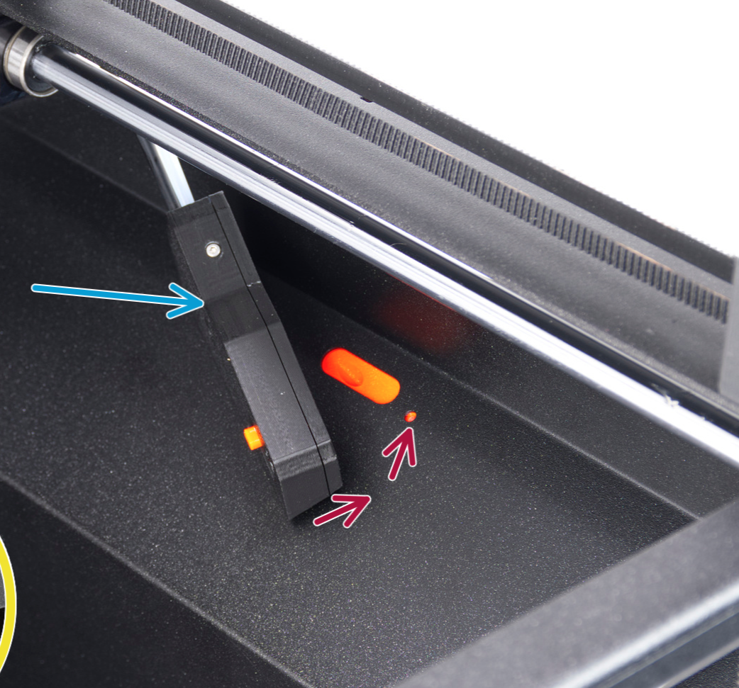

So for that to work, we would need a redesigned side panel as there just isn't any proper way short of getting a grinder out. We will probably change the design in the near future for "new" printers that are ordered, and also make it available as an optional extra on the store for older models if they want to have a less "hacky" option of getting it to work that way.
From my experience the bucket would only start to cause problems at about 4000 color changes and there are very few prints realistically coming close to that, but I know many users like to push the machine as hard as I do, so having a better option is always nice.
Posted : 22/06/2026 11:42 am

@tommy_prusa3d-cm do you think there is enough of an angle to make a slide -instead of a basket- for the poop pieces to slide down and enter the existing hole on the panel? (picture taken from the assembly instructions)
