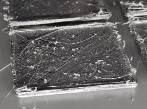

I was too slow editing the last post...here are two pictures of what it looks like at the moment. It starts out with layers that are fine and then gets quite bad...

The printing got a little better. However, only when more or less constantly making sure the filament is not going into the nextruder in a sharp corner and keeping the top lid open of course. As you can see in the picture the closer to the top (the bin is sideways) the more missing lines. But also at the very bottom you can see missing lines.

This looks like a partial clog due to heat creep. PLA can get soft in the heat break tube which creates a temporary plug that blocks flow. Pressure builds up and pushes the plug through which then builds up again and re-blocks. This is what causes the gaps.
Check the chamber temp, make sure it stays below 35°. Open the door if necessary. Also try decreasing the nozzle temperature by 5-10°
Is this a gridfinity box? One trick is print two side by side which forces a travel move between each layer. Part of the problem is that heat from the part itself could be softening the filament in the heatbreak tube.
This is precisely why I don't print with PLA anymore. I would use PETG or PCTG here instead.

Forgot to emphasize in my previous post: decrease nozzle temp 5° and open the door.

Regarding the suggestion to use PETG instead: This is what Prusa support wanted me to test as well, why they shipped a roll PETG prusament. The results with a gridfinity bin sliced with the default Slicer settings for Prusament turned to bad in the first couple of layers. See the image below....
