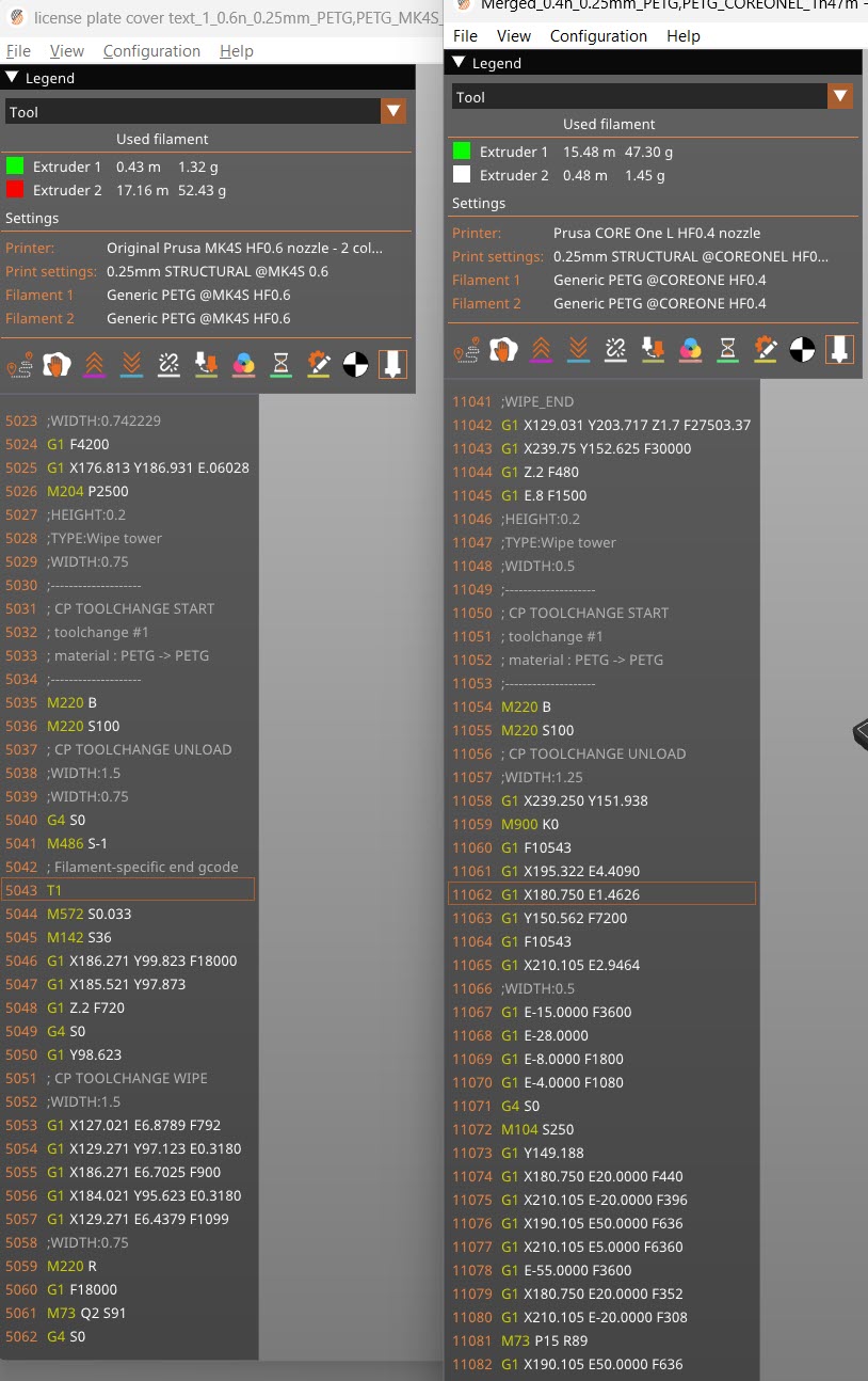

I am trying to print some lettering in a different color than the background.  It looks like it all sliced correctly, but the printer did not stop and ask me to change the filament as I had expected it would.  It printed the background color and then the wipe tower and then went right on printing the letters in the base color.
Am I supposed to put in a manual filament change code?  I don't see how because the change is not at a layer boundary.  I have attached a pic of the extruder/filament list.  The print is just a bit too big to print as one unit so I had to break it into 2 parts and each letter became a part.  I merged them back together (I think).
Thanks for any help.

What you're doing is correct.
I did the same a few weeks ago and found out, that you have to copy the "Color change G-Code" to the "Tool change G-Code" field under Printer->Custom G-Code
The article that Shane references explains how to setup a color change where you want to have the same color for the whole layer, for inlaid text, your approach is the right one.

It looks like you are trying to set it to print with a MMU3 attached to the core one L, but sounds like you do not have one.
In order to do what you want, you need to add a M600 / color change.
you can take a look at this and it should help you
https://help.prusa3d.com/article/color-change_1687

Thanks for the reply.  Yes, I am trying to be my own MMU.  The color change procedure in the article you cite is good for between layers but I need to change in the middle of a layer.  I can see the wipe tower start in the gcode.  It looks like the slicer forgot to put the color change in there.
I tried this same thing with my MK4 and I get a lot of gcode about wipe and tool change at the cross over point.  I think the slicer has an error.
I did not run the MK4 gcode, but I did run a very similar thing on a smaller project on my MK3 and that prompted me to change filament without my adding anything special

That worked with one unexpected thing.  I had the filament all loaded for the base color and the first thing it asked me to do was change filament.  So I unloaded it and reloaded it and then things ran as expected.  I got the change requests I was looking for.
