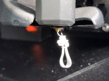

one more thing I would like to mention is how it looks when purging filament. At first the filament curls and once that curly ball drops it looks as though the filament is somehow pulled forward. It is not flowing down exactly straight. Unfortunately, I cannot remember if it looked like that while the printer was working properly.
Not sure if that tells anything at all....

In my more innocent days, I would have said that purge is not normal. Then I used a heavily pigmented filament and got a purge that looked like a fat worm, once it decided to drop straight. It might have been larger than the incoming filament! It was also PLA Blend and drying it helped a lot. Being white, yours might be normal. My black PLA (Buddy3D) purges in a shiny straight line and measures less then 0.5 mm from a 0.4 mm nozzle. I leave it out a lot and it doesn't seem to pick up much water. What kind of PETG did Prusa send you? Have you tried a "simple" filament like a non-silk black PLA?
