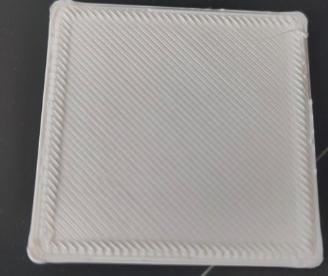

General: The issue appears when feeding filament through PTFE tube and when feeding directly to the extruder. Pushing filament through the extruder when doing a cold pull works fine.

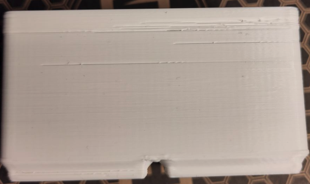

Currently when I send the gridfinity bin 2×3 to the printer, it starts out looking fine, but after about 4 layers, it startes to underextrude again. No print finishes anymore.

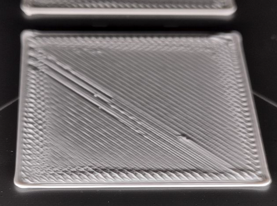

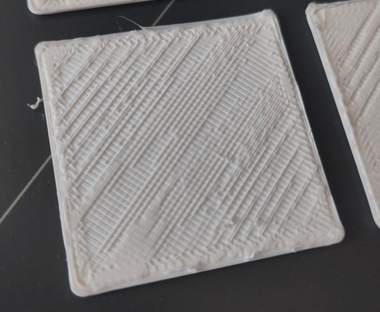

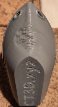

I was too slow editing the last post...here are two pictures of what it looks like at the moment. It starts out with layers that are fine and then gets quite bad...

IMO, the Nextruder shouldn't be clicking at all. Divide and conquer! Either the Nextruder can't pull the filament for some downstream reason, or there's something wrong with it. I can't imagine it's a problem with PLA, but just to be sure, pull the Teflon tube out of the Nextruder and try to pull filament through it from that end. It should be easy. I mention this only because I found some soft filaments can easily be pushed from the spool end but are impossible to pull from the head end. If you can pull easily, then the problem is (most likely) something to do with the Nextruder assembly. Make sure the bearings in the arm (no doubt it has a name!) turn freely and smoothly. The ends of the tension screws should be flush with the end of the threaded hole. Double check how far the nozzle extends from the block. You've already checked and changed most of this, so I'm hoping you'll find some problem that binds up the filament on its way to the Nextruder.

This looks like a partial clog due to heat creep. PLA can get soft in the heat break tube which creates a temporary plug that blocks flow. Pressure builds up and pushes the plug through which then builds up again and re-blocks. This is what causes the gaps.
Check the chamber temp, make sure it stays below 35°. Open the door if necessary. Also try decreasing the nozzle temperature by 5-10°
Is this a gridfinity box? One trick is print two side by side which forces a travel move between each layer. Part of the problem is that heat from the part itself could be softening the filament in the heatbreak tube.
This is precisely why I don't print with PLA anymore. I would use PETG or PCTG here instead.

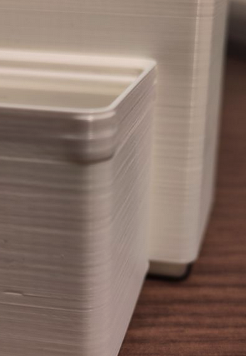

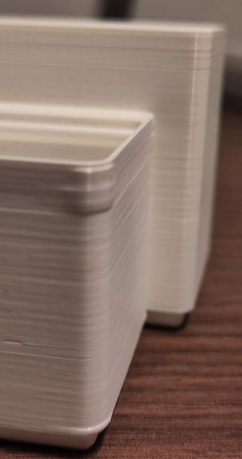

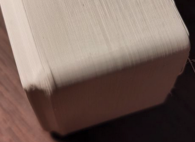

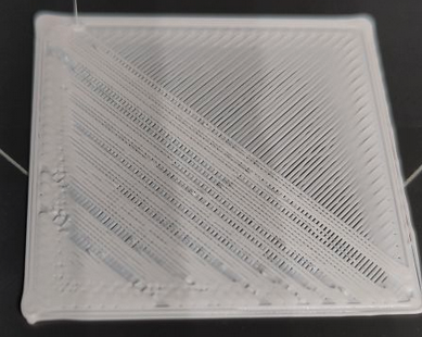

Comparing the half finished printed box, to one printed earlier this year it seems not as clean as the old prints. Especially the bottom where the bin widens looks a bit flabby - although quite hard to capture on camera. However, it is of course not the same gcode that is printed. The old example was another shape of the box.
New print:
Old print:
Attempt 3

  • result is looking okay, still not as clean around the edges as the earlier prints, as mentioned above 🤔
The box in the front is the new one, in the back the old one.

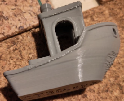

  • Object: Benchy boat
  • Filament: Buddy 3d Filament grey
  • default benchy from printer usb drive, 15min benchy, immediate underextrusion
  • benchy from printables newly sliced 45min print time estimate, default slicer settings
  • stealth mode on / door closed / top lid closed but with vents open
  • print probing at 170/170 | 60/60 | 33/20 | 38
  • print start at 230/230 | 60/60 | 33/20 | 39
  • 48 min: 230/230 | 60/60 | 34/20 | 40
  • result overall okay from my point of view, not as good as my first benchys, however, front of boat of poor quality

Check your fans.  Make sure there is no fine stringing clogging the hubs and the blades are clean.  Check the fan shrouds are undamaged.
Cheeru=io,
Posted : 18/03/2026 7:38 am
Agree with @diem. Seems (in the case of the Benchy) there might be an issue with airflow from the part cooling fan

I have now started a gridfinity bin in PLA. It was sliced with Prusa Slicer's default settings. The print fan is off while printing it. Should it be off? It was off but turned on now. The heatbreak fan is regulated with different rpm.
Can you tell, if the heatbreak temperature values I posted above are in the normal range?

Attempt 7
The print started out quite fine. However, around 30 minutes into printing, it starts to fail again:
  • Print started with door closed (as yesterday)
  • top lid attached, vent open
  • stealth mode on from the beginning this time
  • Now at around 30min into printing, clicking noise from the extruder starts again and printer is underextruding.
  • Heatbreak and printing fan were both running
  • temps at nozzle 230/230 | chamber 33/20 | bed 60/60 | heatbreak 38
  • Paused the print and let the door and top lid open for a while.
  • Temp chamber is down to 27/20.
  • Resumed print with open top lid and door.
  • Still underextrusion
  • after 2-3 layers underextrusion stopped again
  • top lid attached and door closed again
  • temps again at nozzle 230/230 | chamber 32/20 | bed 60/60 | heatbreak 38
  • no underextrusion for around 5 minutes
  • underextrusion started again
The bin is the same size as yesterday's attempt 5 where also at around 30 mins underextrusion started, then went away again.
