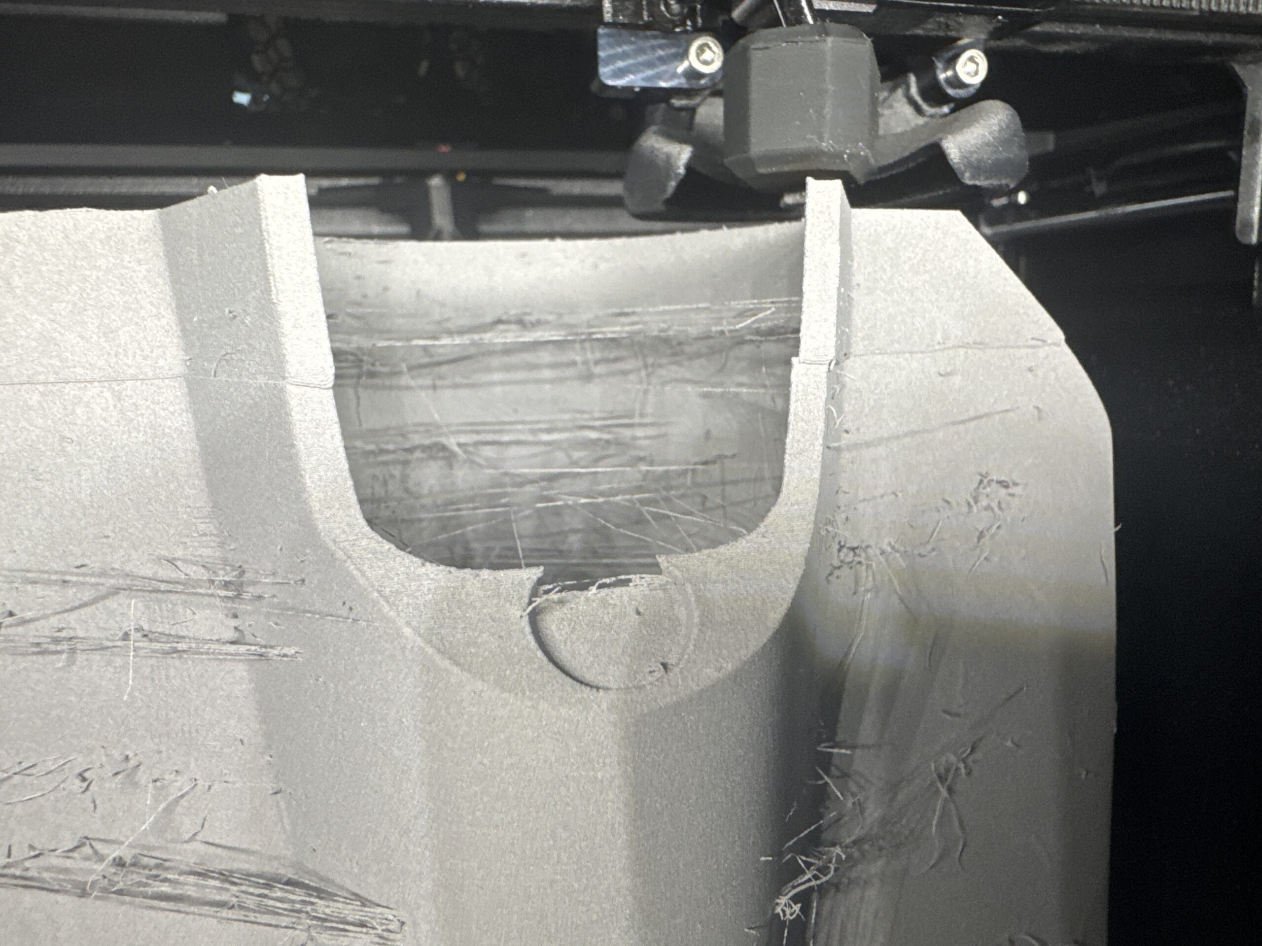

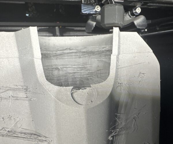

I stumbled upon this thread after I'm having the same issue... but mine is at exact same height.
I did belt tuning, in-fact.. more than 5 time in last 4 weeks to reduce VFA, also calibrated IP and phase step.. Between the first and second, I have tuned belt and between the 3d (you will see a video) I loosen belt and tuned again with prusa's built in manual belt tuning.
  • I sliced using Orca slicer
  • Did turn on the Avoid wall crossing
  • PLA 0.2mm FAST profile
  • NOT IN VASE mode, I wanted to print with small infill..
So, did you try to turn "avoid crossing perimeters" OFF? According to multiple posts above, that option seems to be what triggers the problem in PrusaSlicer, causing it to generate unreasonable moves in GCode. I am not sure whether BambuStudio and OrcaSlicer have inherited the problem from PrusaSlicer, but being based on the same code, they might well have.
Not sure why you mention Vase mode. I don't recall seeing that mentioned as a potential cause for the problem?

I haven't tried without the "Avoid wall crossing", I did try to slice from Prusa Slicer with the "Avoid crossing perimeters" and it did crash at the same point. I will give it a try with these options turned off later and update here the results.
I replied here with the avoid wall crossing/Avoid crossing perimeters options turned on, because I want to use this options to reduce stringing.
I also noticed that Prusa sliced model print slowly compare to Orca slicer, but that could be down to how the in-fill and other variations.
I mentioned the vase mode, just to clarify that I'm not printing this in vase mode (This model is good to print in vase mode).

Update: I try printing with `avoid crossing perimeters` turned OFF, using Orca Slicer and 0.25mm Speed profile; Print completed without issue.Lots of stringing, but no layer shift. That means, on my part, it is a slicer issue instead of hardware issue!
I tried some simple cylinder and oval shapes with `avoid crossing perimeters` Turned ON and they printed without issues too..
I'm guessing that complex models have some issues. I noticed that printer made loud noise just before layer shift happened... It sounded like banging on the side of the printer.
Shouldn't the Printer detect this as Crash and Home before continue?

the loud bang is what people have reported hearing when the machine tries to do a high speed direction change, typical of the usage of  "avoid crossing..."; other layer shift with loud noise have been reported when filament gobbled up on the extruder or on the model and the extruded collided with the model.
Since you are seeing a lot of stringing, it may be worth checking if your filament is dry. Even rolls taken out of sealed bags for the first time may be not dry enough.

I have had the layer shift issue too, but I never turned on those settings, so I know for a fact that is not the cause. I fixed my printing issues by moving the purge block right next to my print, and the next time I printed a long tall object, it finished just fine. Mine was not circular either. So it will happen with or without those above mentioned settings, and on almost any shape, not like some here are saying it only happens with tall circular objects. It seems to do with the high speed directional changes of the print head assembly. By moving the purge block right next to the object, the printer seems to not accelerate as quickly, and then no layer shift occures.
