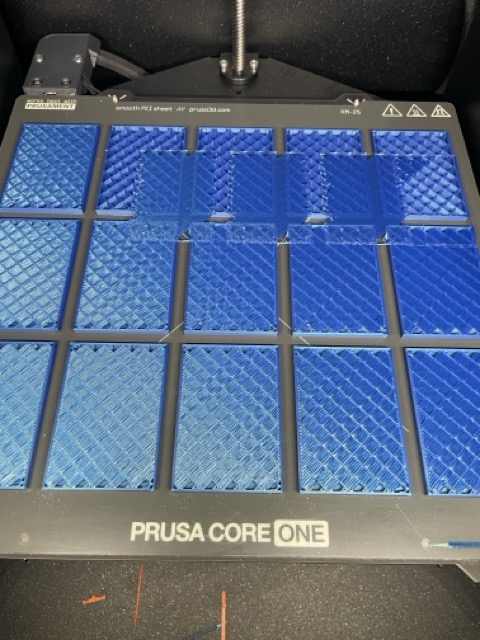

I have been trying to print a part (also a part I sell) and am running into the same issue with layer shifting. I have re-tensioned belts and still get consistent layer shifting, though it's not always in the same spot. Due to the nature of the part, I have to use the "Avoid crossing perimeters" feature in the slicer. Based on this bug I believe that is the root cause of my issues. I haven't had any layer shifting on other prints on this printer.
I noticed that the printer makes violent travel moves before the layer shift occurs. It appears that the printer is also ignoring any settings in my attempt to override the very rapid travel. I am printing in "normal" mode, not stealth mode.
I am on 6.3.4+10511 of the firmware.

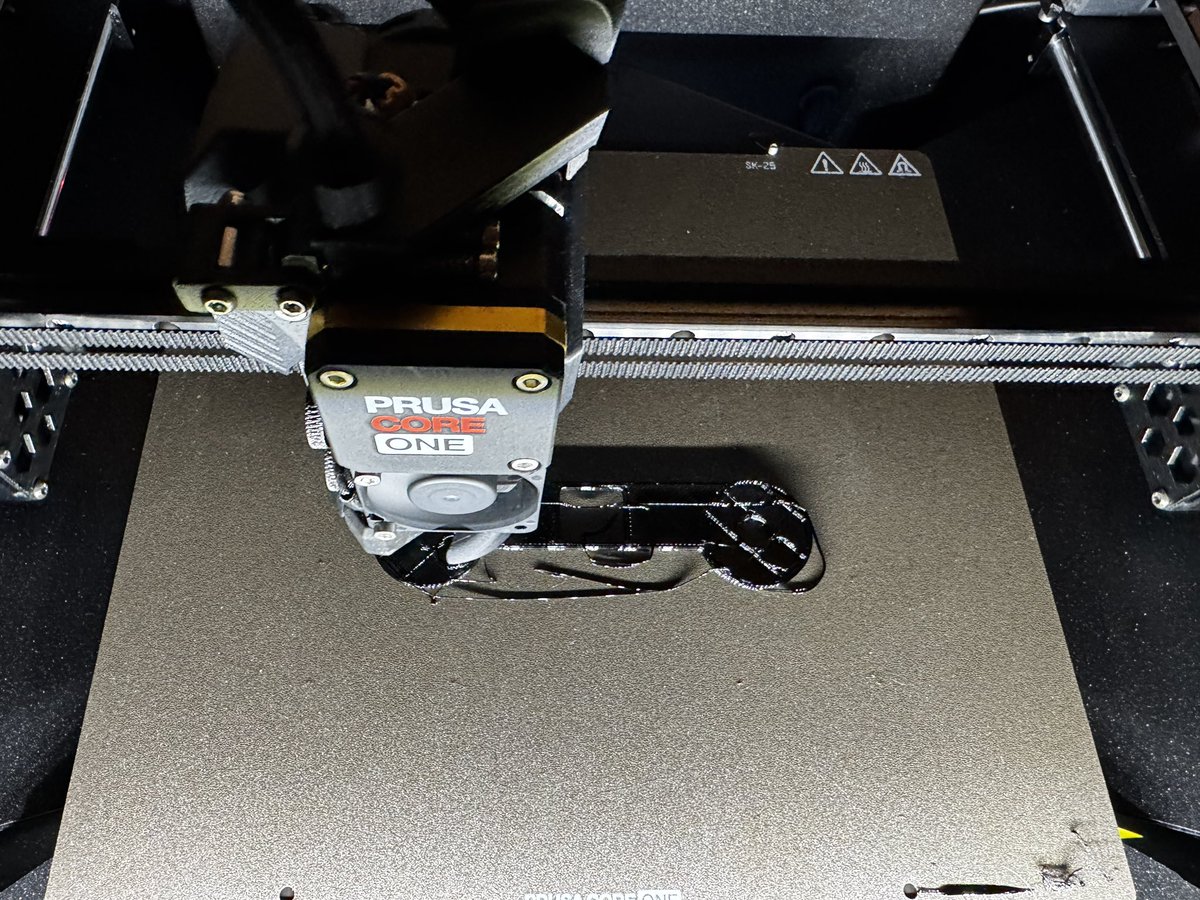

I am experiencing the same issue, with a printables model for a 10" rack. after the 2nd layer is finished it skips. I have tried this print twice, and before spending more time on it searched and found this topic.
double-5u_0.4n_0.2mm_PETG_COREONE_14h16m

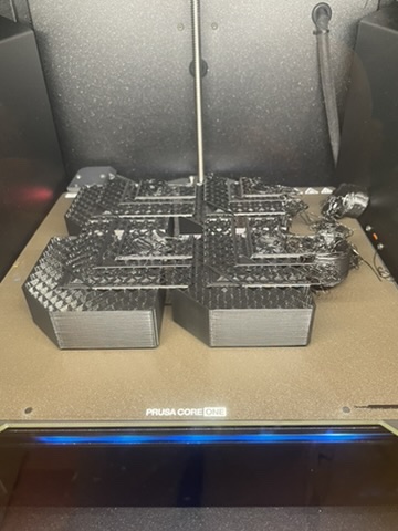

I seem to have the same, or at least similar problem. I experience a massive x/y shift at about layer 200 (not consistent though, PETG, 0.2mm balanced, also PLA 0.2 fast settings).. I recalibrated.. re-tensioned belts. I always have "avoid crossing perimeters" turned off.. Test prints turn out fine. I think everythings in order and I start a bigger project and it occurs again. Any help?

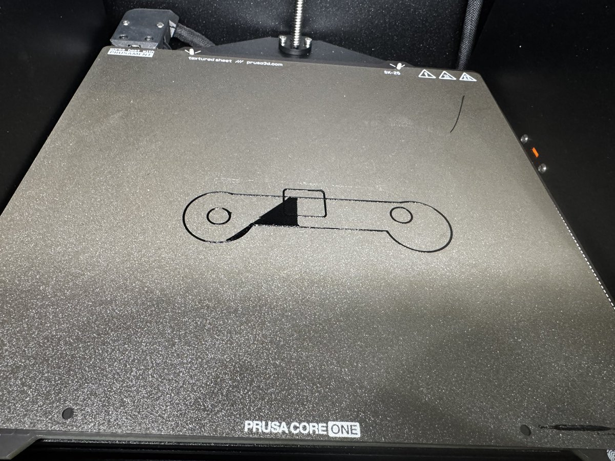

I stumbled upon this thread after I'm having the same issue... but mine is at exact same height.
I did belt tuning, in-fact.. more than 5 time in last 4 weeks to reduce VFA, also calibrated IP and phase step.. Between the first and second, I have tuned belt and between the 3d (you will see a video) I loosen belt and tuned again with prusa's built in manual belt tuning.
  • I sliced using Orca slicer
  • Did turn on the Avoid wall crossing
  • PLA 0.2mm FAST profile
  • NOT IN VASE mode, I wanted to print with small infill..
First 2 that failed From the video,, I stopped after recording video
Download the PLA > VasePlaneV5_0.4n_0.25mm_PLA_Prusa CORE One HF_1h26m
(Uploaded a video, hope it shows up! otherwise, I will upload elsewhere)
