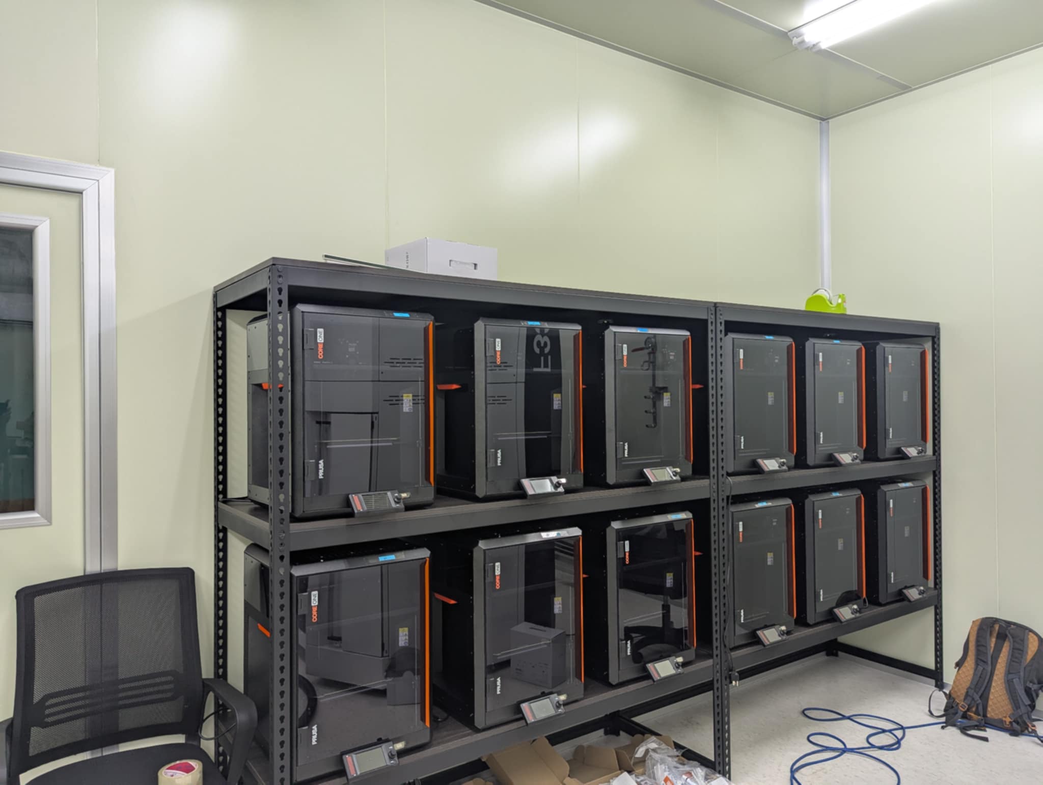

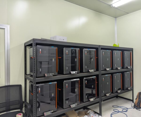

I own 14 core one and unfortunately three of them have this problem
