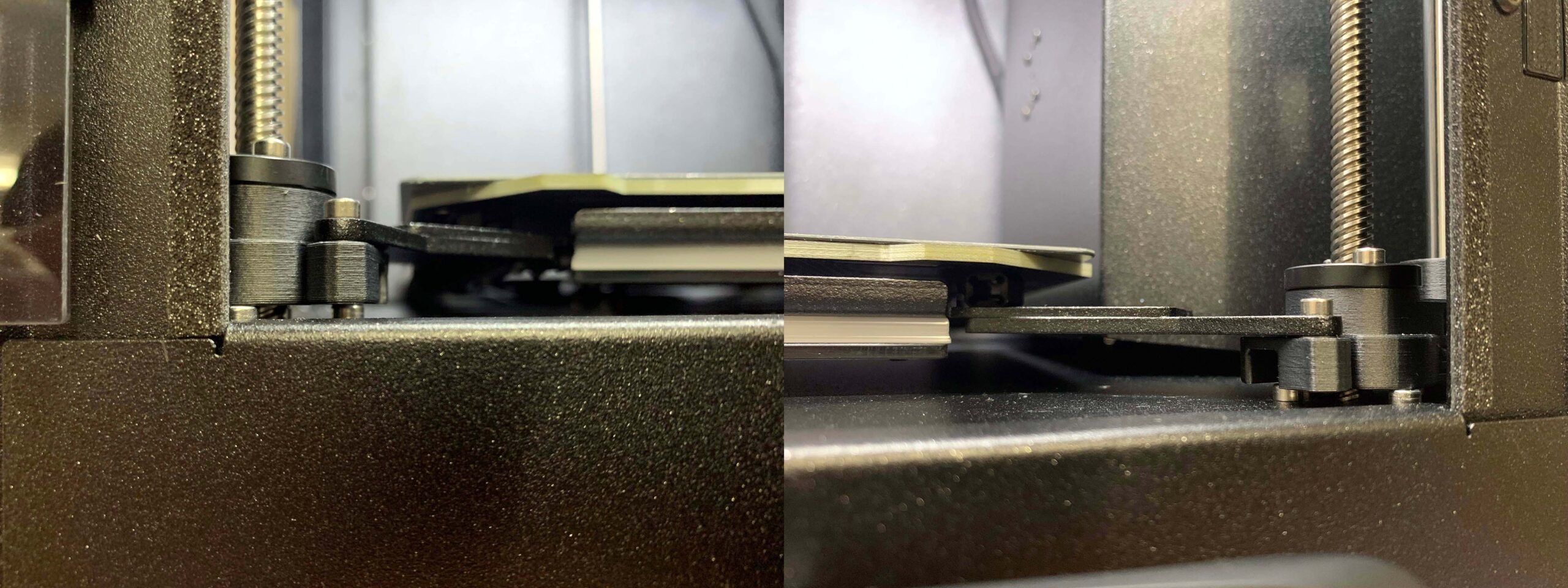

The xy plane (heatbed) in my Core One is skewed.
Reading here and on Reddit, I noticed I’m not the only one. However, none of the posts (and my hours spent on chat with support) have rendered a solution, so I’d like to document what I’ve done so far. Maybe someone here has a good idea! 😀
I assembled the printer with extra diligence and Jürgen’s (@jurgen-7) helpful steps (thanks a lot!). I kept checking all right angles along the way and double checked the exoskeleton. All perfectly fine.
Problem: The front left an front right z screws show 2mm height difference above the carriage right after Z Alignement Calibration once you move them up to z=0. The back screw sits right in the middle with 1mm difference to either side. This means the xy plane is skewed.
I can measure the same 2mm difference from the top and from the bottom.
Further, the skew is not static. Bed leveling can easily compensate at z=0, but the further down the carriage moves (the taller the print), the bigger the difference gets, eventually reaching 2mm.
During troubleshooting, support had me print an example to show that this issue does actually affect prints. Notice the height difference of roughly 1mm between the right and left side of the print. Given that I didn’t waste material to print the full height and the printbed width is smaller than the distance between the front z rods, it’s plausible that the difference would add up to the 2mm gap observed above if I would print the full height/could print the full width. (Since the left side is „higher up“, it travels down more, leading to a bigger distance and therefore a bigger print. This is why the left side of the print is taller.)
Some have proposed shims, but they’re a static „solution“ and as far as I can see just move the problem from the top (z=0) to the bottom (z=275). The print will still be skewed. The movement along the three z screws is divergent and the divergence increases during movement from 0 to 275.

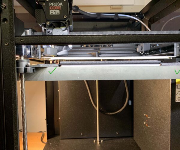

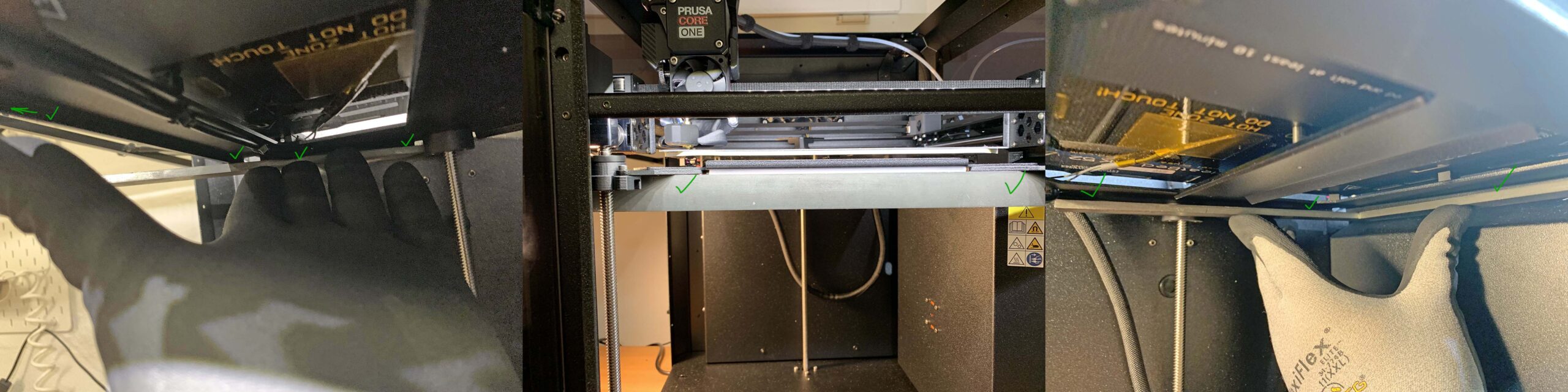

Unsuccessful: I put masking tape on all the rods and indicated the front position (6 o’clock from above) to check whether the rods rotate unevenly. I can’t really see anything apart from the z rods tilting slightly to the centre once z=275.
70mm, f11, tripod and timer

Just to be clear and summarise it:
You make it perfectly flat towards the bottom (not the end-stops) and it becomes tilted towards the top (and the other way around)?
So since the black nuts do fit on any leadscrew, the leadscrews should all have the same pitch?
That means it has to be the motors, not spinning perfectly synchronised. Although that would also mean, that it would tilt further and further, when you move the bed up and down via the controls - > axis menu.
I can't imagine the motors only spinning slower/faster in one direction.
How much noise is there, when the bed is moving? Maybe the resistance for the motors is too high?
Since they are controlled by only one connector to the board, can you access the splitter-board, that the 3 motors are connected to? I'd try to swap them around and check if the tilt pitches towards a different leadscrew (probably not).
And the last thing to test, as you say, would be to actually swap the motors around. This could either lead to the problem or solve it, if it's mechanical and you manage to reduce the tension somewhere.

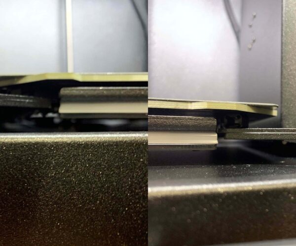

Hi, I probably have the same problem - the skew is dynamic, when bed was calibrated at bottom after z-calibration, it's not level with hotend plane at the top position. If I manually level it at the top, the skew progressively grew as the bed moved down. I went through similar troubleshooting you described, printed some test prints which showed that it translates to real world inaccuracies in vertical dimensions of the print. I verified that all motors turn synchronously, there are no missing steps.
Finally found out the cause really is incorrect pitch of one of the lead screws. It was clearly the only explanation and when I put both lead screws beside each other and tried to align the threads, you could clearly tell those do not match, when aligned at one of the ends, it gradually fall out of alignment along the screw length.
Currently waiting for new motor to definitely verify the fix.

Pavel and Jürgen, you're right! I took out the motors and compared the z lead screws.  The spindle pitch is different. That's quite something. 😲
I took a picture from a few metres away with my zoom lens (200mm, f8, tripod and timer). You can clearly see they're aligned – until they are not. And then again. And no more. Probably adding up to 2mm.
Pavel, can you keep us updated?

My numbers are the same as Jürgens, one of the "LEFT" motors moves the bed 0.5% faster/further than it should. Because the print area does not extend all the way to the lead screw, real error you would see when printing is slightly smaller, but still not acceptable in my opinion.
I will let you know if replacement motor has correct pitch and fix this when it arrives.

Holy shit. So this is definitive proof that the spindles have a different pitch. If that's true for all Core One machines then Prusa has a potentially big issue. Do you have a kit or conversion from MK4?
Have you reported this to support, including that photo?

The error for each layer is so small you don't see any major printing artefacts like gaps or poor adhesion. But it may be visible as some sort of visual gradient when printing "wall" from left to right front corner. In my tests I didn't see it, to conserve time and material I printed separate objects - 3 cylinders 20cm tall at locations near each of the lead screws as shown on photos.
Be aware that since the bed does not extent all the way to the lead screws, the values measured on the print are not the same as the values measured directly on the trapezoidal nuts.
For anybody who checks - when trying to determine which lead screw is defective, you should always compare measurements taken as close to each lead screw as possible and always compare the difference between two bed positions before and after movement - you always need two measurements for each lead screw. Simple single measurement of bed position after the Z-calibration is not enough, because there may be number of other issues causing the bed not to be level after Z-calibration.
After manual level at the top
After moving downwards a bit using move Z axes from menu
Posted : 22/06/2025 11:48 am
