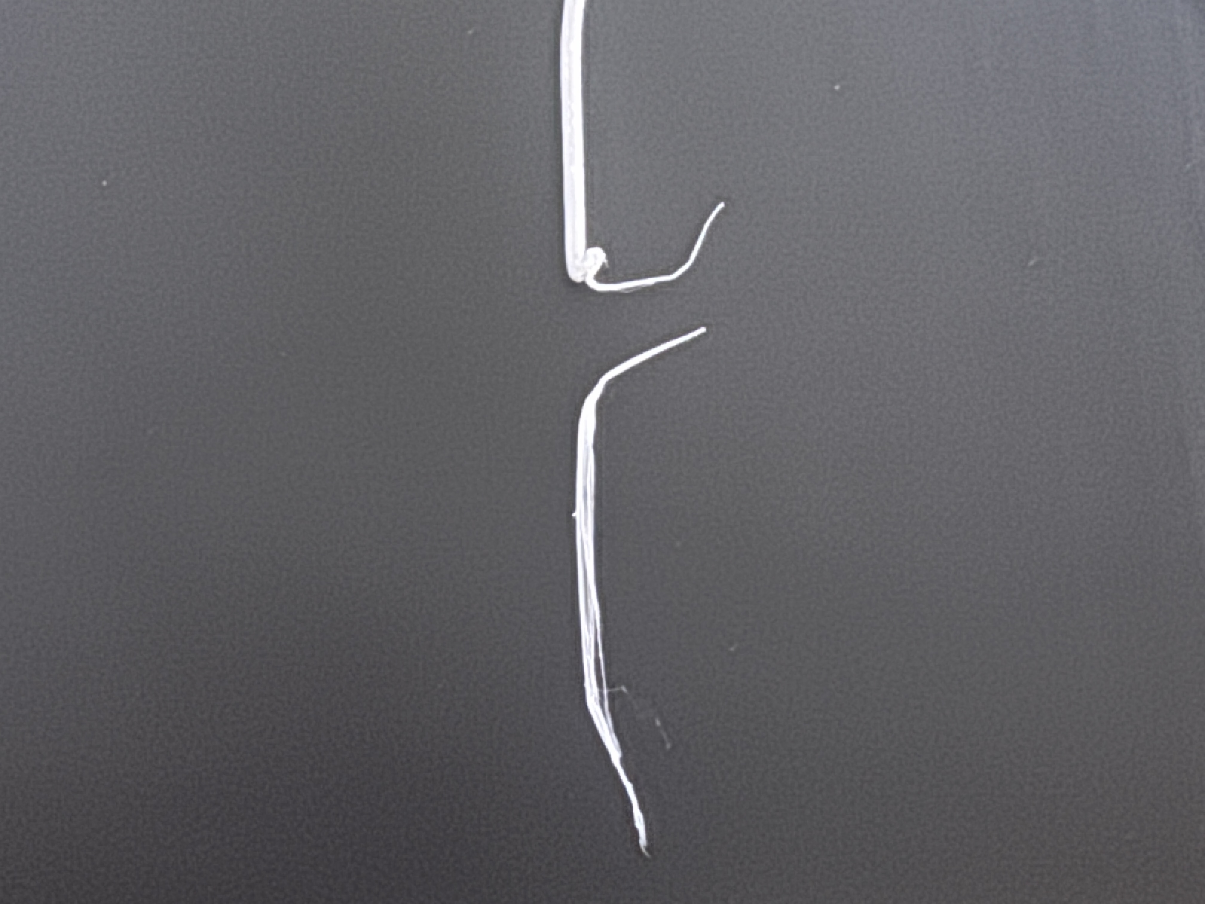

Filament gets stuck retracting during color change.  Instead of pulling the filament through the top to clear it, I cut the PTFE tube with the filament in it, disassembled the Nextruder, and pulled the filament through the bottom.  This is what it looked like.  Top was coming from the MMU3, bottom part was what was remaining in the nozzle.

Adding my +1 here as well. Biggest thing I have noticed with the Core One and MMU is mismanagement of the filament tip. On the MK3.5S, the LCD would display "ramming" , and the tip would come out with a nice cone on it. But it sounds like that doesn't happen with the core one? My printer only says "finishing buffer gcodes", clicks a few times, then pulls the filament out. The tips are jagged and not clean compared to previously.

"Ramming" settings are in Prusa slicer "Filaments": "Advanced", "Toolchange parameters with single extruder MM printers". Maybe it's disabled in the filament?
I believe I have seen it on the display occasionally so my guess is the feature exists.

Is clear that the root problem is ramming faults. The worst thing is that in the MK4 and MK4S all is ok, ramming OK, MMU3 with no faults, same nextruder. I cant understand why they have fucked up the ramming function on firmware for the CO printers. It would be the hell same of the MK4 as soon as hardware is the same.

I see those settings and even increased my ram time, but the machine still says "finishing buffered gcodes". My tips aren't stringy thankfully, they are blunt. Its working right now, but I think there is a lot of room for improvement with tip management and the wipe tower. New problem with the wipe tower is excessive blobbing and some clicking while unloading at it.
