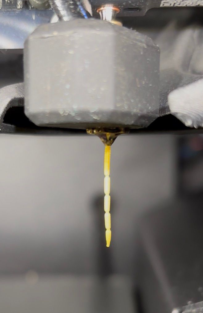

RE: Core One MMU3 Filament unloading getting stuck
What it looks like when the Nextruder and the MMU3 don't pull the filament back properly MMU3 / Nextruder / Filament gets stuck
Posted : 23/11/2025 9:46 pm

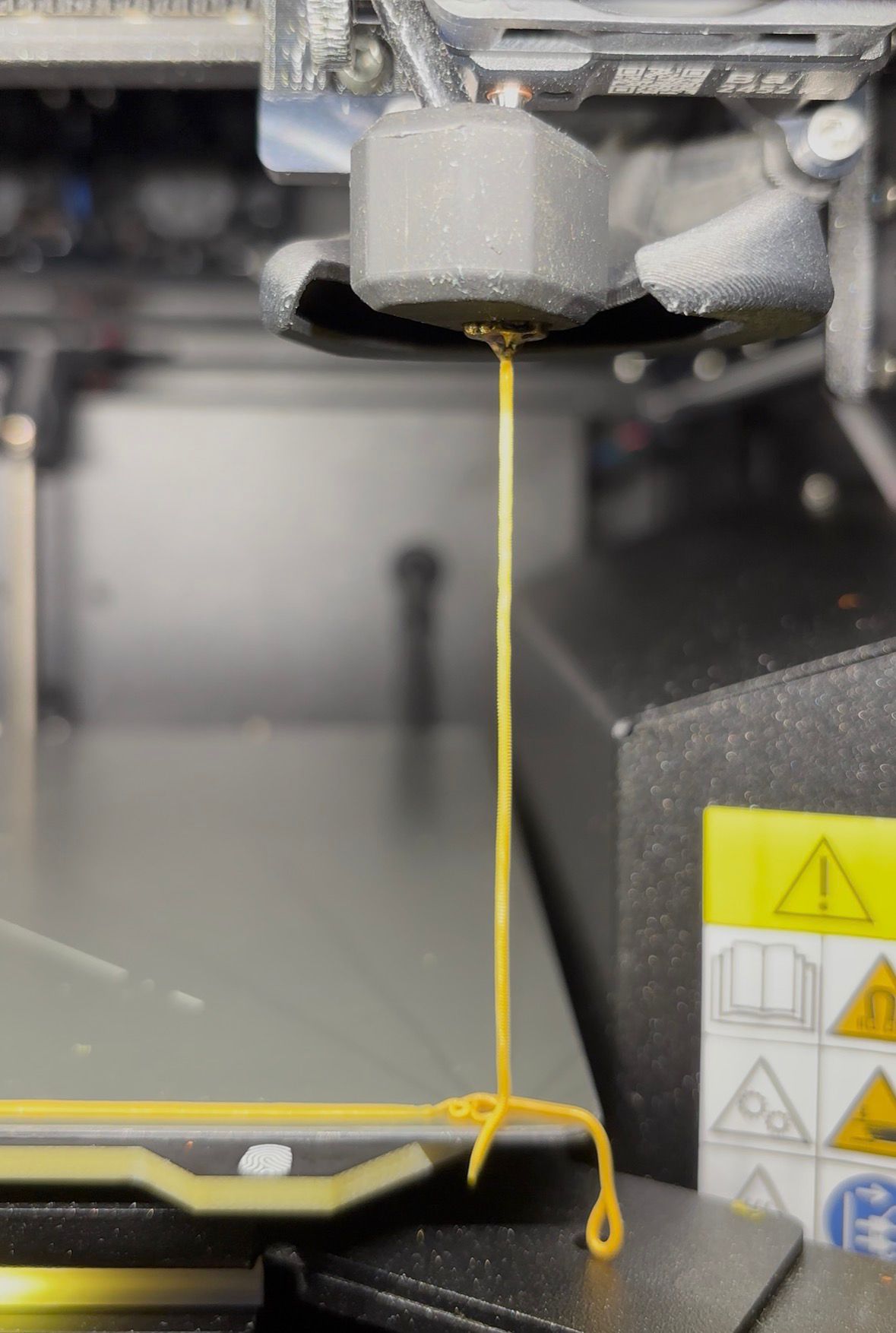

Pyro_Fox
(@pyro_fox)
Adding my +1 to this thread. MMU3 + Core One, I'm getting my filament jammed like this 100% of the time when the print ends, but oddly only maybe 20% of the time while multi-color printing. That really tells me it's the final unload procedure that's messed up...
