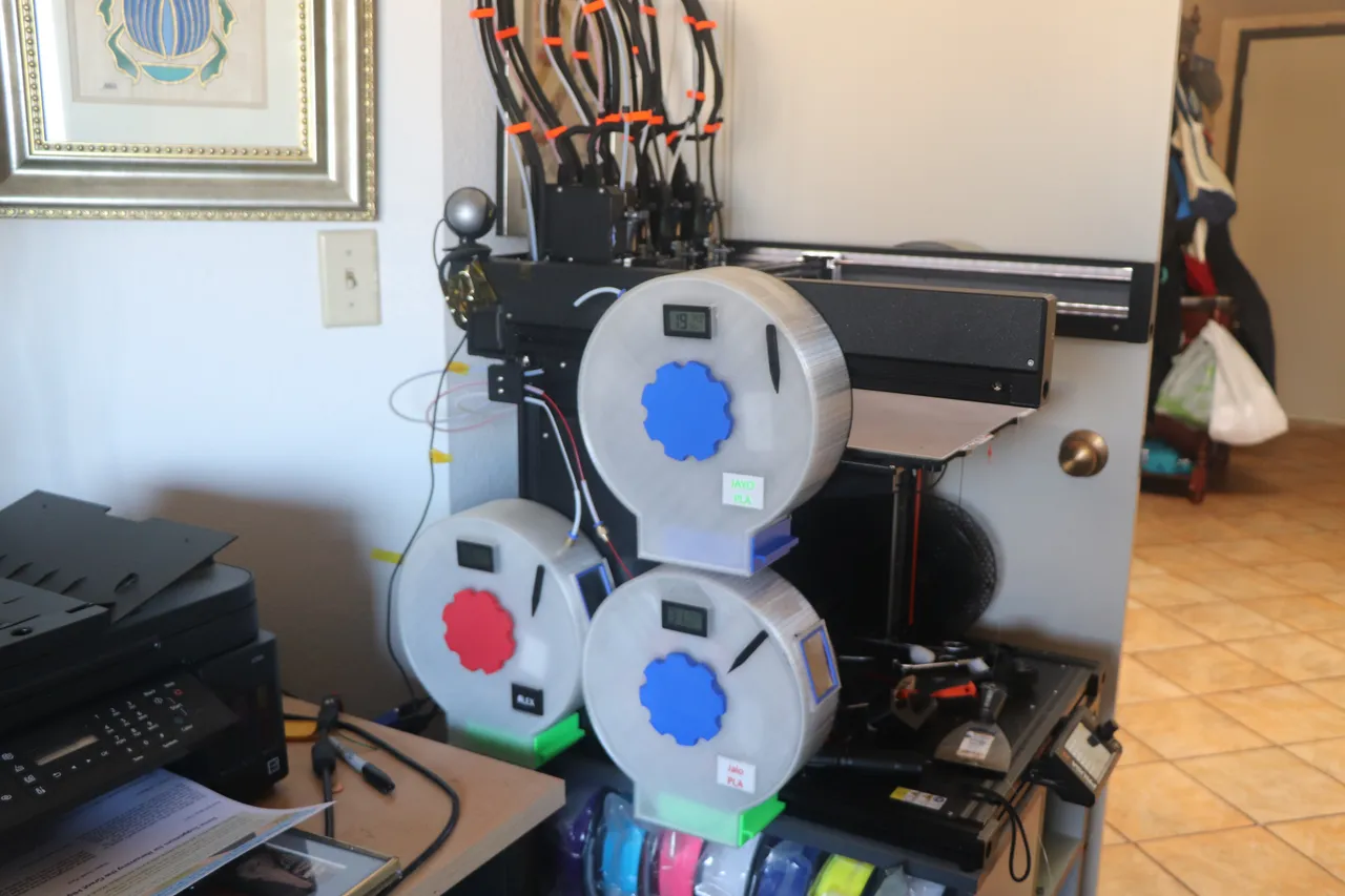

I don't want the silly axles for the spools.  I want a drybox for each spool, into which I can put dessicant, so I don't have to remove five spools at night just to put them back on in the morning.

I designed dry boxes that mount on the XL with desiccant drawers:
https://www.printables.com/model/1219198-xl-mounted-dry-box

I posted this one elsewhere in the forums, goal was to have 5 separate heated enclosures, each individually controllable and automated such that the correct dryers will turn on with the correct filament type at the start of each job on a 5XL.
The end result now is exactly what I had envisioned - I just start a job and the dryers take care of themselves, even for multi-tool and mult-material prints.  They turn a light on inside the unit so you can see which spools are in use and track how much is left etc, each material is handled according to the material temp and time needs, and the spools not in use stay dark and won't be heated up.
