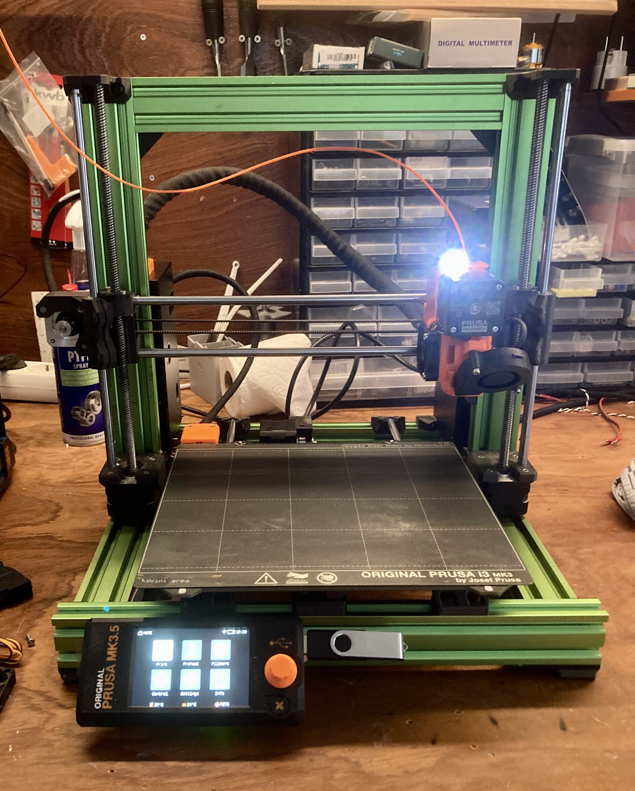

Initially, my X-axis failed.  I replace the x motor.  I got success on XY, but my Z axis failed.  That is probably due to the Bondtech.   I went past it and texted my heat bed and hotend heater.  The bed is fine; Hotend failed.  I replaced my thermistor and hot end heater.  It still fails and will not heat part 250 and failed.
I am going to just go ahead and upgrade to MK4.
Chuck H
3D Printer Review Blog
Posted : 17/03/2024 8:29 pm
EvoDesigns
(@evodesigns)
RE: MK3.5 Bondtech Extruder & Mosquito
Posted by: @cwbullet
Z Axis can be fixed by the method I mentioned. See where the Z Axis limits out and set that under the superuser settings.
Even if the hotend doesn't pass you can still print.
I got 2 different heaters that I will be testing to see if they pass. Besides that, I believe Prusa is working on aftermarket hotends issues for the revo. It may work for this one.
I probably wouldn't upgrade to the mk4 just yet.
Posted : 17/03/2024 8:33 pm

(@evodesigns)
All test passed, heater passed with a Bondtech 24V 50W heater + sock.
https://imgur.com/a/LfZ83z2
Posted : 23/03/2024 4:50 am

Hey all,
It seems that the Bondtech Extruder + Mosquito setup is a success. Here is what I did and some of the issues that I faced.
  1. Extruder Heater
    • I still haven't been able to pass this calibration test but I am in the process of getting a new thermistor (tomorrow) + a dowel pin to fit inside of the Mosquito. Adding the dowel pin may help with heat dissipation since there is no longer empty space in the thermistor cartridge bore. See image.
    • I purchased this Bondtech Heater w/ a ferrule connector and I was able to pass the heater test with the sock option on. You can also get it from Slice Engineering.
  2. Loading & Unloading Filament (e-steps)
    • Changing the e-steps to 800 815 seemed to have a proper load and unload sequence, and this got everything printing nicely.
  3. Linear Advanced Settings
    • I was having underextrusion issues around the corners of the print. At first I thought because I was printing too fast but lowering the speeds did not help. In the custom g-code for the filament, I changed the default value of .05 to .04 and that made a world of a difference. See the underlined boldened value. *this may only be an issue for the Atomic Filament I use, so I'd advise to test out a print before changing it.
{if printer_notes!~/.*(MK3.5|MINIIS).*/}M900 K{if printer_notes=~/.*PRINTER_MODEL_MINI.*/ and nozzle_diameter[0]==0.6}0.12{elsif printer_notes=~/.*PRINTER_MODEL_MINI.*/ and nozzle_diameter[0]==0.8}0.06{elsif printer_notes=~/.*PRINTER_MODEL_MINI.*/}0.2{elsif nozzle_diameter[0]==0.8}0.01{elsif nozzle_diameter[0]==0.6}0.04{else}0.04{endif} ; Filament gcode LA 1.5{if printer_notes=~/.*PRINTER_MODEL_MINI.*/};{elsif printer_notes=~/.*PRINTER_HAS_BOWDEN.*/}M900 K200{elsif nozzle_diameter[0]==0.6}M900 K18{elsif nozzle_diameter[0]==0.8};{else}M900 K30{endif} ; Filament gcode LA 1.0{endif}
{if printer_notes=~/.*MINIIS.*/}M572 S{if nozzle_diameter[0]==0.6}0.17{elsif nozzle_diameter[0]==0.8}0.12{elsif nozzle_diameter[0]==0.4}0.27{elsif nozzle_diameter[0]==0.25}0.85{else}0{endif}{endif}
{if printer_notes=~/.*MK3.5.*/}M572 S{if nozzle_diameter[0]==0.4}0.035{elsif nozzle_diameter[0]==0.5}0.025{elsif nozzle_diameter[0]==0.6}0.02{elsif nozzle_diameter[0]==0.8}0.014{elsif nozzle_diameter[0]==0.25}0.12{elsif nozzle_diameter[0]==0.3}0.08{else}0{endif} ; Filament gcode{endif}
After printing many cubes to test which settings are the best that's what I concluded with up top, I did not have any issues with heating during any of the prints. I don't think there is a need for custom firmware. But I would love to see Prusa have 3rd party approved firmware without having to void warranty on the board.
For those wondering if you should update to the 3.5, do it. I haven't had any issues and its nice having all my printers on Prusa Connect.
