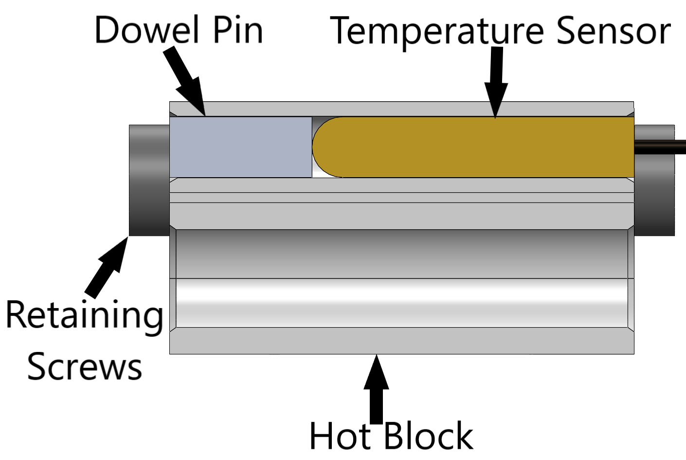

EvoDesigns
(@evodesigns)
@chrisg
I'm back home and I can finally type it all out, here is what failed and what I did to fix it.
  1. Z-Axis Length
    • When I built the MK3.5 kit, I accidently installed the z-axis trapezoidal nuts upside down because I was swapping all PETG parts to PCCF. This led to the Z-Axis Length calibration to fail. Since it failed, I changed the Z-Axis length to 208mm to pass the test from the Advanced User settings.
    • After reinstalling the trap nuts correctly and resetting the Z-Axis length to 211mm in the Advanced User settings, the Z-Axis calibration passed the test.
  2. Extruder Heater
    • I still haven't been able to pass this calibration test but I am in the process of getting a new thermistor (tomorrow) + a dowel pin to fit inside of the Mosquito. Adding the dowel pin may help with heat dissipation since there is no longer empty space in the thermistor cartridge bore. See image.
  3. Bed Heater
    • I botched the install of this, the aluminum tape isn't fully covering the thermistor. Getting a new one tomorrow.
  4. Loading & Unloading Filament
    • Changing the e-steps to 800 seemed to have a proper load and unload sequence.
Here's an XYZ cube with 800mm e-steps, I will calibrate it more when I have the time but nothing went wrong with the extruder heater/thermistor during this print.
Posted : 11/03/2024 3:48 am
