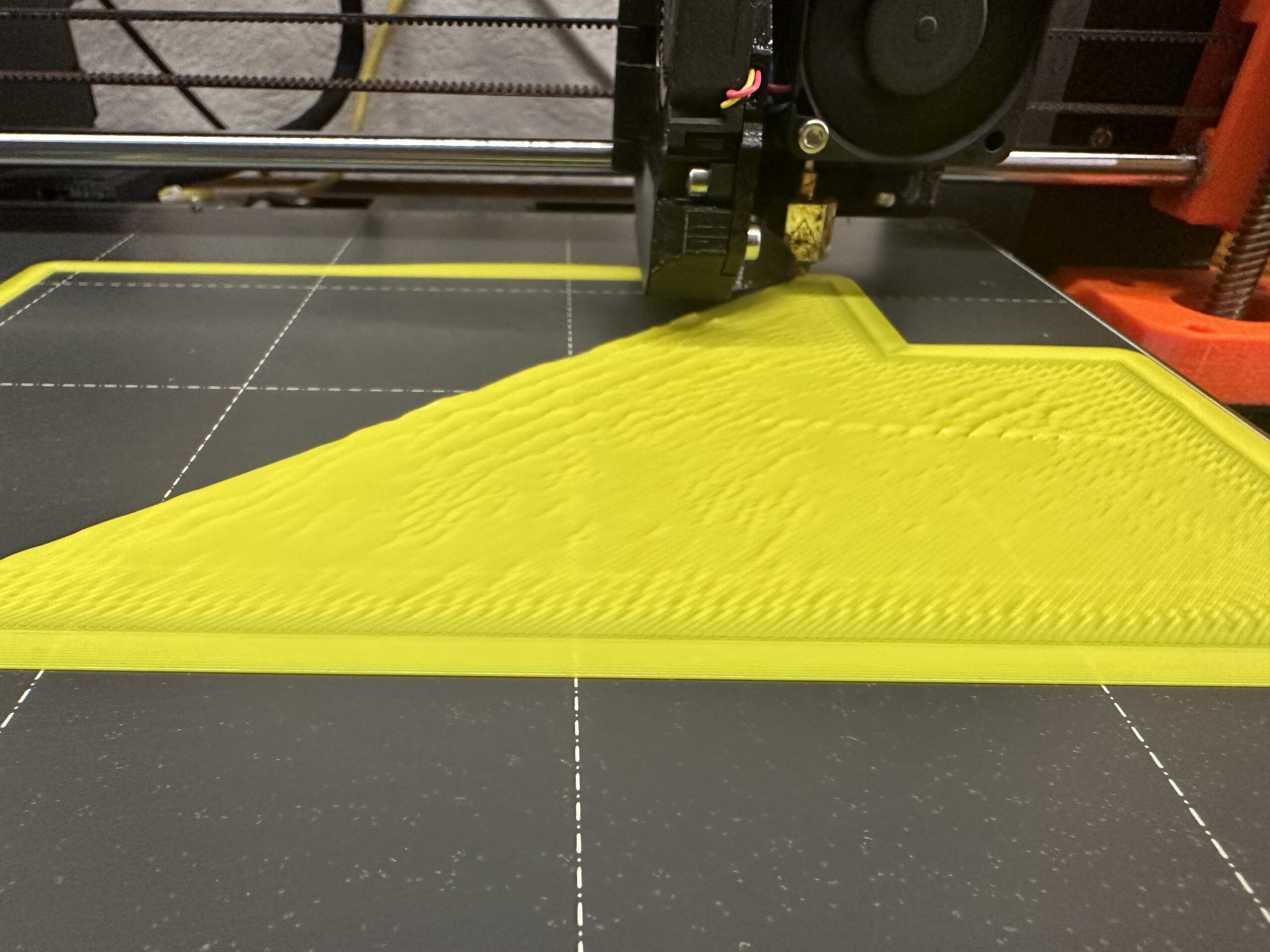

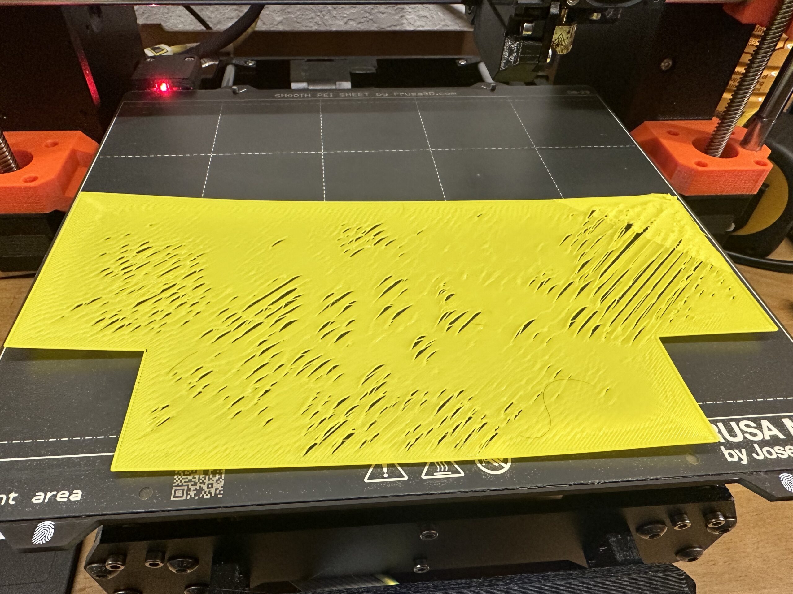

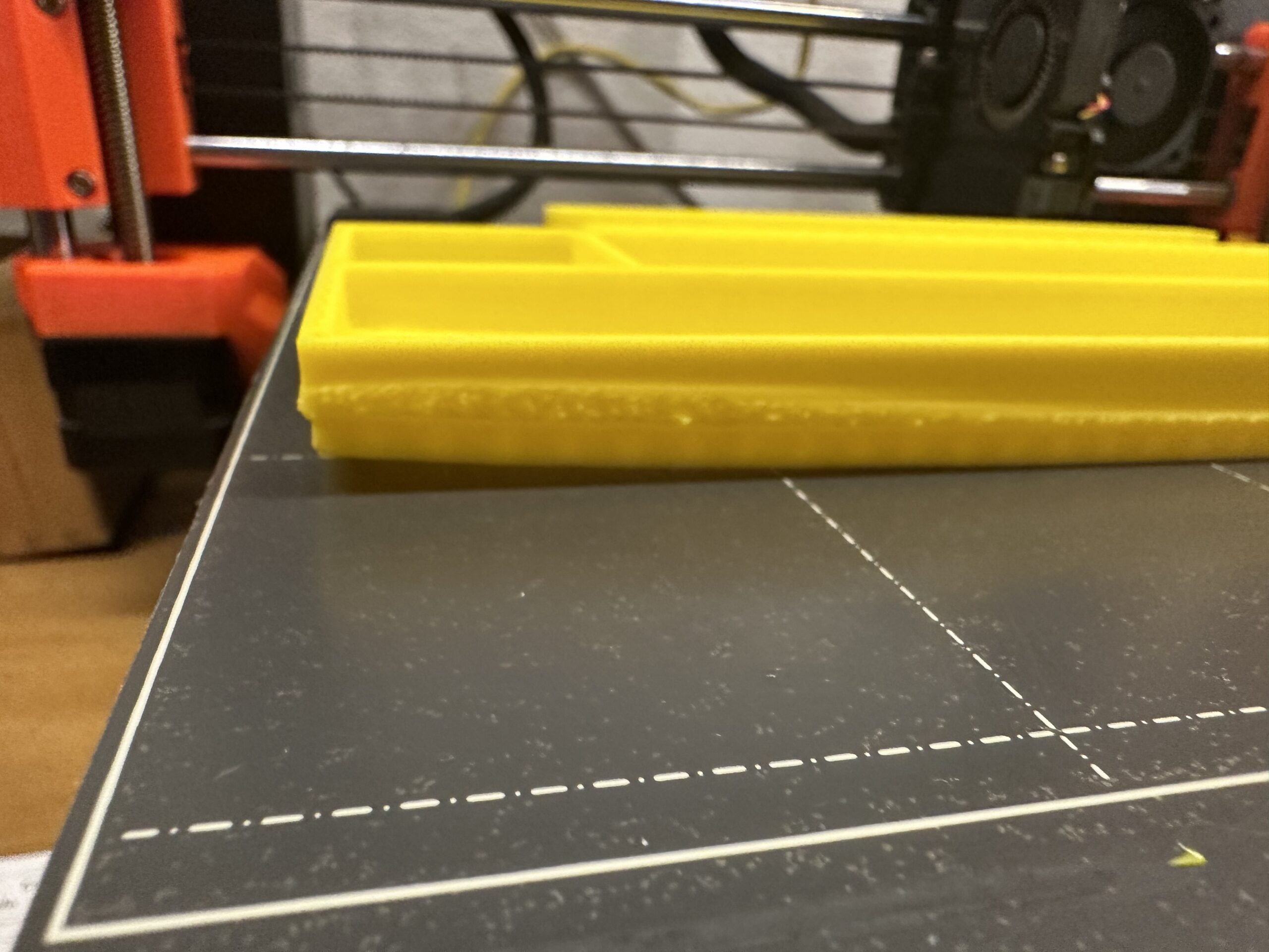

Although this is the first issue I’ve had with MK4, I am super-torqued the Pineapple Yellow Prusament is giving me such a hard time. After adjust the bed temp and getting slightly better adhesion, I walked away from the print for a couple hours and came back the to wrinkly and de-stabilized mess in the photos.

OK, let's assume then that I slowed the first layer down to something below 40 mm/s. Let's assume I return the first layer thickness to .2 mm. Why, then, does the top layer on the last photo have so much wave/wrinkle? That's not a digital artifact from the surface lighting. That's how the layer on top of 50-ish layers. It seems to me the lack of a flat surface is a result of the temperature of the filament exiting the extruder. Is 215º the wrong temp for Pineapple Yellow in large flat surfaces? As stated before, this doesn't happen with higher poly count prints. Nor does the rippling of large sheets happen with any other color that I've cared to try (in fact, gave up on the Pineapple Yellow and printed in Hatchbox basic black with no issues.)

The bad first layer can impact also a few layers above. That is one possibility, the other is that there is overextrusion or the temperature isn't optimal.
I would address the first layer issue first though and then look if the others issue persist or if they disappeared with the first layer issues.
Your third picture clearly shows warping. This is probably associated with poor adhesion so getting the first layer right should address it. Because the part is warped the upper layers are printed on the inside of a curve, no longer truly flat, and are fractionally shorter than planned and sliced. You are now trying to fit the upper layer filament into a smaller space, it no longer fits and so wrinkles.

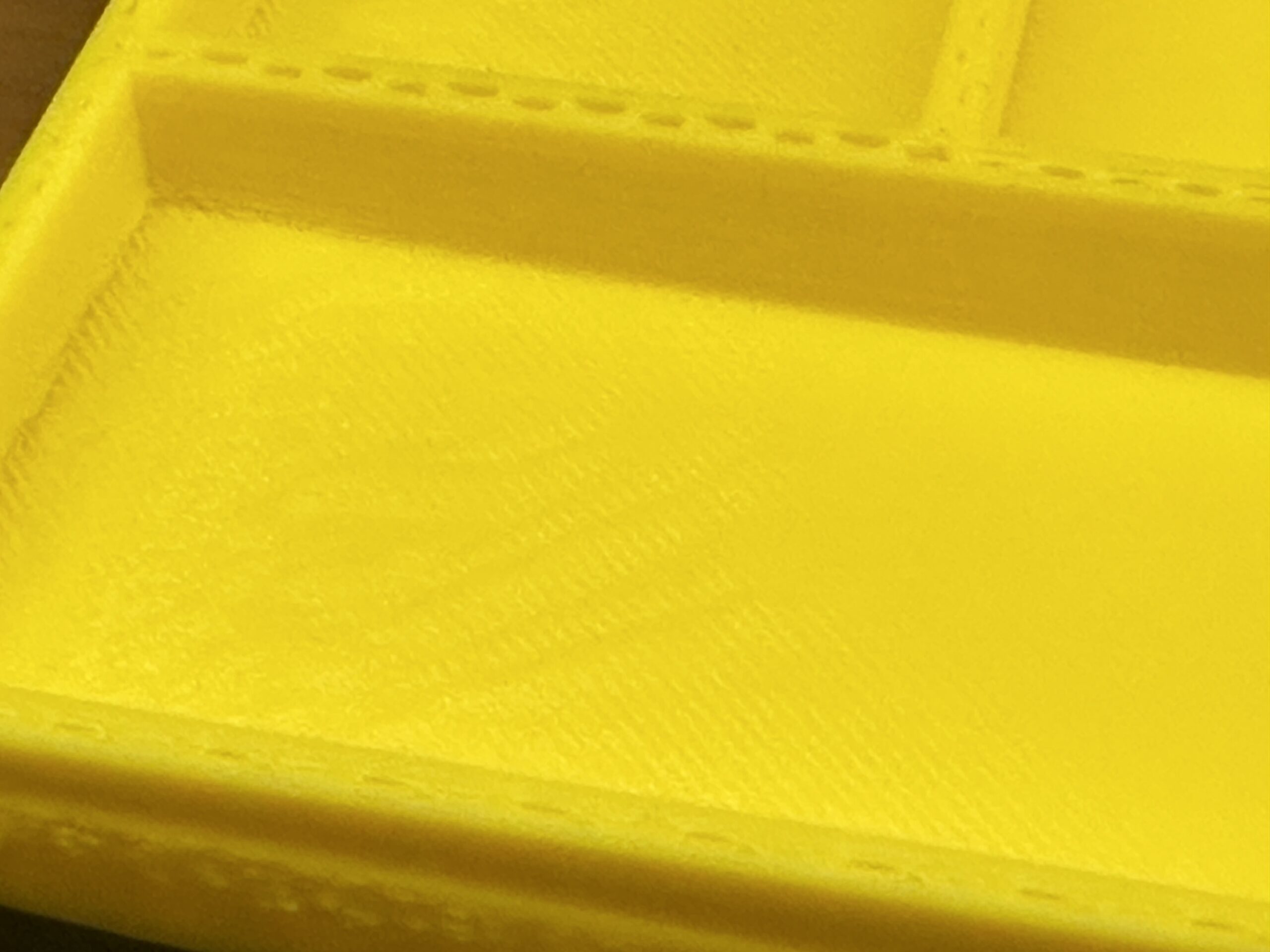

@diem and @thejiral, something you both said prompted me to check on something… checking the extrusion temperature.
Guess what happened when I raised the extruder temp to 230° (which is what the preset is for Prusament PLA in PrusaSlicer? You can see the change in one of the attached photos.
yeah. Both on the smooth and on the powder-coated beds. Nice and smooth. In a way, I’m glad I made the mistake. I’m still annoyed, but more at myself.
I DID learn, however, that one of the things to check on a wrinkly surface is to up the extruder temp by 5°!!
