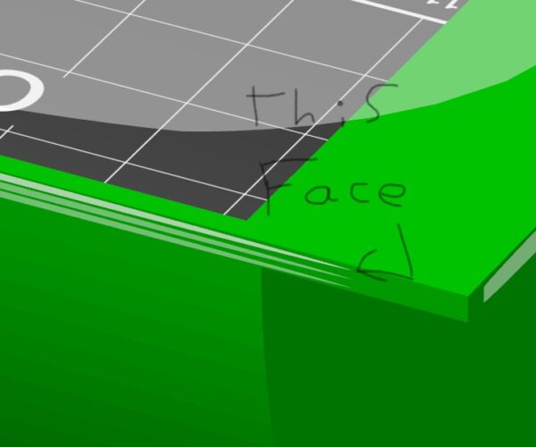

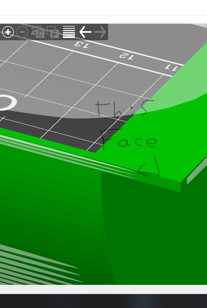

Haven't been able to get supports under bridging areas. I have tried adding a raft and skirt to the print but still cant get it some places.
Here is some screen shots of  my issue and my printer settings. I have had the same problem with some other prints as well. I think the problem lays in the the proximity to the print plate/raft and the software's support placement resolution. Does any one know how to fix or get around this problem.

this is the face that I have my model orientation set on
