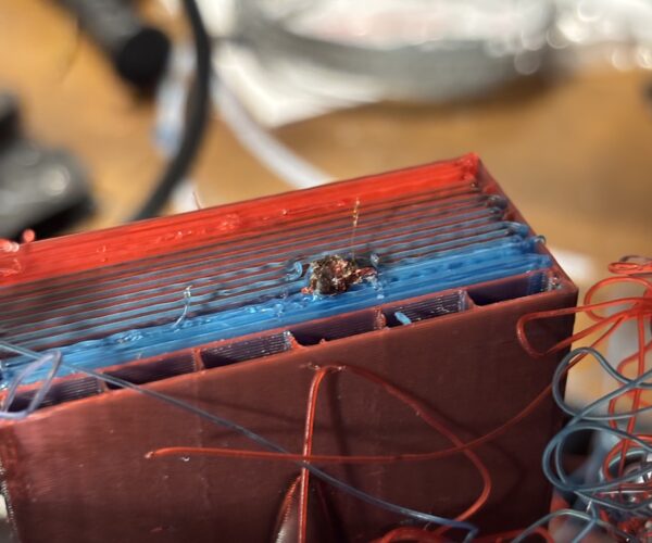

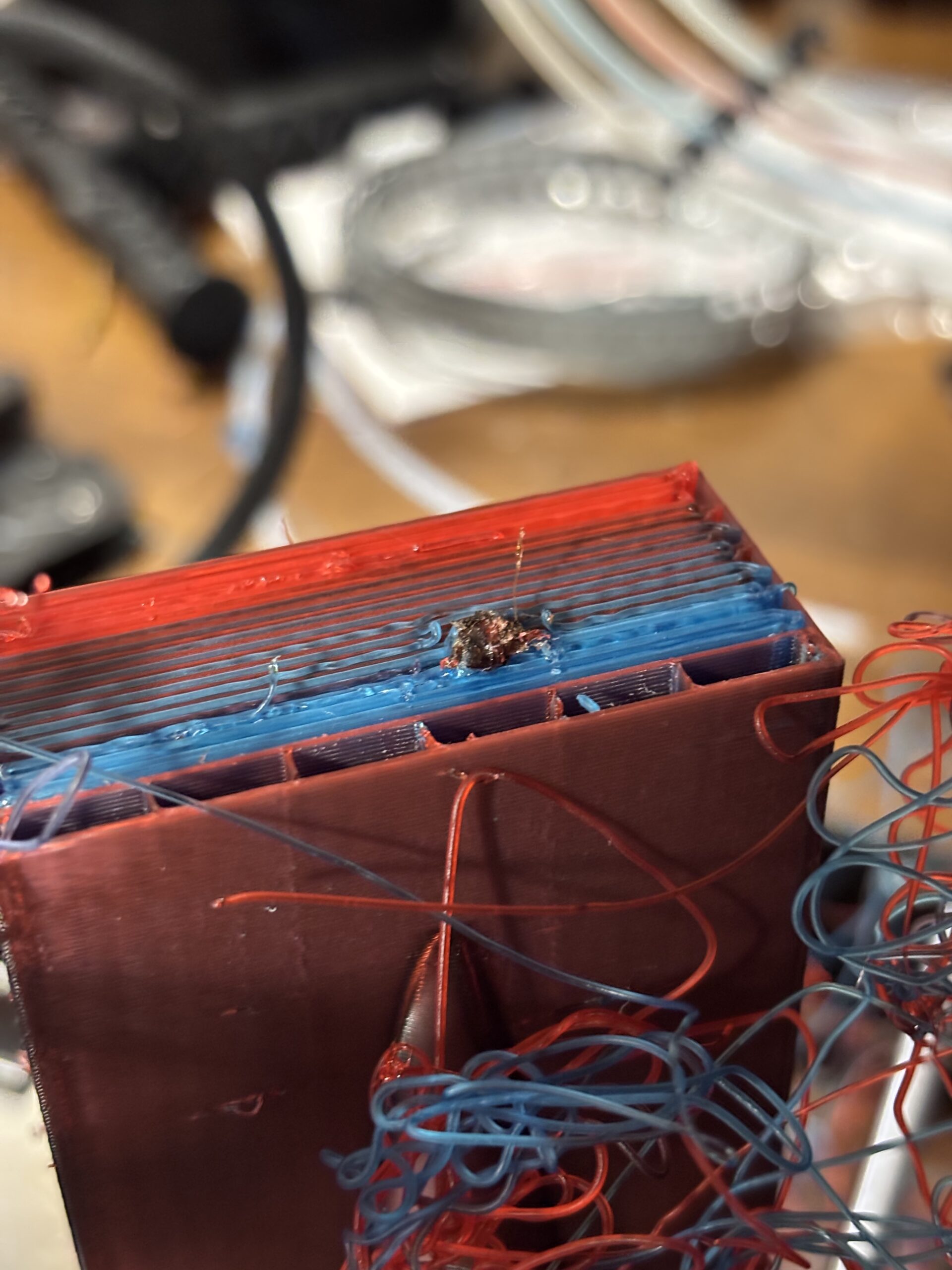

This is a noble effort and you did a lot of work to find a good solution.
My situation occurs when everything is normal and the filament misfeeds or has some other issue during change. While the printer is waiting for me to realize that I need to fix it and waiting for me to fix it, filament oozes out onto the tower. Now, an otherwise well formed tower has a glob on it which causes a collision and destroys the print.
My thought is that the nozzle should always park elsewhere during filament swap.

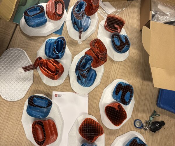

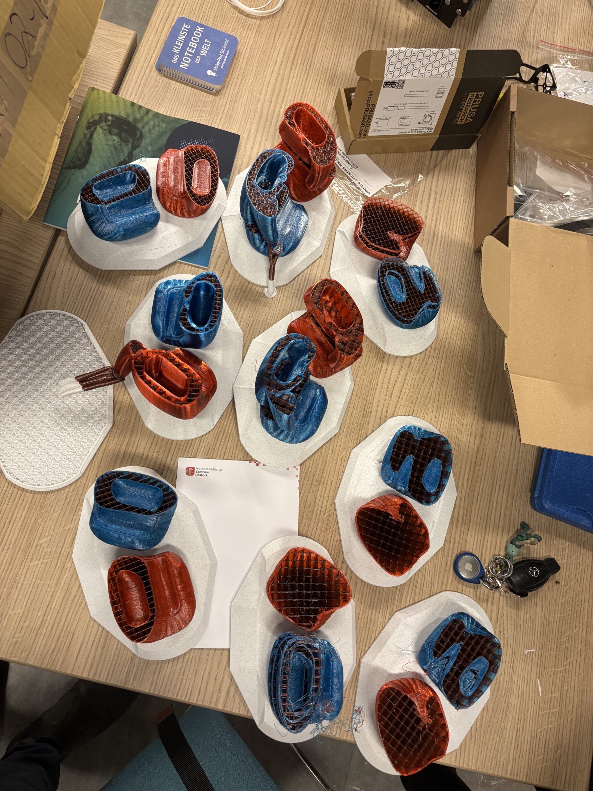

Hi, having the same issue for some weeks now. The blobs are running me crazy. I had a chat with Prusa support 2 times. The first one was great. I set down purge extra flow from 250% to 150% and disabled purigng in infill. This makes a mess of much more waste but I was able to atleast finish a print. Sadly after the second print my problems were back...
Since I want to use purging in infill, I tried a print with 150% purge extra flow and 10 degree cooler filament settings. But this ended pretty early to.
I'll check the setting that were mentioned here, but I don't think that will make a distance. On 2 colour prints there is no problem even with 48h print time. But this model makes me crazy. I never had these problems with MMU2S+...
