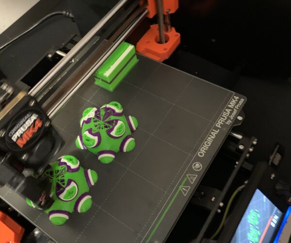

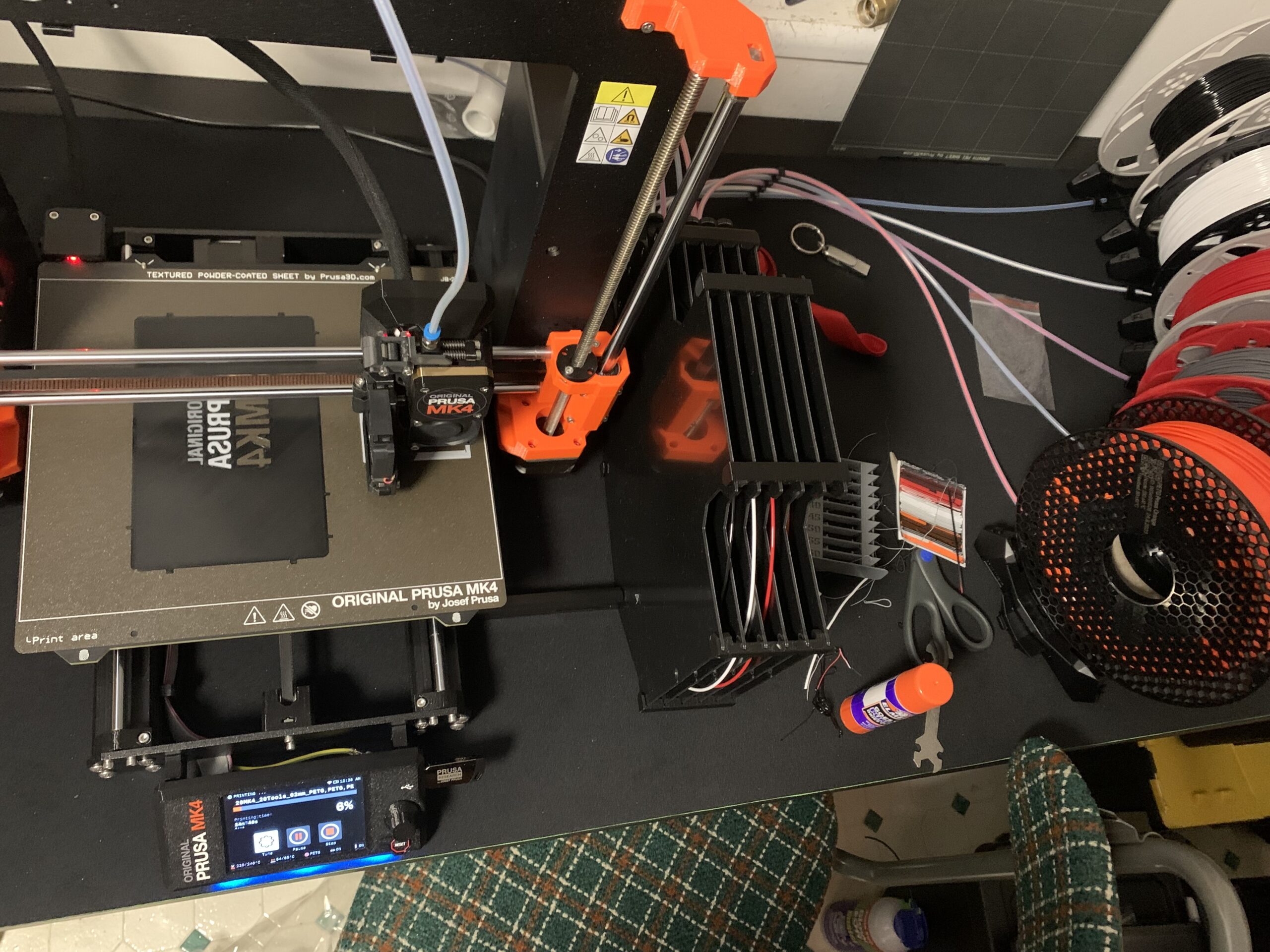

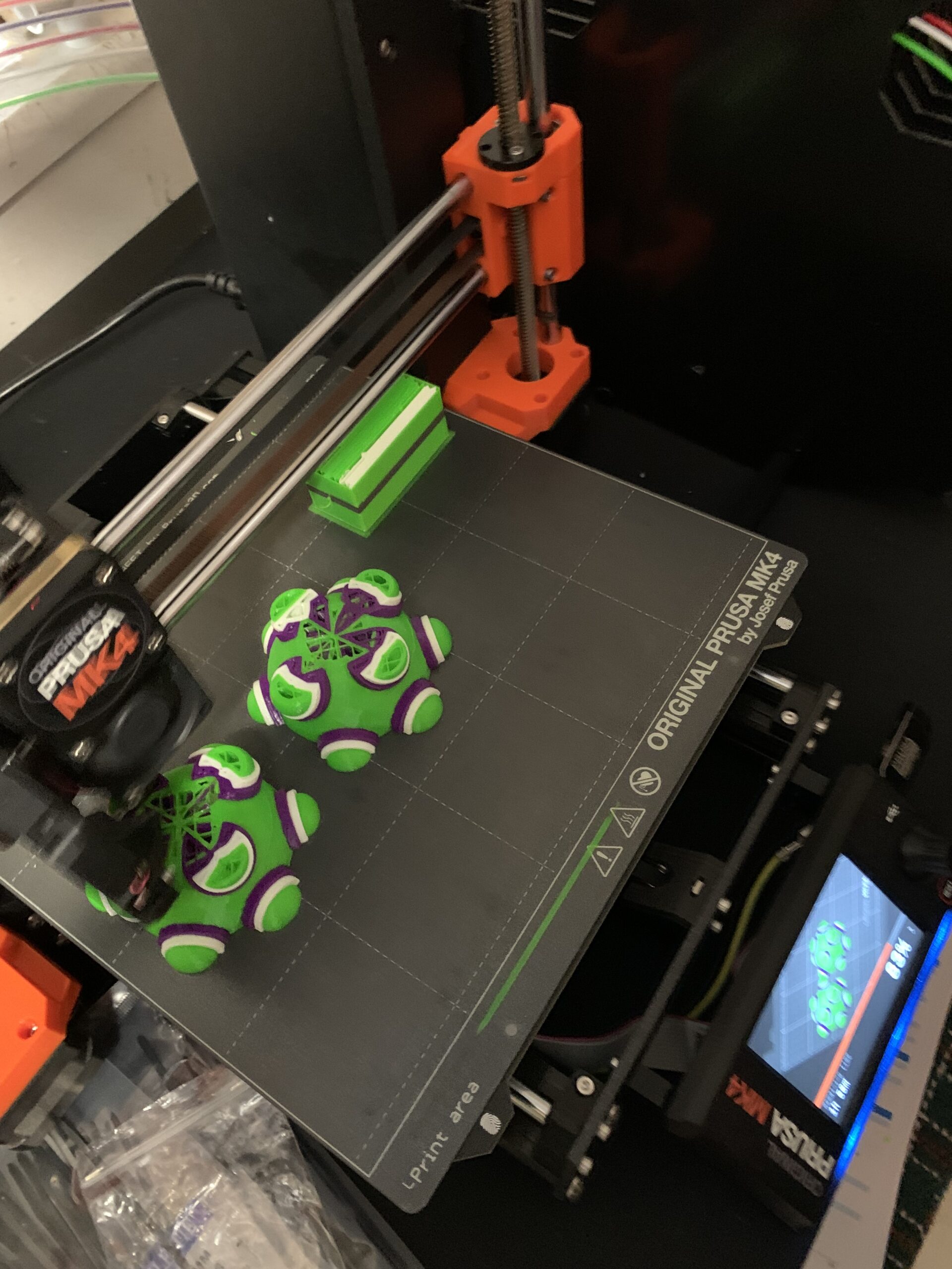

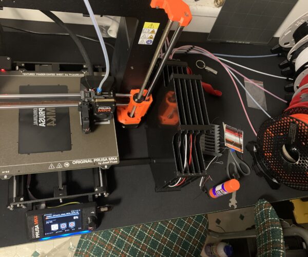

All original prusa here. Just got the mmu3 in the mail about an week ago. Have had the mk4 for about a year. Attached pictures to show full setup.
My best guess to the cause of the issue is specific to when a filament change occurs on the wipe tower by purging to create the conic tip with the filament end. And that method is impressive that it does not have a stringing end. However, that ordeal does seem to be fixed and separate from any adjustable setting with the slicer or on the panel itself.
Essentially it makes a wide/rapid wipe, and does not always anchor where it is supposed to go creating a bugger. The bugger gets wiped off usually, but it of course hardens and it is just a matter of a pass or two before it becomes a collision with the nozzle itself. And these collisions are not minor. Impact hard enough to flex the heat bed and sometimes shift the sheet itself.

And yes, fully up to date on firmware and software/slicer. Last updated yesterday before starting the green/purple/white halved ball print that is pictured.
A careful eye can see the beginning of a filament bugger on the wipe tower and shift in the print itself from a past collision and noticeable that I manually corrected it after a few layer passes. These issues stem from the tower’s bugger blobs.
