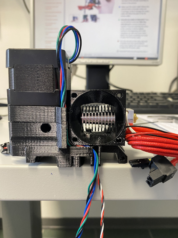

everything went well and smoothly up to step 14. Unfortunately the step 14 it contains an error:
* Insert two M3x40 screws, you've prepared earlier. Tighten them, but be careful, they are slightly longer (2-3 mm), than the thickness of the entire assembly
And this is the expected result, with 2.3 mm exceeding screws:

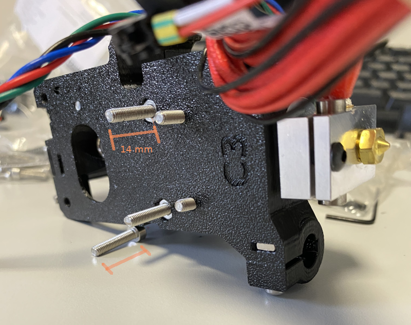

Unfortunately m3x40 screws are too long for this part, as screws exceed by 14 mm over the bottom place:
Below the part, there is a m3x14 screw as example:
which matches exactly the exceeding length.
With this, I cannot assemble the X-carriage as shown in the step 19.
How can fix this?
Thank you for your help.
Max

Did you install the extruder cover in step 14? That would explain the screws sticking out that much.

Yes, sure!
And as you can see from the picture, both supposed "M3x40" screws remain raised only by a few millimetres (2-3 at most, see orange arrows) with respect to the hot hand assembly component , when placed to the box.
I guess that this is not possible, unless a big misunderstanding.

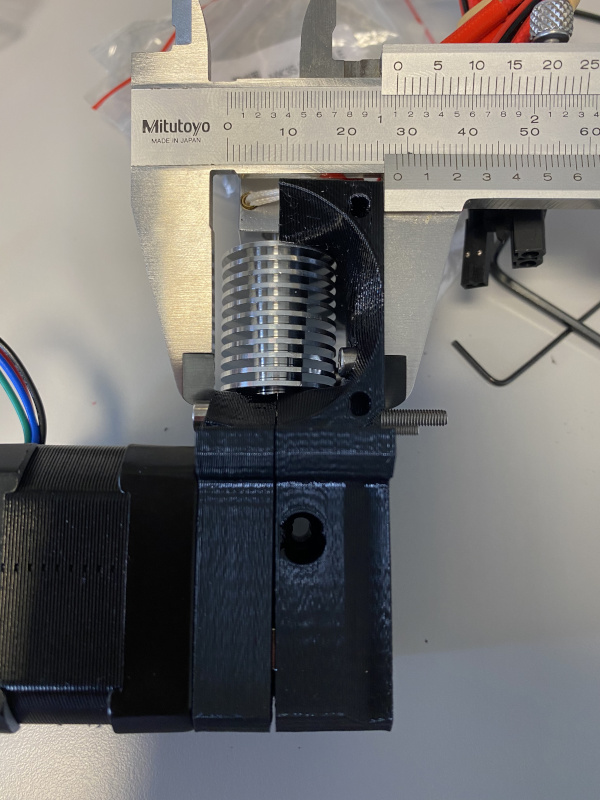

The hothand assembly height is about 28 mm:
while the total length if a M3x40 screw is more than 40 mm:
That's why the screws protrude by 14 mm, much more than the expected 2 mm.
Unfortunately there are no M3x25 screws in the box, which probably fit better.

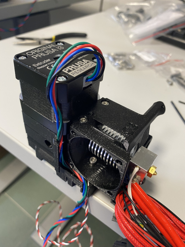

Ah!!!! That's clear now: there is an important MISSING step in the Part 14 of this tutorial.
THE DESCRIPTION OF WHEN AND HOWTO PLACE THE Extruder-cover  IS MISSING COMPLETELY.
This tutorial chapter must be fixed as soon as possible, specially for new users.
Now is perfect:

These steps are in the manual.
I checked my printed manual and the online manual and both have this step in it.
In step 11 you prepared the cover and in step 14 it is marked with a purple dot.
Place the Extruder-cover on the Extruder-body. Again, make sure that all three parts are properly aligned.
And on the 3rd picture it is marked with a purple arrow (not very clear in the printed manual)
Read all instructions carefully and happy printing when you have it fully assembled.
