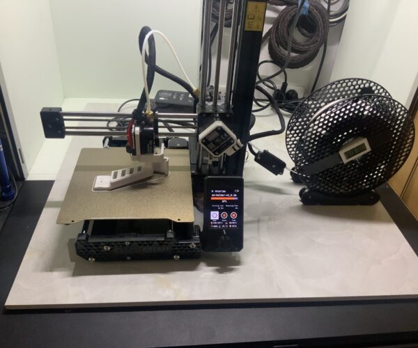

To “sound proof” my mini+, I use a 60x60cm tile slab with roughly 10mm thickness (which I happen to have). I just added five 3M plastic footing (4 corners and 1 in the center). This greatly reduced the noise coming from the motor vibration to my desk.
Tile slab
Posted : 02/06/2021 10:51 pm

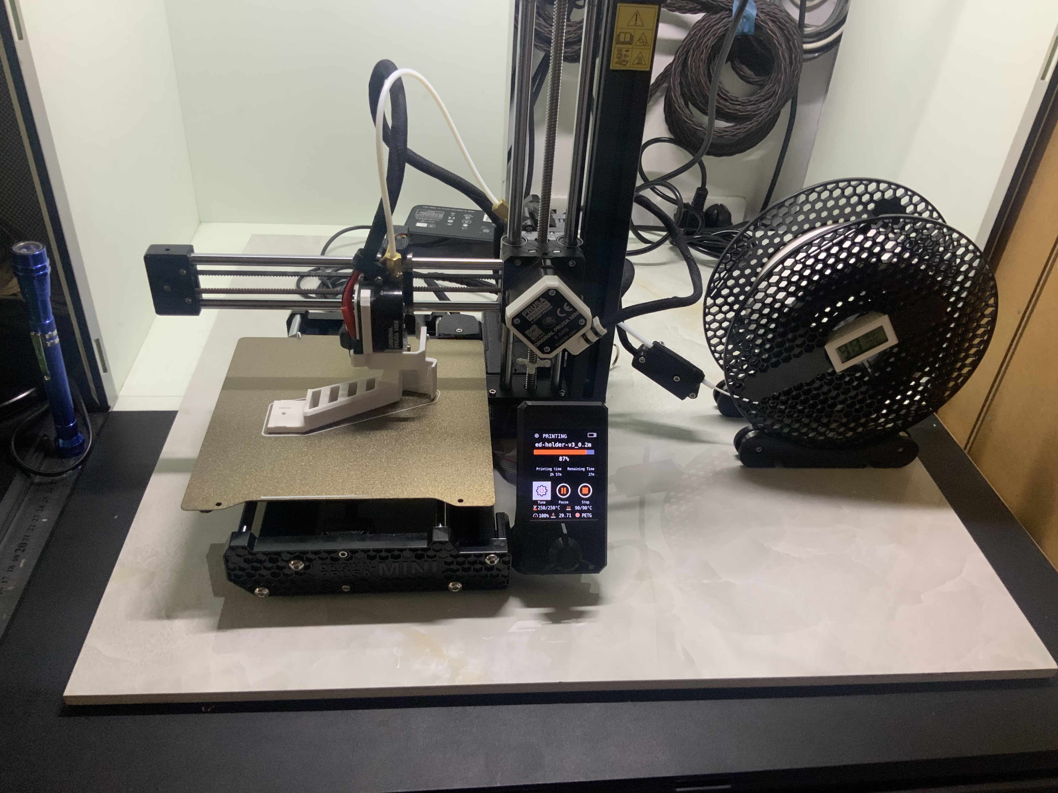

I got a granite slab as a part of failed work from the tomb stonecutter nearby, size is something about 30 x 30 x 3 cm. The benefit of this is that the top surface is super flat and smooth so the printers legs are touching it and printer is not moving on the surface when it prints.
I used a silencing foam from computer disks (those dense parts in the corners), and a noise cancelling foam used in audio studios.
I used double sided adhesive tape to attach foam to the granite block.
Foam is about 3cm in height and gets compressed under the weight to about 2cm, though notice that the print area may not bee perfectly horizontal which may be an issue for certain materials, but because I use PETG thus I have not noticed any issues.
Noise cancelling works so well that I can talk with people when working remotely and they do not hear printing sound.
Also sound does not travel to the parapet so it is no longer transporting to other construction elements.
