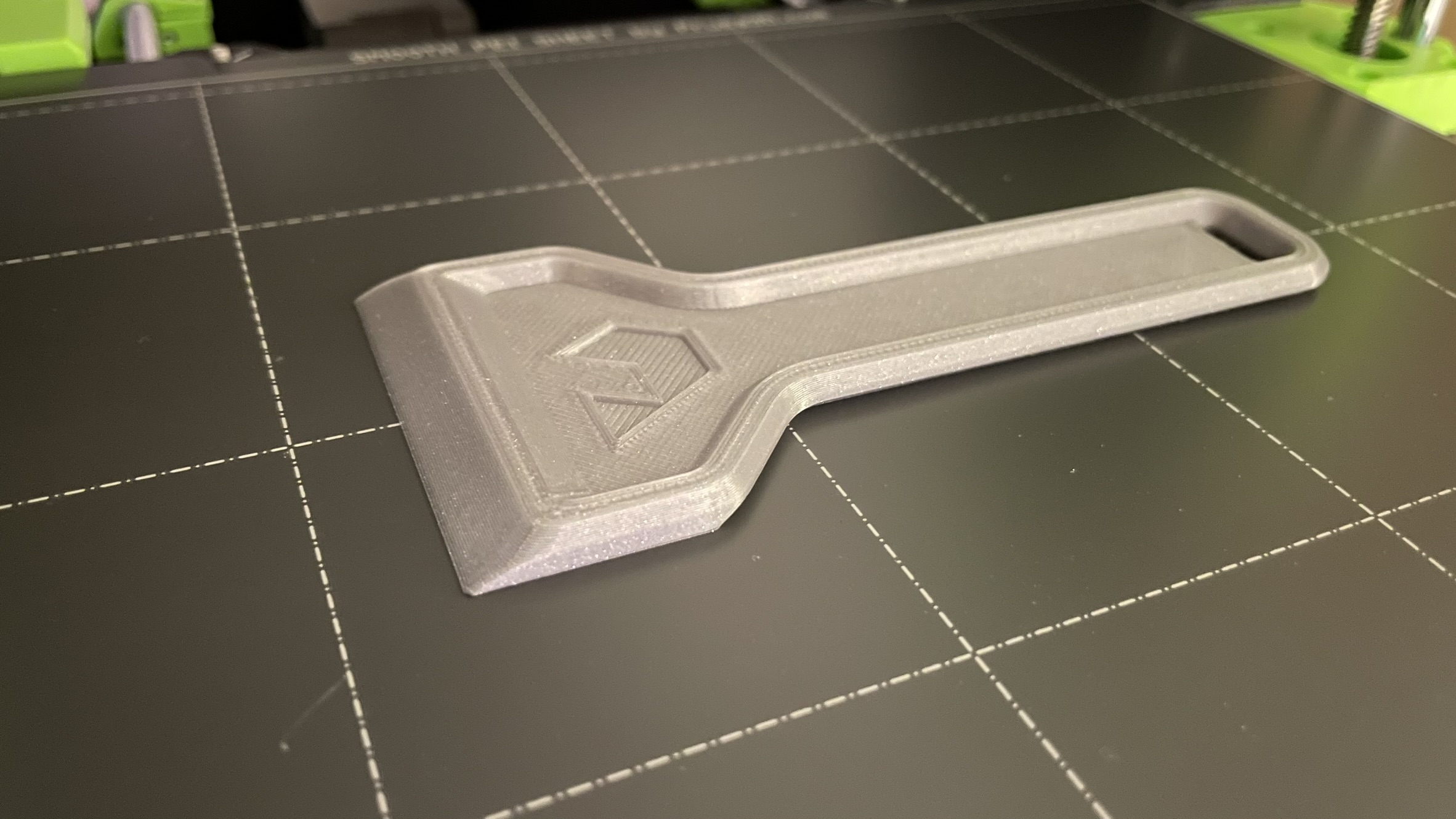

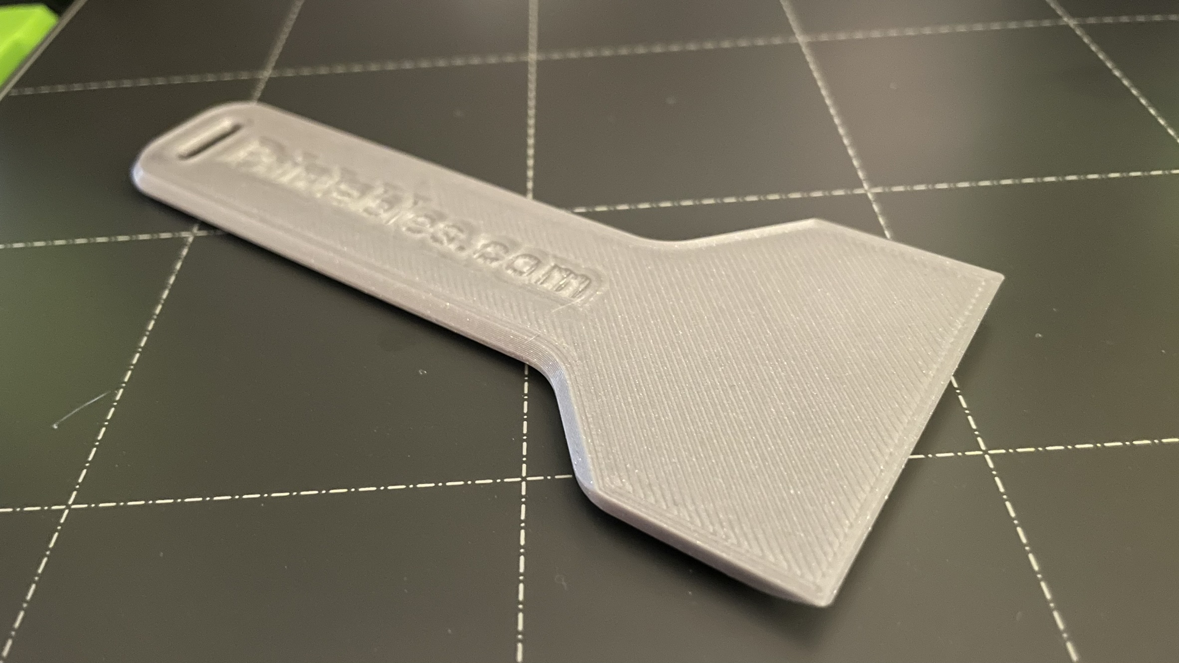

Hi
So i just got around to assembling my new MK4. I already have one MK4 but that was one of the 100 on realease and is therefore factory assembled. Now i have a baseline to compare to.
After my build the printer failed y-axis 1 time, but ran through it all afterwards. My factory assembled machine did the same actually.
Ive test printed the scraper on the usb, and im not keen on the first layer, if seems to high. Ive looked through articles, and im not sure what to do here?
The rest of the print looks fine.

RE: Selftest passed, Z-Height is off
I know that there is a way to live adjust the Z height and that first layer does look a little off. Maybe try another quick print - you could always stop it after the first couple of layers and have a look.
Its correct you can live adjust the Z, but only for the current print. Its the Z-height measurement in bed probing theres and issue.
If you wanna adjust your z height for current layer, you can press the knob while printing to get the menu to do so.
I tried several prints, and prints i sliced myself instead of using the premade gcodes on the usb that came with the machine.
The factory assembled machine does make a neat first layer, the kit machine does not.
