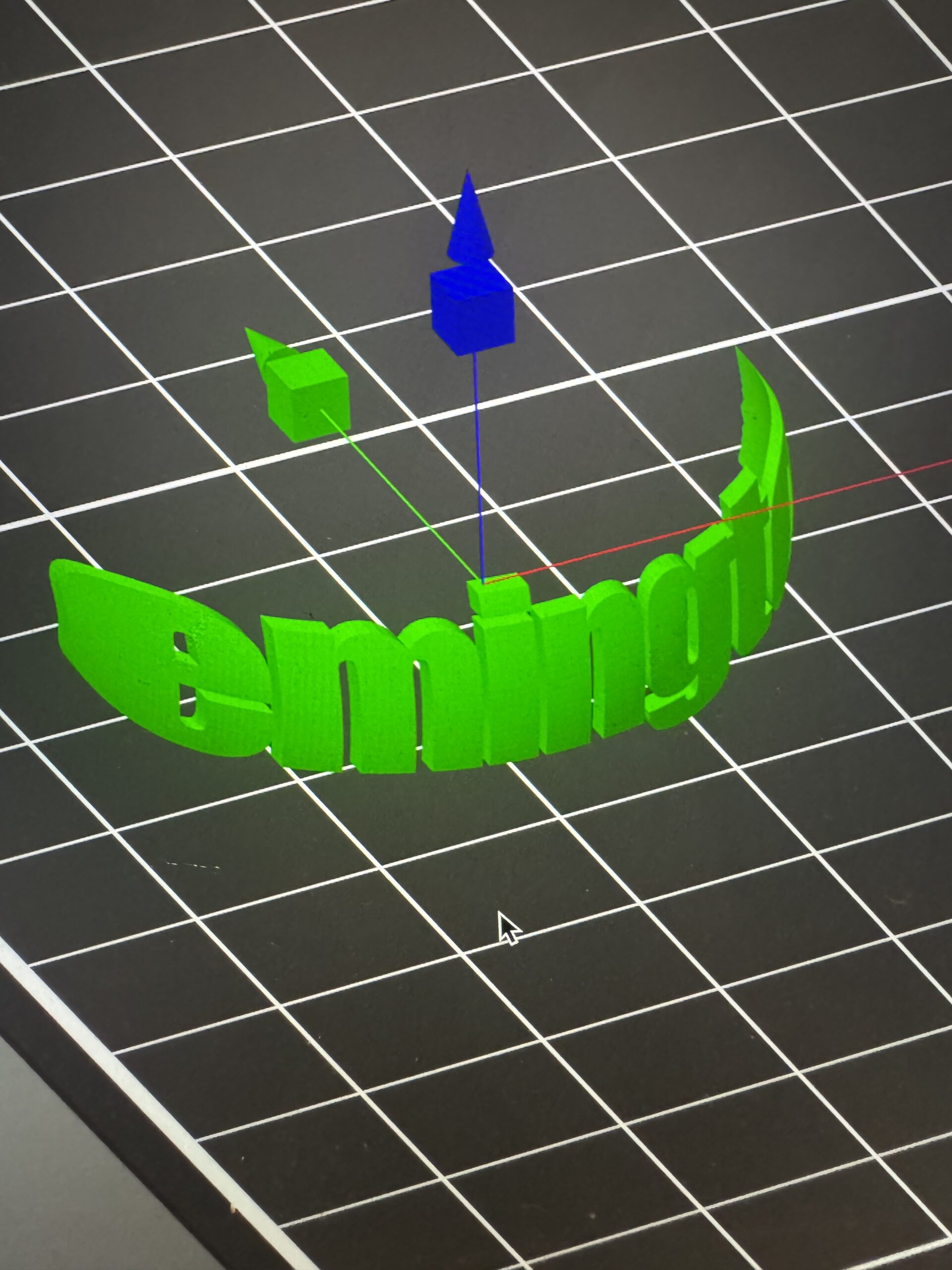

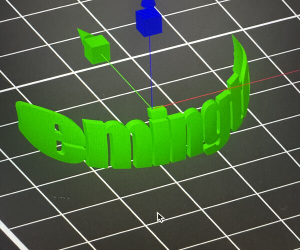

I’ve been trying to find a work around but no luck. Trying to place text on a round object but letters become distorted and stretched out instead of place neatly on object. Any help? Thanks!
