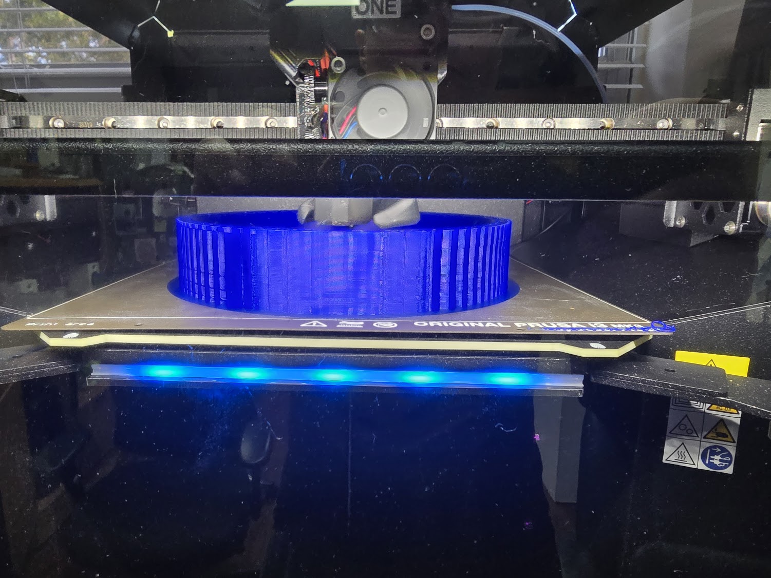

I am printing a 6 inch wide by 6 inch tall bucket for my kayaks dry well out of ASA filament. It's a 24 hour print and I got up this morning (about 6 hours into the print) to find that happily the whole thing has stayed firmly attached to the build plate but unhappily, it has literally lifted the build plate off the heat bed?
I have the chamber temp set to 55 but it has not been able to get over 49 degrees so not sure what more I can do to keep the temp higher inside to reduce the asa trying to warp. Does this just mean I can't use ASA for larger prints with the core one?

That's always tricky with ASA.J
ust a few key figures before I get my statement wrong.
  • What is the print speed?
  • How many perimeters?
  • What kind of infill?
  • What were the bed and nozzle temperatures?

What is the print speed?  300ms
How many perimeters? 3
What kind of infill? gyroid 20%
What were the bed and nozzle temperatures?  bed=100  nozzle=260   chamber nominal=60  minimal=45
solid layers bottom=5
ambient=74 f
Using the prusament asa profile
Do you mean 300 mm/s? Or 30 mm/s?

I've never been quite sure which number in prusa slicer is the "print speed" setting people refer too? Theres about 20 different "speed" settings under the "speed" menu in prusa slicer and none of them are called just "print speed"
the 300 number i gave you is what "max print speed" is set too and I see print speed ratings between 300 and 600 all the time so assumed that is the one. What is the specific name of the "print speed" number your looking for?  for example, perimeters is set to 70 but infill is set to 120? It doesn't list an overall print speed for the whole print that I can find?
