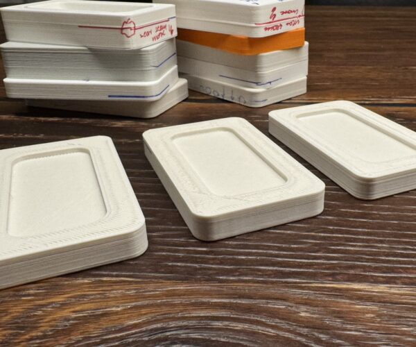

Hey everyone. I have a very challenging problem that I've never had before. This design has a middle bottom a few millimeters above the print bed. See the section view of the design (2 versions):

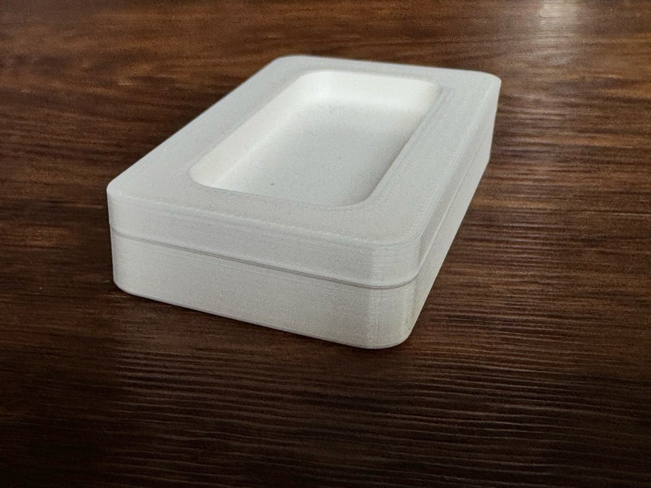

When I print these on the Prusa CORE One, the print has always an odd vertical imperfection that results in a bending outward layer exactly at the height of that middle bottom (see image below):
Print settings on the CORE One:
  • PLA - tried various high quality filaments from well-known brands.
  • Standard print settings for 0.2 layer (speed and structural)
  • Only modification 3 perimeter (does not make a difference in the result if 2 or 3 perimeter)
  • Vent grill and door is open
  • PrusaSlicer 2.9.3
Despite several year of experience with FDM and various printers, I couldn't figure out the root cause. I've already tried the following with no difference in the results:
  • other filaments
  • other printer
  • different settings like speed, structural
  • change the seam position e.g. to rear
  • changed the nozzle of the nextruder
My observation and conclusion so far of the root-cause: this odd imperfection seems to be caused by some stress of this middle bottom in conjunction with the infill perimeter. If I remove this bottom completely then the quality is perfect. Or if I would use concentric infill, that has almost no connection between the bottom and the infill structure. But this infill lacks stability of the part. Strange in addition is the fact that the print result is much better on a Prusa i3 MK3S with much less visible outward / imperfect layer at the bottom height.
Any other ideas or recommendations? You may download the 3mf.file here and print with other settings. Very curious if anyone get better results or has ideas on how to improve.

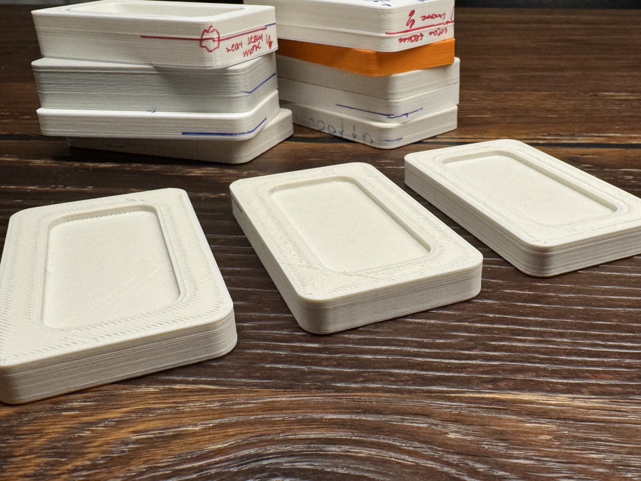

Many thanks for the suggestions. I've found the thread about "Buldge" and from BosStro with all the recommendations. (see here).
I've tried multiple other tipps. Here my results. All printed with Spectrum PETG, 0.4mm HF Nozzle, 0.2 mm:
  • reducing warping: as suggested the less warping the better. In my case closing the door of the CORE One printer improved the result slightly
  • reducing speed: reduced speed on the height of the middle bottom where the bulge / line was visible to 80 mm/s > slightly better result (see sample on the right in the attached image)
  • external perimeter first setting: improved the result remarkably (see sample in the middle)
  • gyroid infill: worked best and improved the result also remarkably; much better than other infills that I had also tested: rectlinear, zigzag, grid (see sample on the left)

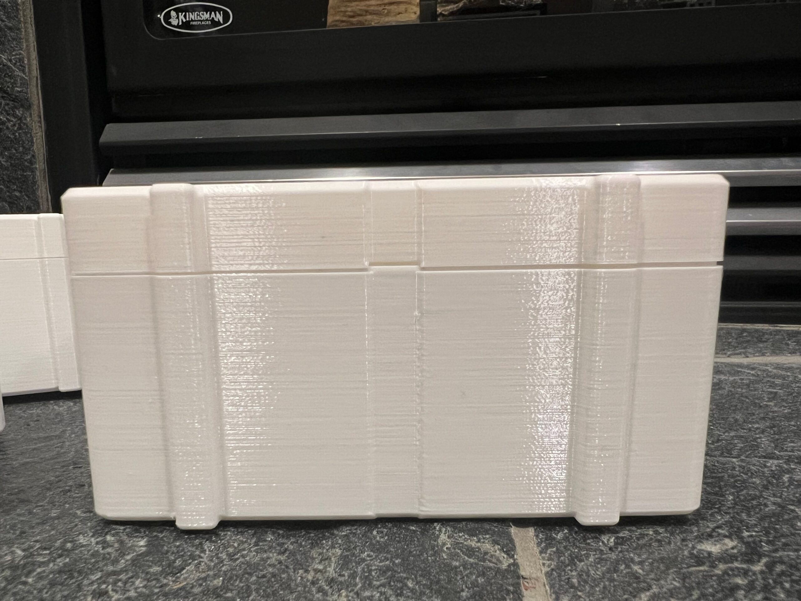

Here's another approach that involves modifying the original design (for future reference if this isn't appropriate for your needs in this instance).
I added the debossed hex pattern (embossing would work too) to the inside bottom of the box.  The first iteration with straight sides and flat floor showed the "benchy hull line" that you see, and also had some corners lifting slightly.  The vertical features on the outside of the box (and some mouse ears) took care of the warping, and the hex pattern completely eliminated the bulge at the level of the floor.  I should be able to add some before/after photos later today...

In a nutshell the part is shrinking, and it can't shrink as much where you have the continuous beam.
I think your discovering some partial solutions, but printing in a vertical orientation with support or altering the design to not need support when printing vertical is your best bet to not have a line.
Much higher infill and more perimeters can help too.
This highlights designing your part as much for 3D printing as possible.

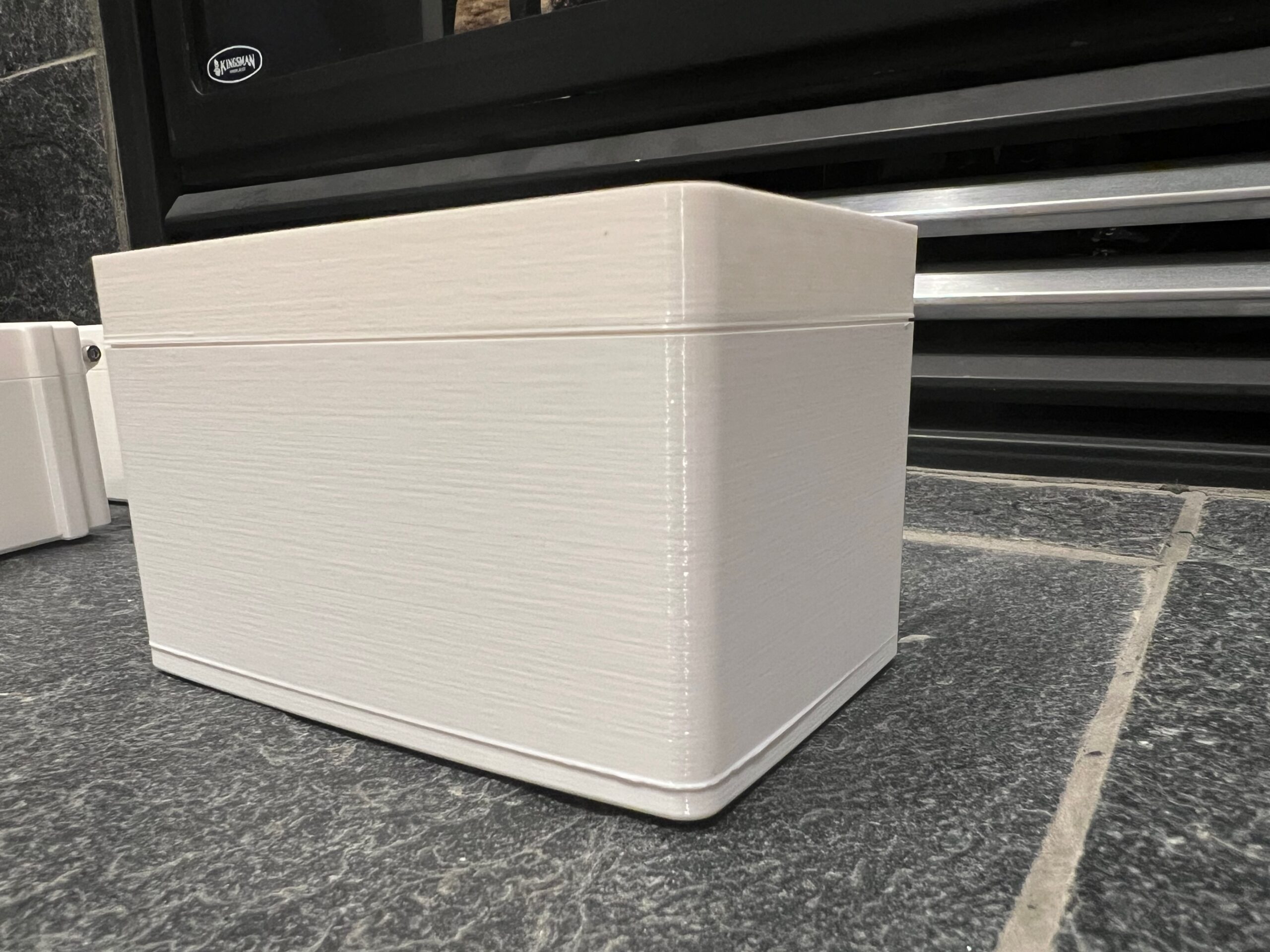

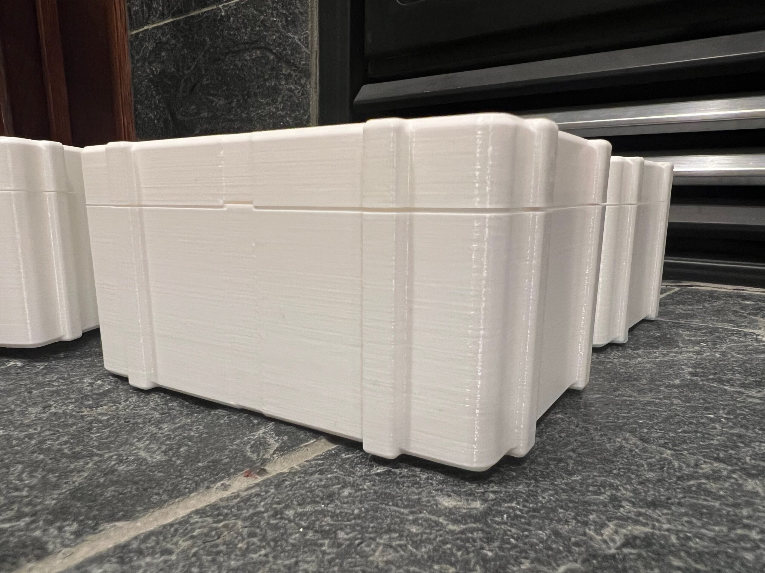

To highlight how much of a difference this made, here's the before & after photos - the hex pattern completely eliminates the bulge.
Original box - bulge near the bottom due to the inside floor of the box:
Updated model with debossed hex pattern in the bottom of the box (see rendering above):
Reinforces what @brian-12 said above about designing for 3D printing.  Model is here: https://www.printables.com/model/1137668-penny-drop-game-v2
