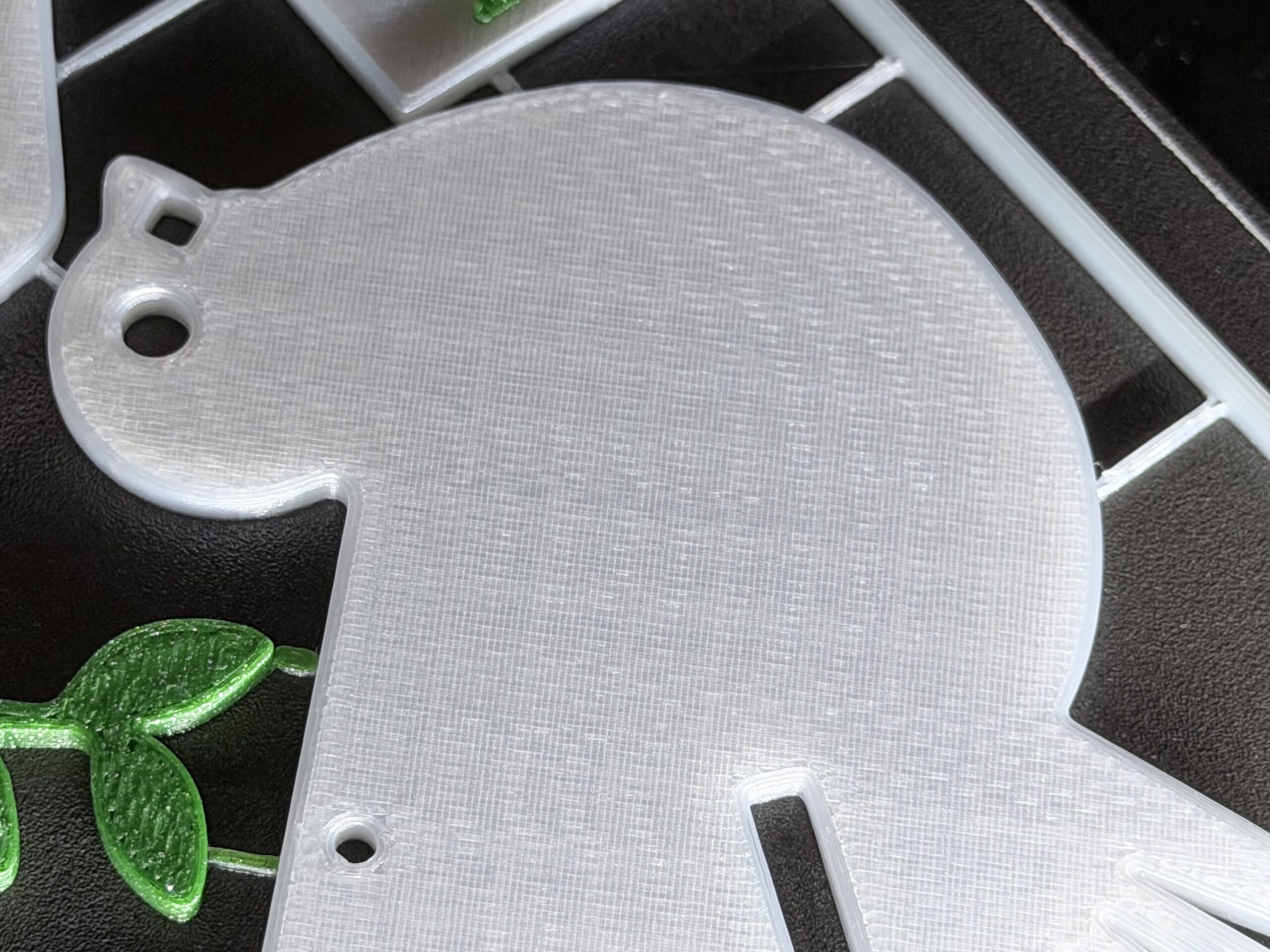

Dear Prusa community,
On my Core One I'm experiencing since a few weeks this 'ringing' artifact on horizontal / top layer.
It is almost like VFA's on a top layer. Which makes this layer look a bit rough. Combined with this I see ringing or a echo for lack of better words,
Things checked:
- Belts are tuned (firmware 6.4.0) using the manual stroboscopic way.
- No rubbing of the belt on the idler(s)
- Balanced profile
- HF nozzle set in profile.
- Using PLA generic. Tried with higher and lower flow rates (110% - 90%). With no real differences in print quality.
- Temperature -10 to +10 tried, no differences in print quality either.
I'm a bit out of ideas and hoping for some brilliant community insights.
What could this be? (Or better, how to mitigate this..)

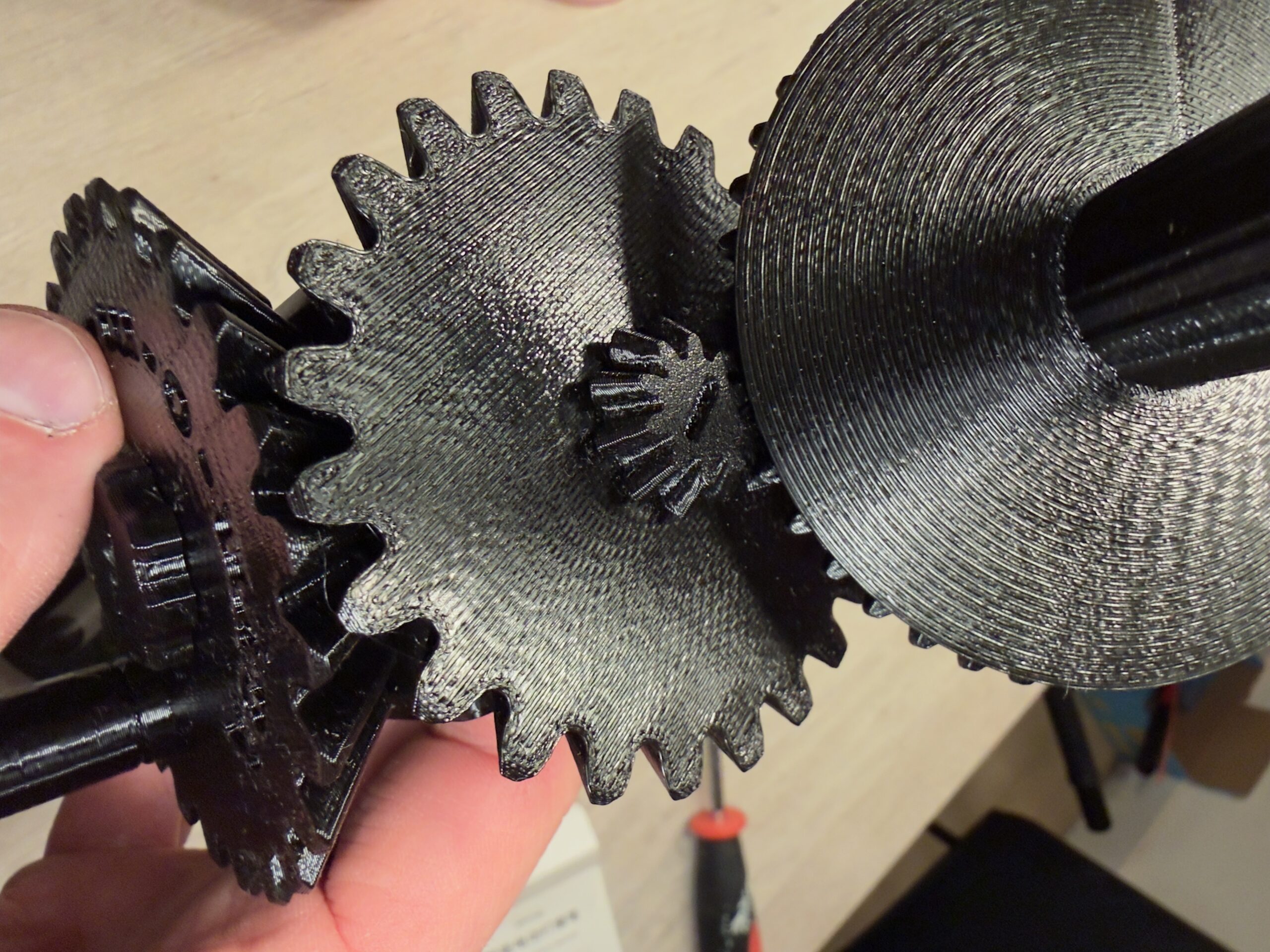

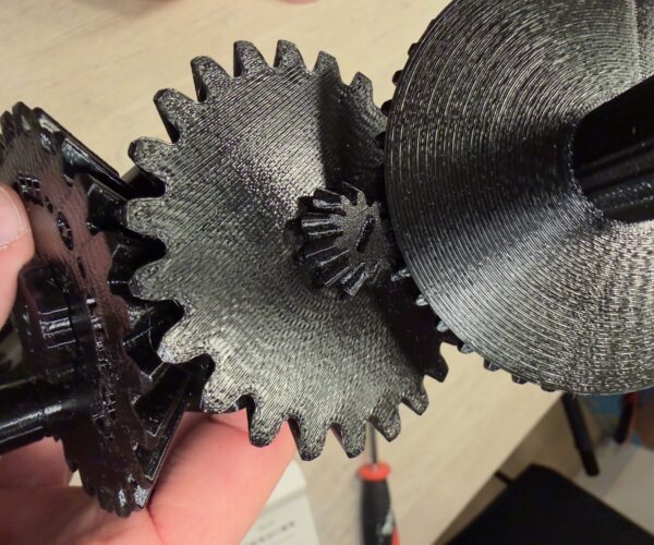

RE: More images: Ringing, or other artefacts on top layer. What could this be?
On this black PLA you can see the issue even better.
The top layers, look really bad. With what I can only describe as ringing or echoing.
Also in the last image you can clearly see normal VFA's on the sides of the print. This with the belt tuned (using the stroboscope) 97 Hz/92Hz.
I have now, serviced the printer, tightened the belts, cleaned the nextruder (gears). Used different PLA (brands (Prusa and others), colours you name it.
Tried, structural, Tried Balanced, tried speed profile, no difference. Tried 0.15, 0.2 and 0.25 layer heights, no difference.  Played also with flow-rates.
What more can I do?
Posted : 30/11/2025 6:33 pm
