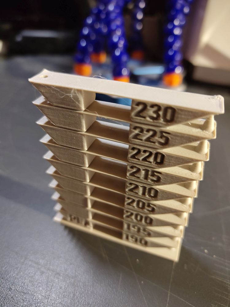

After my new filament dryer is now in use, the moisture is at a smooth 27%. And I can now say with relative certainty that too moist filament (once again) was the main problem. However, not the only one!

Posted by: @conrad-2
Even the temperature tower sides look bad. What does the string look like when you purge filament? It should be round and perfect and drop straight down.
You had asked about the purge line. This is what it looks like after drying. However, it has always looked like this. Even when the printer was still functioning normally. Therefore, I don't know if this says much.

Anyway, back to topic. Here's the temperature tower after drying
Tower after drying Tower after drying

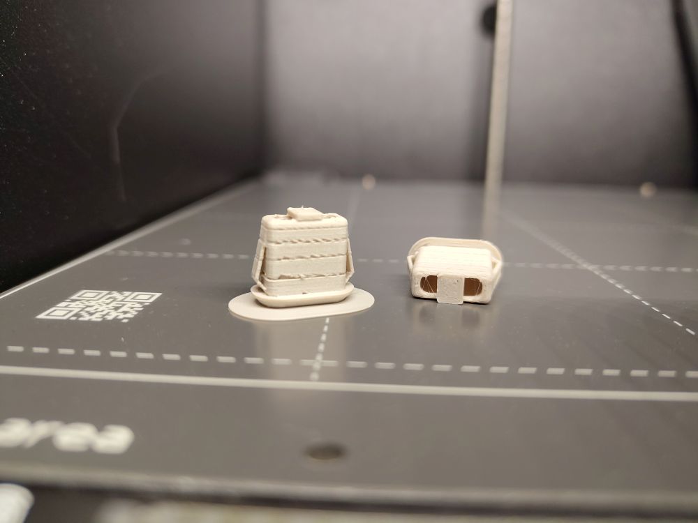

And here are the USB trims, which have also previously served as an example. They look much better now, although there is still very slight stringing. For this, I completely re-sliced the trims to get rid of possible errors in the old GCODE-files. So I pulled the original model into the slicer, added the endstop and brim, sliced it, and put it in the print queue.
trims after drying trims after drying

However! Sometimes there are these strange artifacts/lines/disturbances. I haven't had this before. This was printed with the old GCODE-files and the reason, why I re-sliced them. The errors did not come back afterwards.
weird defects 1 weird defects 2
Sometimes you can also hear a "clicking" sound during certain movements. However, this doesn't always occur, and I haven't been able to localize it yet. I guess I'll need to look for loose screws or something similar. I would be grateful for further ideas on where to start my search. And no, it's not just a random tool sitting on top of my printer that I forgot. 😉

gb160
(@gb160)
RE: Troubleshooting - looking for ideas
That's still not 'dry' buddy.
That clicking noise is the extruder, and looking at those last 2 pictures your nozzle is partially blocked.

Trax Beaumont
(@trax-beaumont)
I apologize if I expressed myself unclearly. I got the prints with the artifacts right after I first printed with the dried filament. Since then, the problem seems to have stopped occurring. So I guess, the blockage cleared itself?!
But thank you for the hint about the "clicking" noise. If the problem occurs again, I suppose I'll disassemble and examine the extruder.
But are you really sure about the not dry enought filament? Most of the other sources I found speak of a range between 40 and 20% humidity as optimal for PLA. Since mine is at about 28% I figured, I am in a safe territory.
