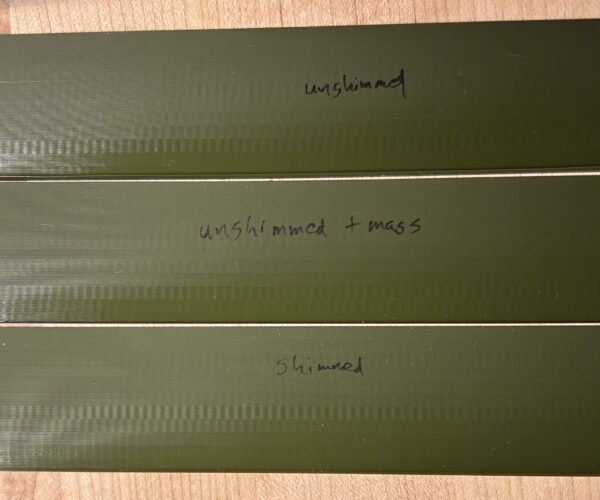

Hi all,
I'm one of the unlucky ones with pretty noticeable VFA artifacts. I think consensus is that there is a belt-driven resonance that's to blame. I think most of the focus has been on the excitation side, that is, avoiding driving the resonance. I admit I didn't look very hard, but I didn't see any posts on the exact nature of the resonance itself. I've got some experience in tracking down modal resonances from my day job, so I wanted to take a crack at it.
First, I drove the unit into resonance by printing horizontal lines at the known most-problematic speed. Then, with the case sides off, I started pushing, holding, or otherwise stressing different parts of the frame and gantry. I noticed the resonance completely disappeared when I pushed hard on the left and right sides of the gantry itself. I then tried mass-loaded it as well as I could and saw the same result.
If you completely loosen the belts you'll find that there's quite a lot of play in the gantry. The only thing that really seems to be keeping it square is the belt tension itself. So my best guess as to the actual mode is that it's a spring-supported torsional vibration of the gantry itself, rotating about the the vertical axis, as shown below.
The flimsy L brackets form a torsional spring and the belts act like another set of springs. The resonant frequency should be related to those spring constants and the moment of inertia of the bar about that axis.
I did a few test prints to verify. I swept over speed starting at 40mm/s and increasing in 20 mm/s increments. Harmonics at 80mm/s and ~160mm/s so fundamental is going to be around 80mm. I then mass-loaded the gantry by attaching masses (~0.3kg) to the ends of the gantry and ran again. Harmonics are visible 40, 80, 120, and 160 mm/s, so that would put the fundamental lower at 40 mm/s, exactly what you would expect from this mode.  I then stuffed some plastic shims in the gap between the L bracket and the linear rail. This increased the first resonance higher to 140 mm/s with no visible harmonics.
Still could be wrong, but this is as close to a smoking gun as I ever get in my field.
Speculation: I think the reason there's such a wide variation in individual printers' behavior is that the L brackets have some variation in the bend. Some people get close to 90 degrees while others are quite different than square. I think what that does is if the bracket is out of square, it effectively acts as a preloaded spring, so the resonance changes (maybe pushing it out far enough that it's unnoticeable).
In any case, it's clear to me the gantry bar just needs to be dramatically stiffened up in order to squash this resonance. I realize that (somewhat) overconstrains the gantry, but my alignment is already pretty good; I honestly don't think it would be much of a problem.
The bigger problem is that there really isn't any room to make substantial changes to the gantry without reducing the print area or having to redesign a lot of parts. It'd be great if I had 5cm of clearance on all sides but it just isn't there... The best stopgap approach I can think of would be to change the steel bar to a slightly longer (5mm longer) solid bar with screw holes on the ends, then the bracket could be screwed to it T style as well as from the side of the bar like it is now. Maaaybe if the L bracket were made out of much thicker steel, that could also help.

i agree, mass increase is bad.  it was only to show the resonance shifted.  i believe stiffer is better, e.g. compare to the voron's gantry design (SUPER stiff), but that's testable.  My next steps are to shim with something more rigid and repeat.  I suppose i could completely loosen the brackets to test the other case.
For what it's worth, my gantry is super square and i've gotten quite good at tuning the belts now, right at their new recommended targets.

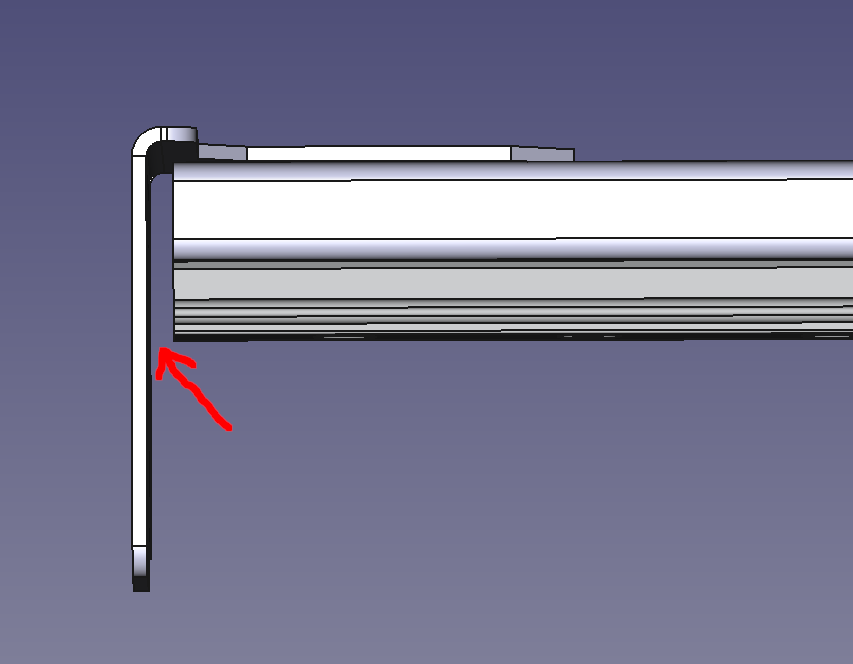

Interesting path! This would also tie well with the fact that increasing belt tension apparently decreases VFA, because more tension means that the gantry gets stiffer.
I wonder if a hard plastic part that would be screwed on top of the brackets like this would help. It would need to be thin on the bottom due to the fan, but could be a bit thicker on the top. And it would of course require the gantry to be square.

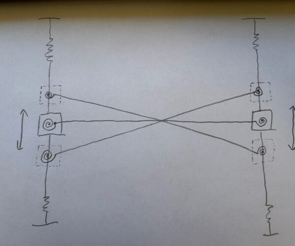

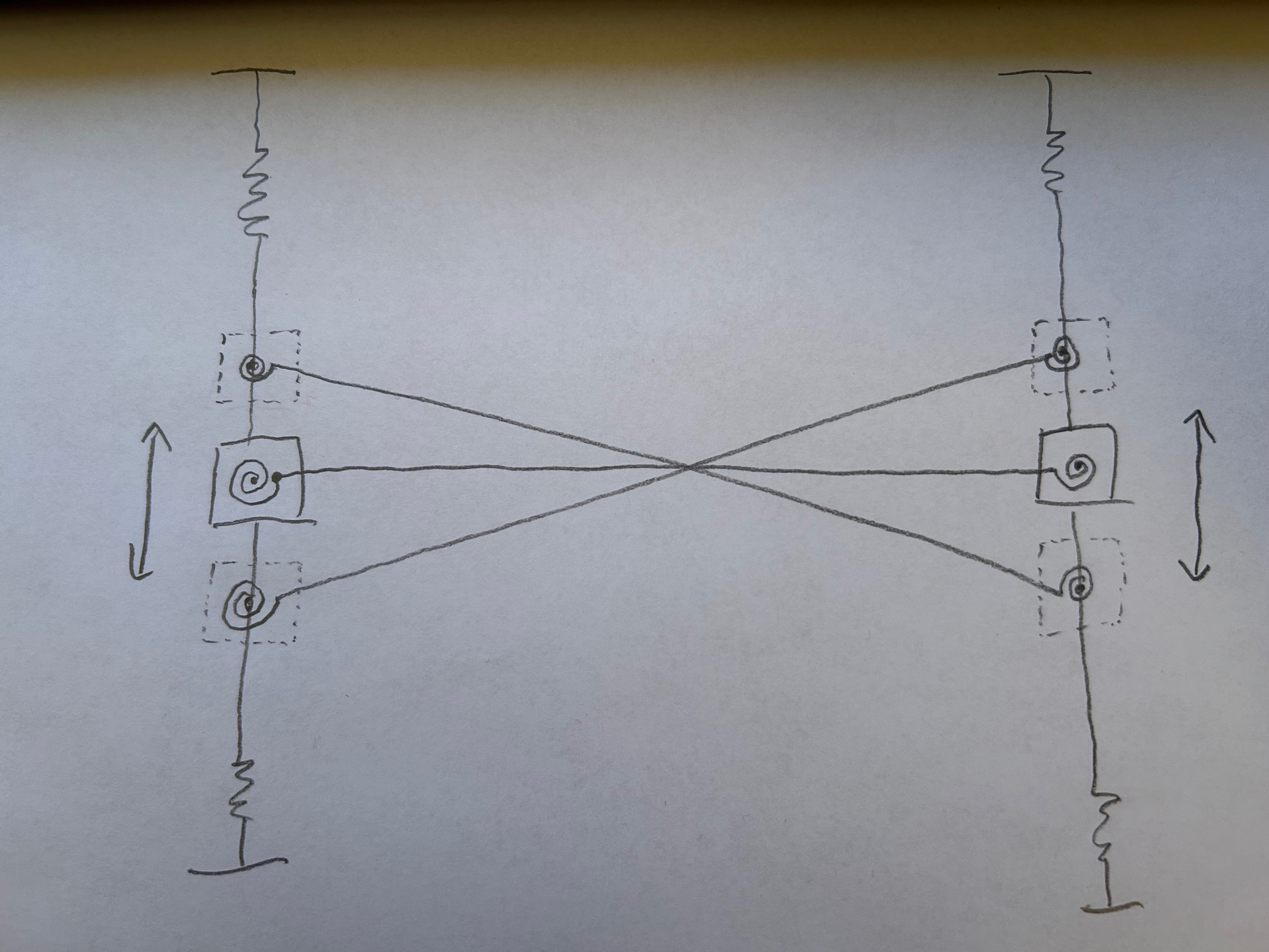

One more thought/question: If the underlying mechanism is a torsional oscillation as (very plausibly) suggested by @huggypanda -- wouldn't one expect to find stronger VFAs towards the left and right side of the print bed, and weak or even no VFAs right in the center? But I don't think that is what we observe on the Core One.
Of course one could also envision a lateral oscillation instead (i.e. a parallel displacement of the whole gantry). I don't think any of huggypanda's experimental findings rule that out so far. Intuitively I would say that the torsional motion, with a lower resonant frequency, "feels more likely" -- but can it explain the constant VFA amplitude across the whole X range?
Any thoughts?

I've had this same frightening thought. If everything were absolutely perfect, the system would rattle around the bearing clearances. Maybe perfection is being a little less than perfect. I do keep coming back to the VFAs being at the belt tooth pitch and not being 100% sure why. Reading the belt manufacturer's fine print, the pulley geometry might not be absolutely optimal for the tooth design. I know people have used different pulleys, but I've never heard of any revelation in that department.
