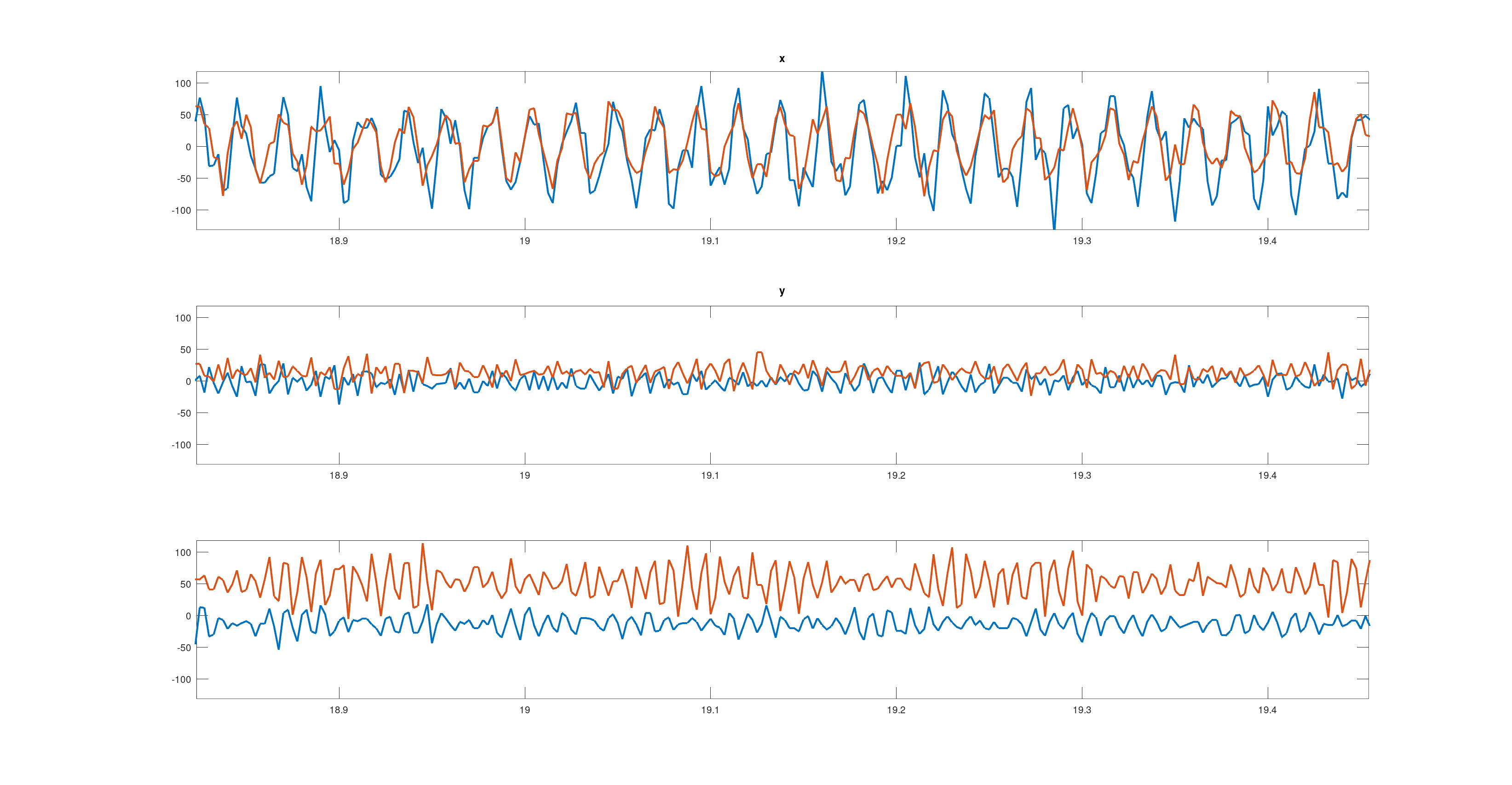

Update:
I got some aluminum shims and screwed them down fairly tight as suggested by another poster here. This pushed the resonance up to ~120 Hz but I could get it no higher than that. Artifacts are still very visible on "normal" prints (i.e., not test prints), so fairly disappointing results overall.
I also attached two accelerometers to the extreme arms of the gantry.   Quick conclusion: it's apparently NOT torsional, at least not about the vertical axis. It could be torsional about the length of the gantry itself but I don't have measurements that would show that.  Given the low frequency of ~45 Hz that seems unlikely to me.
In these plots, x axis faces the front of the printer (perpendicular to the gantry), y axis to the left and right (parallel to the gantry) and z axis (vertical). Data is sampled synchronously at 400 Hz. This data was collected while printing a thin vertical feature oriented so the print head is moving left and right.  The turning points are most visible on the z axis.
The x axis has most of the motion and zoomed in they are almost exactly in phase.  So NOT torsional about the vertical axis, because then they would be out of phase.  At least from this it is looking most like a simple spring-supported rigid body mode predominantly vibrating along the smooth rails. I don't know why shimming moved the resonance up so clearly.  Mysteries.
And zoomed in:
Posted : 12/02/2026 4:04 am

Excellent to see some accelerometer data. I notice that the frame of my Core One flexes quite a bit while printing. It's on a fairly rigid surface, so the bottom doesn't move much (calibrated light finger touch), but the top of the frame seems to move a good fraction of a mm at times. Have you stuck an accelerometer anywhere on the frame? I assume the important motions are difference motions between the build plate and the Nextruder, even if everything is shaking in the wind.
Posted : 12/02/2026 4:19 am

Thanks for testing it further! Was the accelerometer test made without the shims?

Correct, without shims.  Totally stock and tuned to recommendations.

Now that I have the tool put together, that is something I can check.  But for what it's worth when I was initially poking around I pressed everywhere on the frame.  Squeezed it from the top, pushed on it, "hugged" it.  Definitely things are moving but I couldn't get the print head to stop wiggling.  I even tried loading the belts thinking maybe they were resonating.
