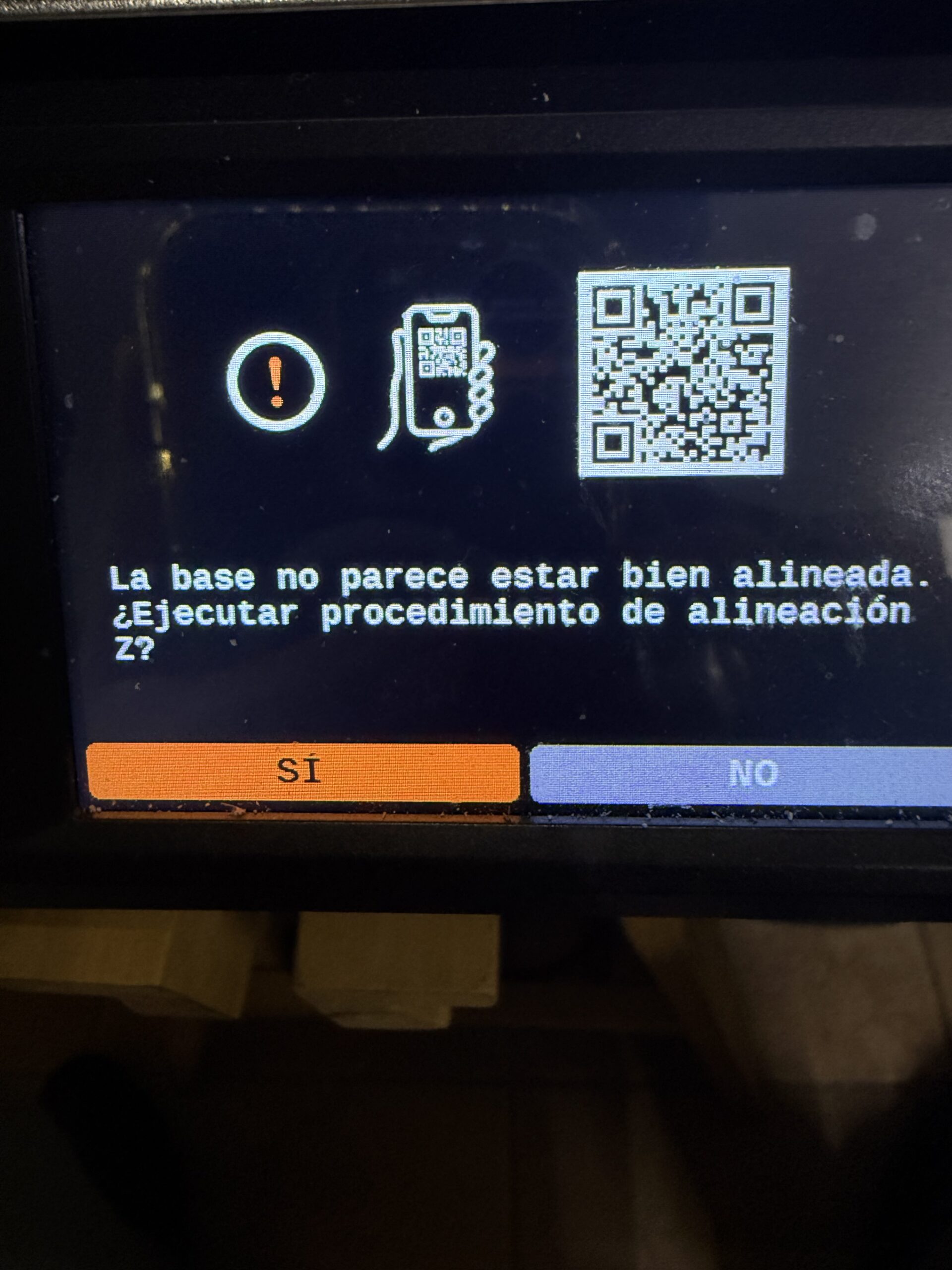

After four months of using the MK4S-to-Core One upgrade, and after hours of chasing “Uneven Bed” errors and unexplained layer inconsistencies, I’ve identified a significant design/policy oversight in Prusa’s upgrade path that I think users should be aware of.
The issue: transferred mechanical wear
The official upgrade kit instructs you to reuse the two POM trapezoidal nuts from the donor MK4S, while providing only one new nut for the third Z motor. After relatively limited use, I’ve measured 0.2–0.3 mm of axial play in the two reused nuts, while the new one remains rock solid.

That seemingly small 0.2 mm of axial play is enough to confuse the loadcell during mesh bed leveling. The resulting errors often look like extrusion or calibration issues, when in reality the bed is physically shifting under nozzle pressure.

The mechanism is simpler than it might seem:
During Z homing / bed alignment, the bed is driven downward until it hits the mechanical stop. The firmware then continues to drive the Z motors slightly further to make sure the system is fully seated.
At that moment, the trapezoidal nuts are forced against the upper end of their axial clearance.Once homing is finished and the bed is raised again, gravity takes over. Any nut with axial play will settle back to the lower end of its clearance. If one nut has 0.2–0.3 mm of axial play, that corner of the bed will drop by that amount.In a three-point Z system, this directly translates into a loss of bed level, even though everything appeared correctly aligned during homing.

I actually was:  just not using the word leveling explicitly.“Uneven Bed” errors and first-layer inconsistencies are precisely how a loss of effective bed level manifests on this machine.
My point isn’t about achieving sub-0.1 mm geometric perfection, nor about manual shimming or adjustable end stops. It’s about internal consistency: the bed being referenced in one axial position during homing and then settling into a different one during printing due to axial play in reused nuts
A complete Core One kit ships with all-new Z components for a reason. Reintroducing worn parts through an official upgrade path undermines that consistency, regardless of the absolute frame tolerances.

I see your point, and you’re absolutely right that the initial mesh compensation can account for a fair amount of static deviation
Where I still see a real issue is that this isn’t purely static. With noticeable axial play in a reused POM nut, the effective Z reference can change after the mesh is taken, due to frequent Z-hops during printing. When that happens, the stored mesh no longer represents the actual bed position, which is when “Uneven Bed” warnings and layer inconsistencies start to appear.I’m not arguing that every slightly loose nut is catastrophic, nor that this can’t be worked around mechanically. My point is simply that reusing worn Z components in an official upgrade introduces a variable that a full kit avoids by design.If your machine behaves consistently, I’d probably leave it as is. In my case, replacing the reused nuts eliminated the issue entirely.
