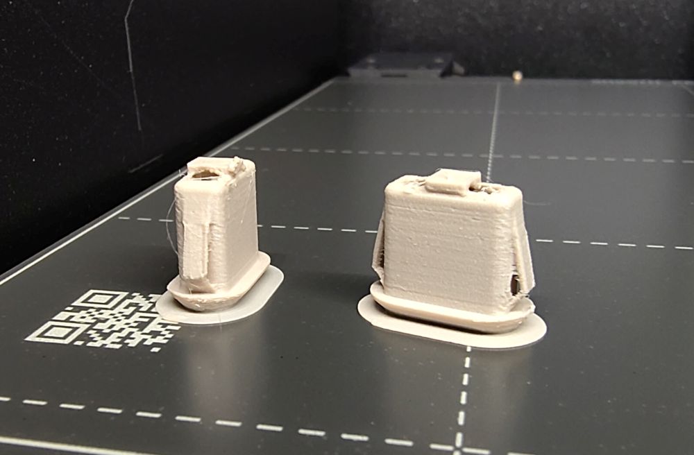

I'm trying to get to the bottom of a recurring problem with my Core One and hope to get some ideas here. My printer has a stringing problem and under-extrudes when printing at coarse 0.28 Draft quality (see photos).
TLDR; I suspect that the Nextruder or another piece of hardware might be the problem, as both the stringing issues and some under-extrusion (only at coarse quality settings) occur. Please correct me if I am wrong. Maybe I am even overlooking something obvious.
What I have already tried in detail:
The problems started to occur some time ago. The stringing is particularly annoying with very small and fine prints and requires a lot of post-processing to make the parts usable.
I have already performed a basic printer maintenance, cleaning and lubricating all moving parts. I also checked and corrected the tension of the belts. Neither of these measures brought any improvement.
My filament does not seem to be the cause either. I have the problem with both PLA and PETG. Regardless of whether the filament had been open for a while or was brand new out of the package.For all filaments used (Polyterra and Prusament), I printed a temperature tower beforehand to make sure I was printing in the correct range. Interestingly, there is hardly any stringing on the towers (again see the photos). I have also performed a cold pull - again, no improvement.
To rule out the slicer as the problem, I sliced the same model in Prusa Slicer and Orca - same settings same result. In addition, I stumbled upon several pre-sliced benchies that came with the printer. I tried printing one of them as well right away, and the stringing was noticeable there too.
I read somewhere that printing more slowly can reduce stringing. Since my printer is in the living room, I always use stealth mode for printing by default. This reduces both the volume and the printing speed. In other words, I already print slowly and still have stringing.
printing in progress. very visible stringing
printing in progress. very visible stringing. resolution is 0.11 layer height.

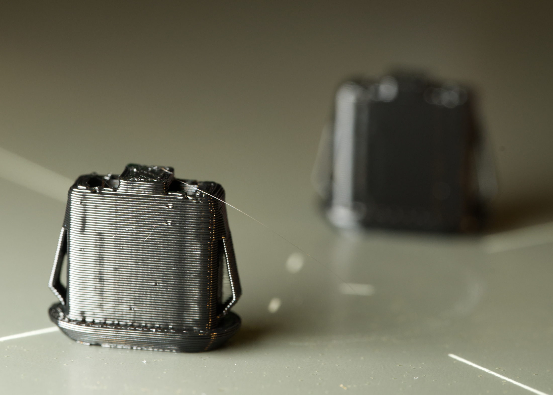

same model, different filament - same problem

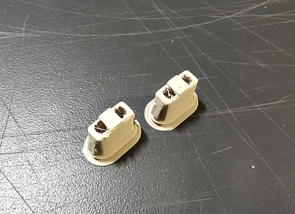

another print but at 0.28. visible under-extrusion.

Well, it *is* called "draft" mode. I'm not sure what compromises have been made to speed it up. It's probably the wrong choice for multiple parts and certainly not what you'd want for a finished part. On the flash drive that came with the printer there's "benchy bonkers" or something like that. It's an 8-minute benchy print where the printer really flies. It would be interesting to see how that does in comparison. I'd look at the all the profile parameters between draft and one of the "balanced" profiles to see what's different. AFAIK, "balanced" were optimized for the Core One.
Napsal : 08/02/2026 3:06 pm
RE: Troubleshooting - looking for ideas
I use draft mode, a 0.8mm nozzle, 1-2 perimeters and lightening infill when I want to print something quickly for sizing. I would never print something in draft mode and expect it to be functional.
Napsal : 08/02/2026 7:34 pm
Draft printing is for rapid rough checking of a prototype - not production, it is by definition sub optimal.
And your filament is damp.

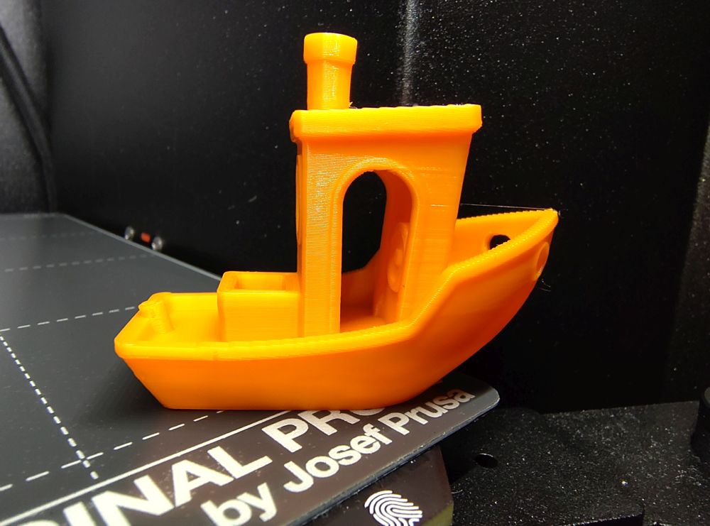

The "Bonkers" Benchy is a good point. Of course, I should have realized that this is not a good comparison because the print quality is reduced. So here is a Benchy printed with the 0.20mm Balanced profile. Looks indeed pretty normal.
regular benchy 0.2mm Balanced print profile
However, I'm not sure if that can really be the cause. I have often printed in 0.28 mm before—whenever a print needed to be done quickly and precision wasn't so important, e.g., organizers for my workshop. I never had any under-extrusion like this before. That's why I'm so surprised that it started relatively spontaneously a few weeks ago (unfortunately, I can't remember exactly when). But I'm relatively sure that it wasn't at the same time as I installed a firmware update or anything like that.

Another great point. Apparently, I underestimated how even slightly damp filament affects the print quality of very fine prints. That's why I put this spool in a food dehydrator for five hours this morning. And this is the result. Much better, but still far from what I would have expected. The "blobs" on the top are still quite pronounced, as are the lines in the walls.
after drying the filament still some visible stringing and inconsistencies

Even the temperature tower sides look bad. What does the string look like when you purge filament? It should be round and perfect and drop straight down. Have you looked in the Nextruder for debris? I wouldn't expect perfection in draft mode, but something seems a bit off. Can you direct me to the stl file for that pair of whatever-they-ares?
Napsal : 10/02/2026 11:07 pm
We're getting there, it looks like it needs even more drying.
Napsal : 11/02/2026 7:51 am

I admit I didn't appreciate how small these things are. I printed them with standard "balanced" settings and a 0.4 nozzle. No extra code, no brim, no nothing. I do try to print multiple items complete, then move on to the next one. The slicer is good at locating things so they don't collide when you do that, just be sure to hit "A" after checking the complete box, not before.
