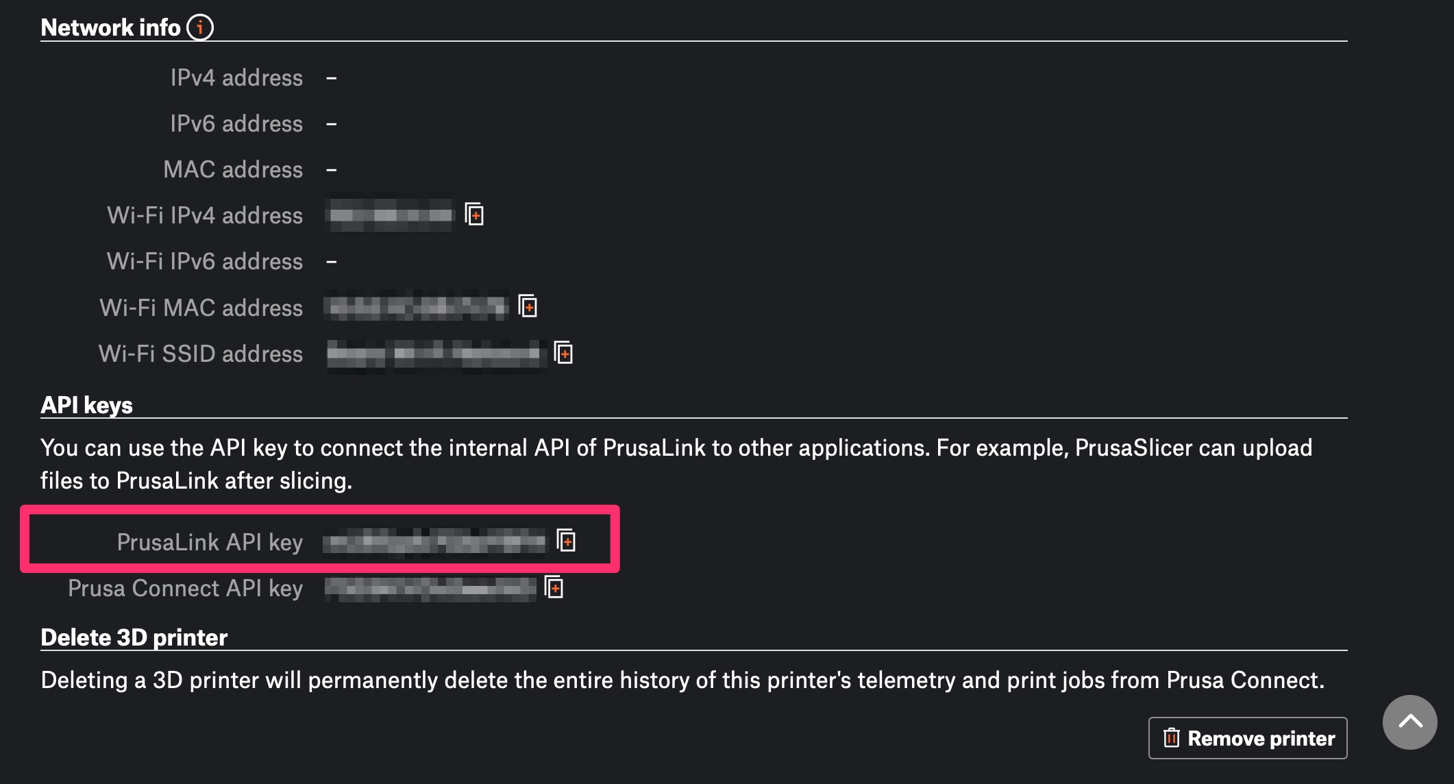

In PRUSA Slicer,
Go to Printers
  Complete the printer info:
    Give the printer a descriptive name
    Select Host type:  PrusaLink
    Enter Hostname, IP or URL:  Presumably the IPv4Address
    Authorization type:  API key (?)
    API Key/ Password.

RE: How do we setup PrUSA Link to our Prusa Slicer?
In Prusa Connect, select the printer, goto settings then scroll down to get the API key for PrusaLink:
