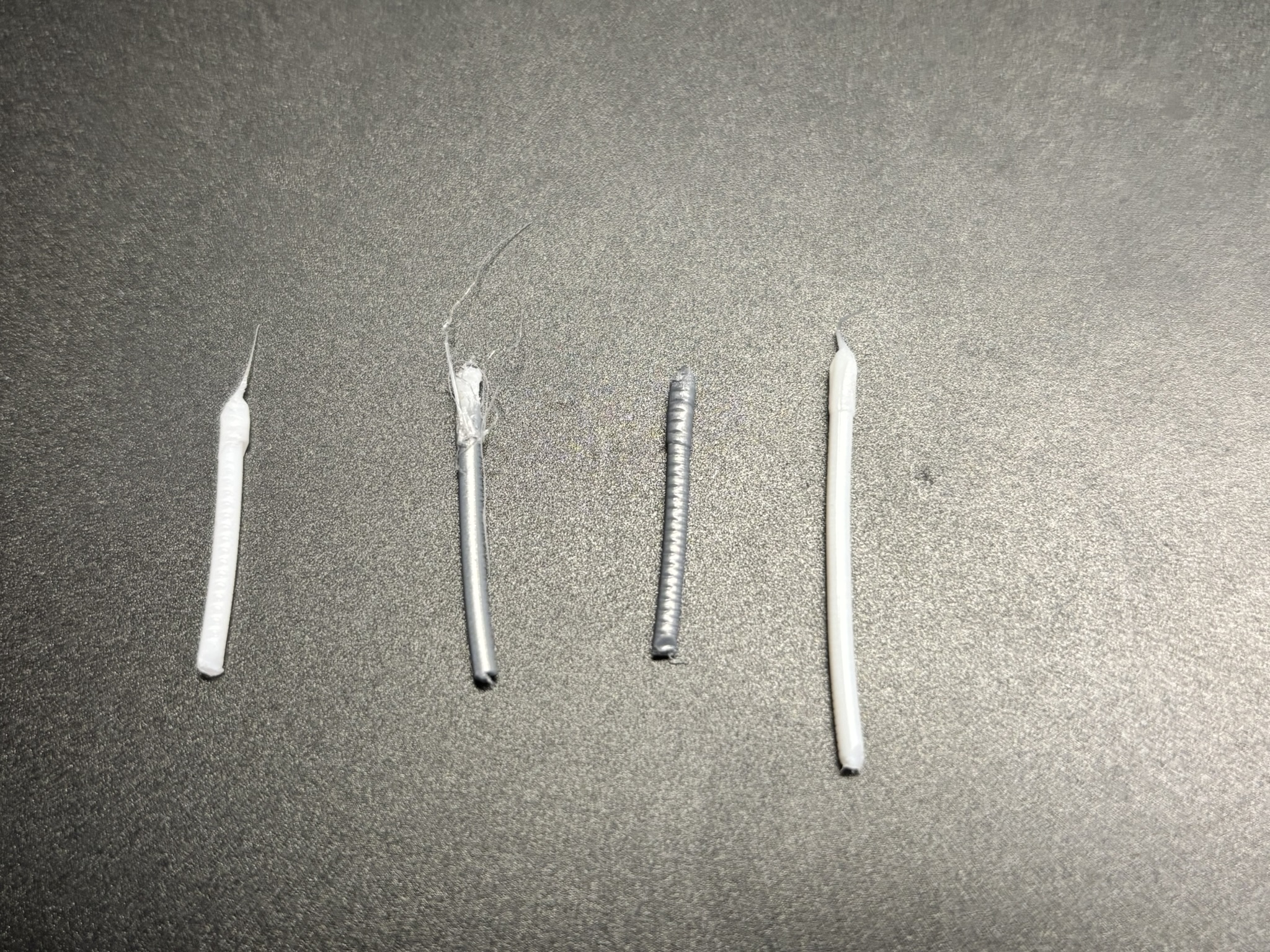

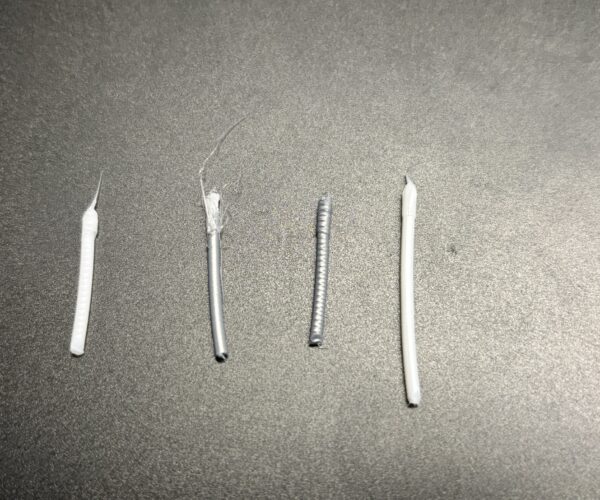

Hello!
I have the exact same problem as @VladimirD. The filament unload fails because the tip is bent. It happens almost always with the same filament (position 4 of the MMU3), but not always. The fault occurs in the Nextruder, so the fact that it always fails with the filament I have in position 4 of the MMU3 seems rather coincidental to me... But I'm mentioning it anyway, just in case. Has anyone found a solution or improvement for this specific problem?
Photo of @VladimirD Photo of @VladimirD

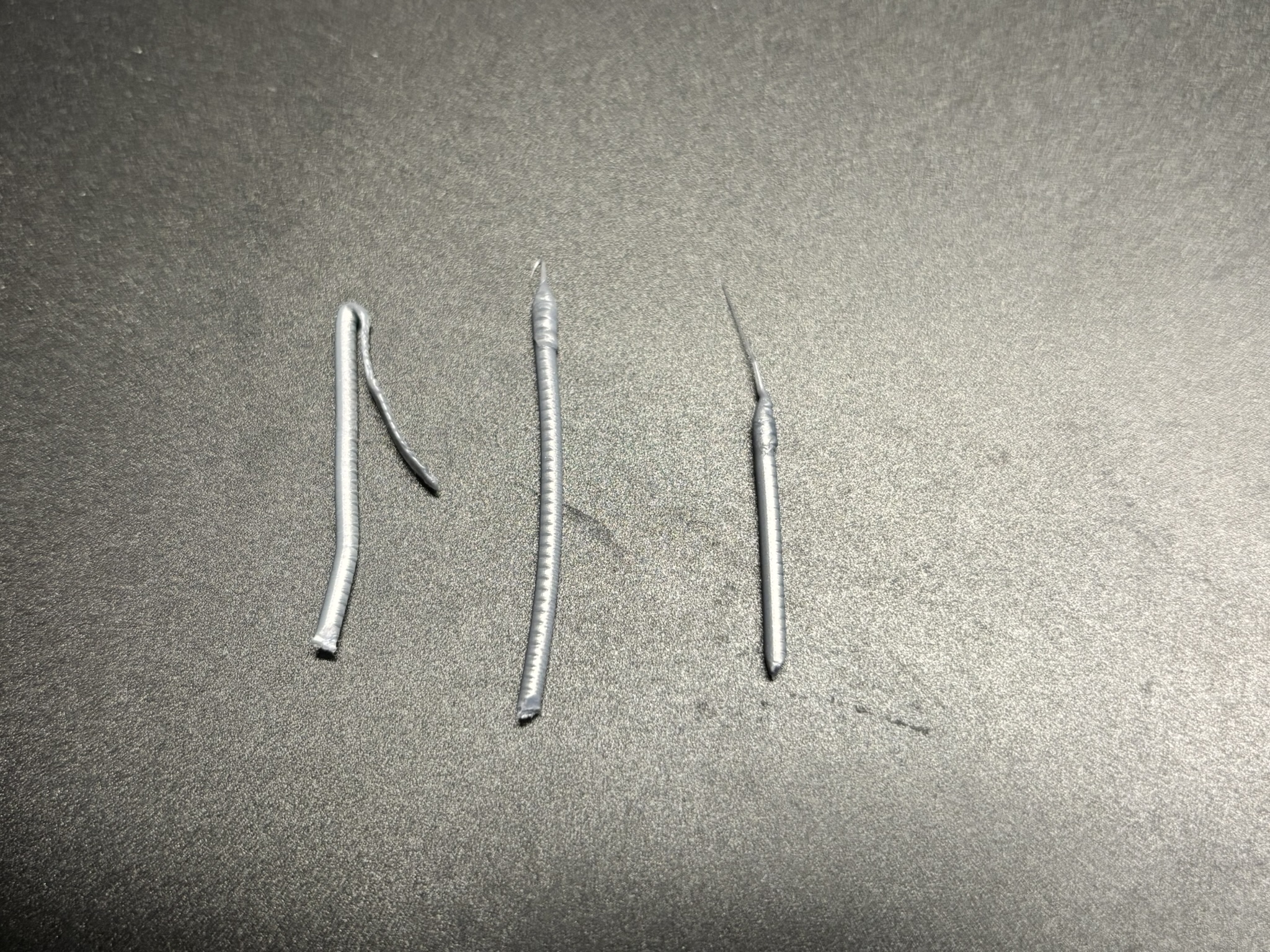

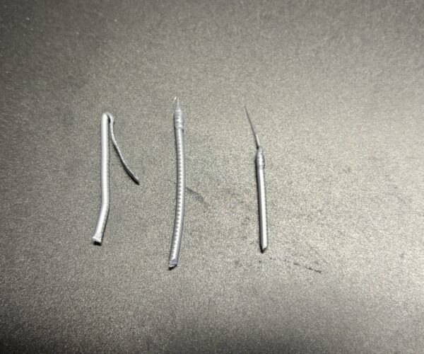

RE: Core One MMU3 Filament unloading getting stuck
What it looks like when the Nextruder and the MMU3 don't pull the filament back properly MMU3 / Nextruder / Filament gets stuck
Publié : 23/11/2025 9:46 pm
