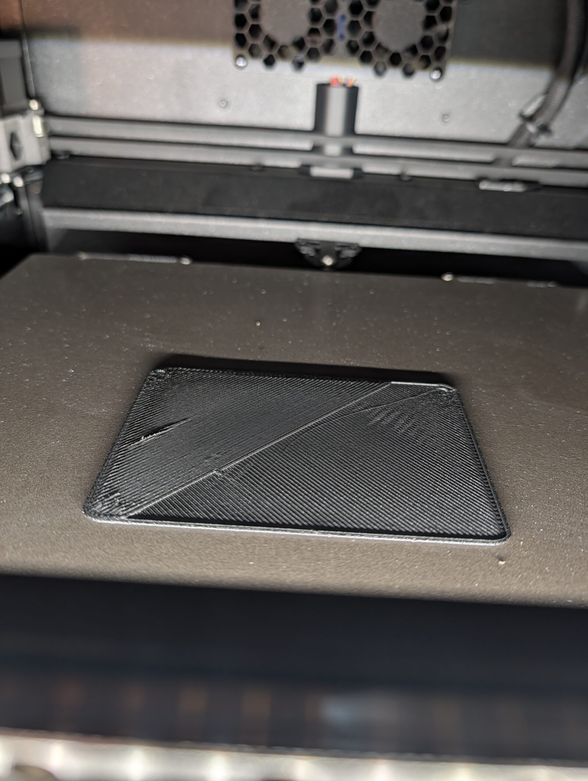

Am i to stupid to Print PETG?!!
Sadly, there isn't a German CORE ONE L forum, so I will try my best in English.
First of all, I’m not new to 3D printing. My MK3S worked so amazingly well that I might be a bit spoiled by it; I never had issues with PLA or PETG on that machine.
I had a rough start with the Core One L because I didn’t mount the 0.6mm nozzle perfectly, which caused a minor crash. Luckily, no permanent damage was done. After that, I printed a few Benchys and Cali-Flowers in PLA, and everything was fine and accurate.

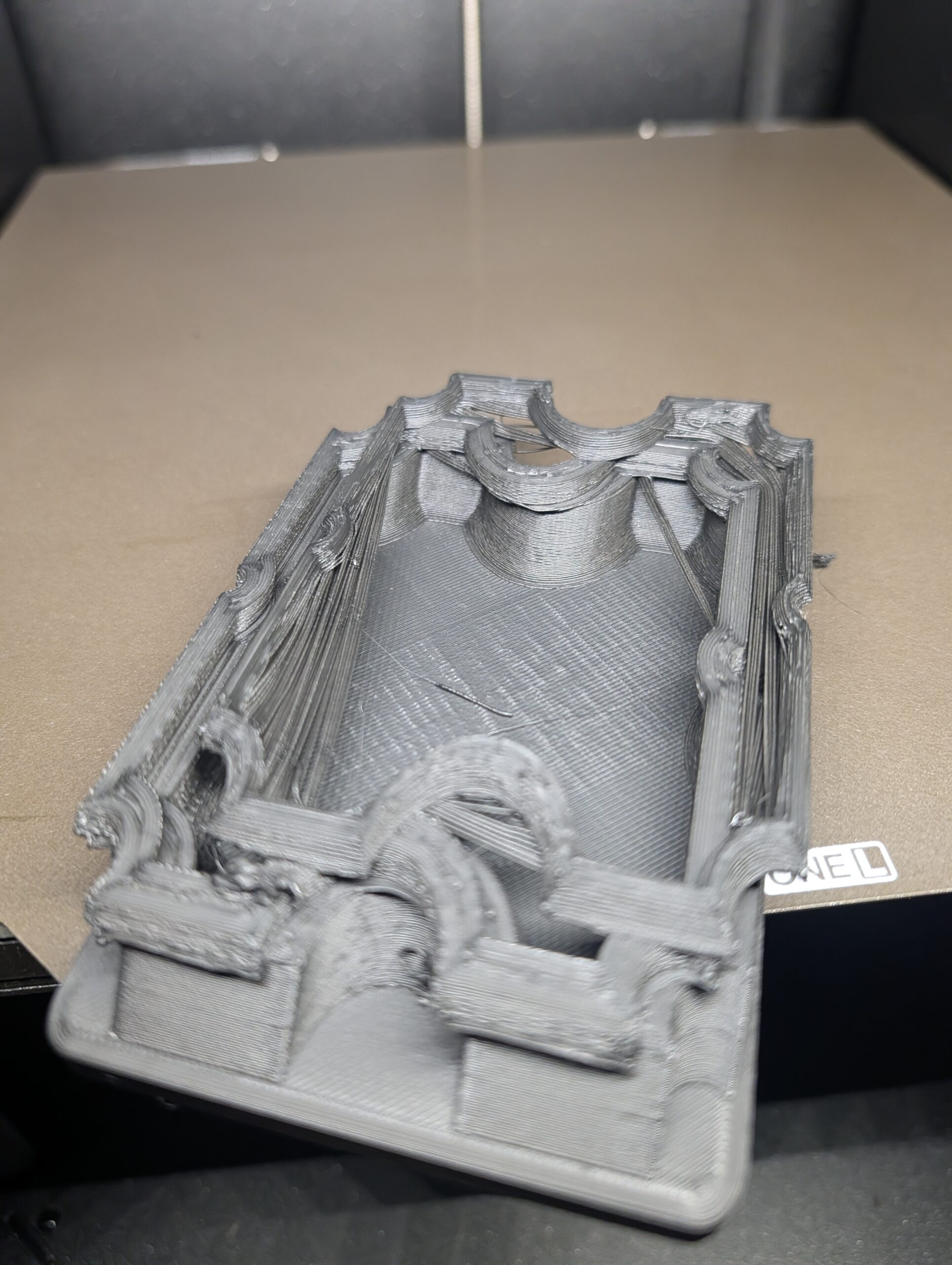

The printer is supposed to run daily for parts and jigs in our woodshop. I bought the Core One specifically because I want to design in Fusion and print parts quickly. However, it seems my Core One isn't printing as well out of the box as I expected. I admit I’m a little frustrated; I don’t want to spend time "tinkering"—I want to work and provide my employees with the parts they need just-in-time.

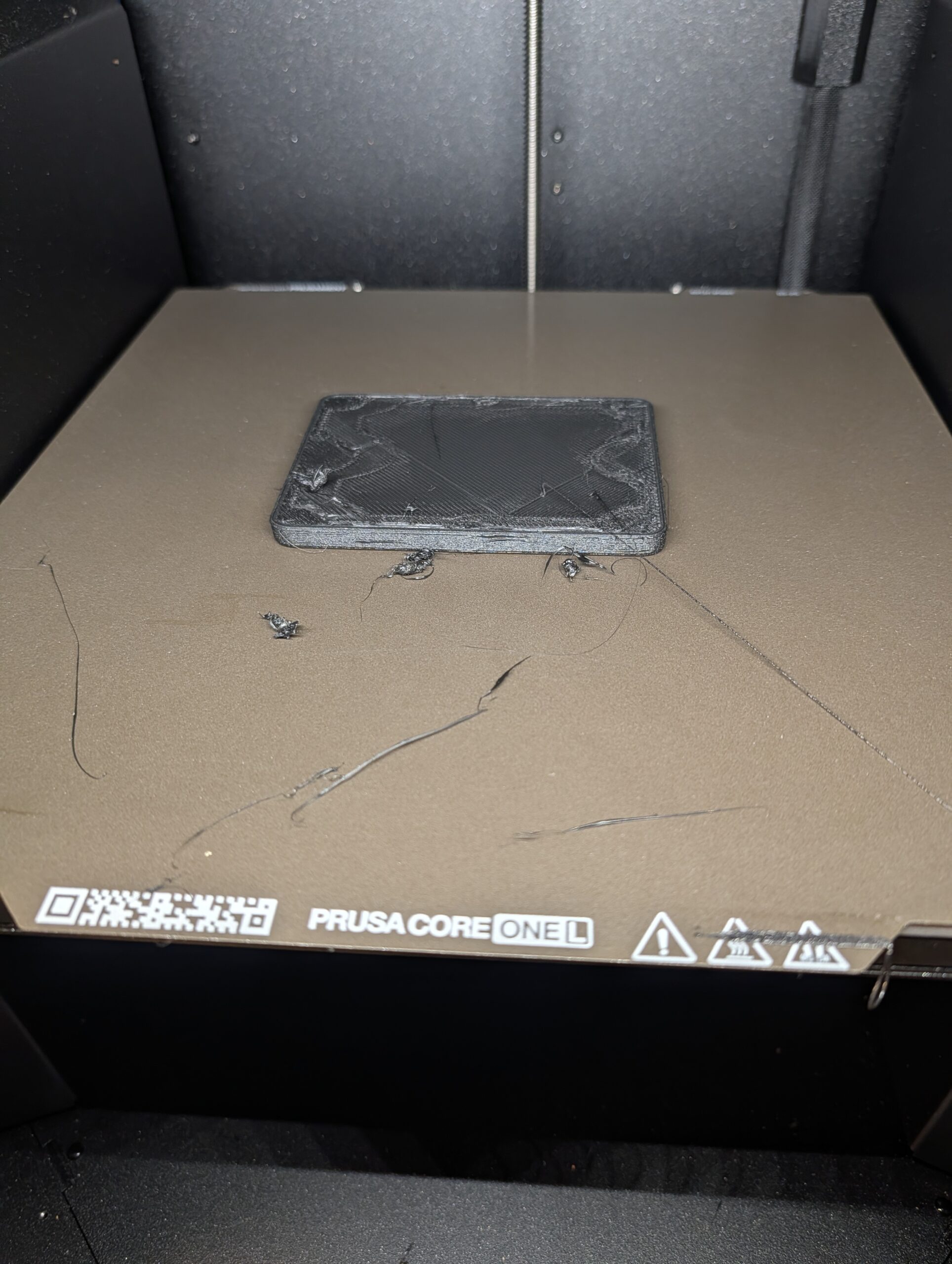

After some issues with large ASA parts (which were mostly geometry-related), my PETG prints are now failing as well. I’m using Prusament PETG right out of the box to print feet for a steel table. Here is what I’ve tried:
1st Attempt: 0.6mm nozzle, 0.32mm Structural profile (255/85°C), 4 perimeters, 6 bottom/4 top layers, 20% infill. Result: Huge layer shift at the top. No Foto
2nd Attempt: 0.6mm nozzle, 0.32mm Balanced profile (255/85°C), 2 perimeters, 4 bottom/5 top layers, 100% infill. Result: Nope
3rd Attempt: 0.6mm nozzle, 0.4mm Structural profile (265/85°C), 2 perimeters, 100% infill, reduced volumetric flow (10). Result: Also poor, canceled
4th Attempt: 0.6mm nozzle, 0.3mm Structural profile (265/85°C), 2 perimeters, 100% infill, reduced volumetric flow (10). Nope
5th Attempt: 0.6mm nozzle, 0.3mm Structural profile (265/85°C), 9 perimeters, 15% infill, reduced volumetric flow (10). Ok, but not
6th Attempt: (Tried standard parameters with a 0.4mm nozzle to rule out user error): 0.2mm Structural profile (255/85°C), 2 perimeters, 15% infill. Result: Severe layer shifting, canceled
Should I contact support directly? I invested a lot of money into a Prusa specifically because I need a reliable workhorse for my business. Any help would be appreciated.
PS: Actually it prints a perfect PLA print....

I also have a Mk3S that still prints flawlessly. The C1L, the print quality is better, but takes alot of tuning.
Z offset adjustment to ensure bed adhesion. -0.02. Peform a live z test, just like the Mk3
Do a temp tower
Disable chamber fans, warping, bed lifting. In filament set chamber nomial to 0. will stop the chamber fan from running.
Slower print speed, default profiles way too fast.
If you are using the HF, use a standard nozzle. I find the HF to be a gimmic. Quality vs speed. Your call.
Default PETG profile is crap.
Don't carry anything over from the Mk3S
See the PETG & Print Settings in the included zip
This actually might be your problem. Try drying the filament for 8hrs at 60° before printing. I never assume that filament is dry after removing it from even a factory vacuum sealed bag.

Problem solved! I have an amazing print quality with the same filament now.
Added your printer and your profile and it just works sooooo good. Now I have the quality that I've been expecting.
