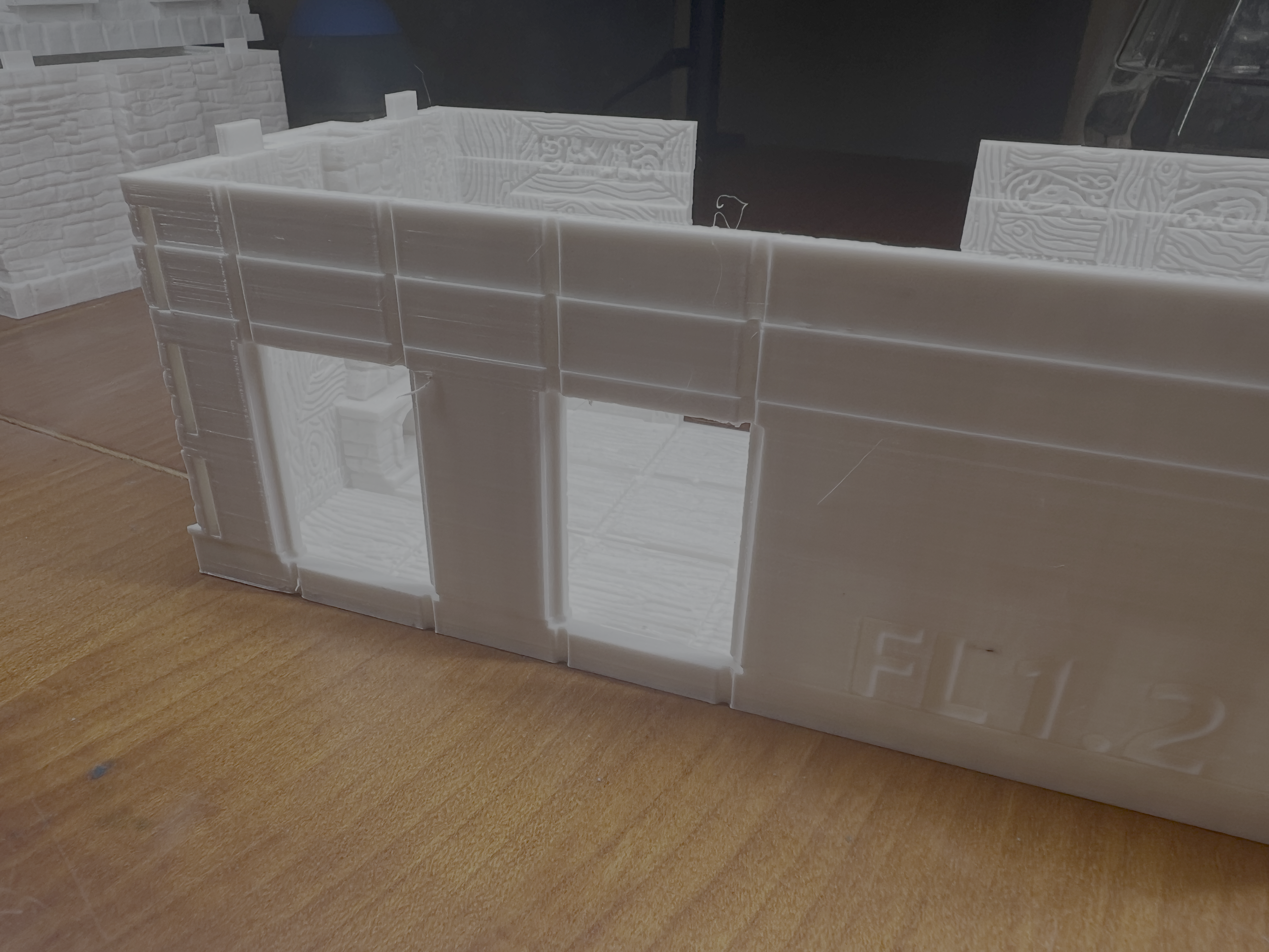

Hey,
My Prints experience very minimal Layer shifts. It's not consistent with any print profile or settings since I startet Working through a lot of options during the last Weeks with some prints coming out flawless and others having two to three of these shifts.
Any hints on next steps for troubleshooting are very appreciated.
I am experiencing 1-3 layer shifts during long 24h prints on my new Prusa Core One L. This happens in about 60% of my prints. The shift is a few millimeters and remains constant afterwards. In one instance, a support structure was hit/toppled and the Layer shift occurred afterward.
Setup & Material:
Printer: Prusa Core One L
Filament: Prusa PETG Signal White
Infill: 10% Gyroid / 15 % Gyroid
Environment: Enclosed, printer placed on a very stable base.
Steps already taken / Troubleshooting performed:
Mechanical Check: Both belts are tuned to 90 Hz
Gantry parallelism checked; X-axis is square to the frame.
Grub screws on motor pulleys are tight.
Slicer Adjustments (PrusaSlicer 2.8+):
Style: Switched from Organic to Snug and back to Organic
Support Stability: Enabled Support Brim
Z-Lift (Ramp): Increased Lift Height to 0.4 mm.
Ramp Angle: Increased Ramp Slope Angle from 1° to 5°
Avoid Crossing Perimeters: Disabled to simplify travel paths.
Firmware: Latest version installed.
Third print with layer shift on 24 hour print.
 Second print with layer shift on 24 hour print. First print with layer shift on 24 hour print.

First of all try to bump PrusaSlicer to at least 2.9.3, because in previous versions Avoid Crossing Perimeters + firmware for  core one was causing such issues.
If that does not help then 8 would check if you don' have wobbling in the nextruder and nozzle area.
Also cables - sometimes cables without ferrite filters can cause issues that propagate to another motors.

The collision with the support structure is a lead, but why?
Does the print detach from the print sheet at a corner, or otherwise warp, causing movement in Z that results in collision with the nozzle? This happens frequently at overhangs that curl up while cooling. But this should be less of an issue with PETG.
A time lapse video might give some insights.
Severe overextrusion could cause the nozzle to get stuck in the print, unlikely though.
Can you double-check that the print sheet will not slide on the bed e.g. because of debris in-between? The layer shifts I've seen from motors skipping steps were nowhere near as subtle. If the print sheet slides too easily, I could imagine some hair spray, glue stick etc. on the bottom side would help to make it more robust.

The sheet is not moving or warping. The last print was fine until the last 2 hours. While it always sucks to loose that much time and resources I might have figured it out. Thanks for all the help so far.
I suspect the root cause is filament accumulation on the nozzle. This starts when a support structure fails or partly fails due to the filament not connecting. The extruded PETG then sticks to the nozzle exterior or parts of the print, eventually growing into a blob that causes some stringing or debris in various quantities and sometime a mechanical collision and the subsequent layer shift. At least that's the working theory.
I will print the model with snug reinforced supports and limit them as much as possible. I will pauses to the print at certain intervals and clean the nozzle manually. Will have to add a silicone brush for automatic nozzle cleaning later if I am on the right track. might tweak some extrusion setting also but I am very happy with the print quality and wouldn't like to loose any of that just due to random blobs.

Update on my previous issue: Unfortunately, the adjustments (Snug supports, manual nozzle cleaning in intervals) did not solve the problem. In my latest print I had one Layer Delamination for the first time and again two supports failed while all of them where showing since of poor quality.
Support Failure: Even with Snug settings, supports collapsed. As suspected, once a support failed, the nozzle started collecting "spaghetti" filament. This formed a blob on the heater block, which eventually caused a mechanical collision and a layer shift.
It seems the default "Prusament PETG" profile on the Core One L might be pushing the material too fast or cooling it too aggressively for this specific geometry, leading to brittle supports and poor adhesion.

I have solved some of my issues while getting some new ones. First tweaking the nozzle temperature overall improved the prints at 0.2mm. Not going back to 0.16mm Layer hight for now. The Supports went form almost total failures to easily removable solid structures.
Now there seems to be an issue with narrow or slim structures. Like the vertical struts on this handrail. That printed well before and doesn't now. Also the struts inside the windows. I know it's possible to put a box around a specific part of the model and have it printed with different settings. im ist not sure what the problem is is here? Layer adhesion due to cooling? Printing speed? Thank for any help!
