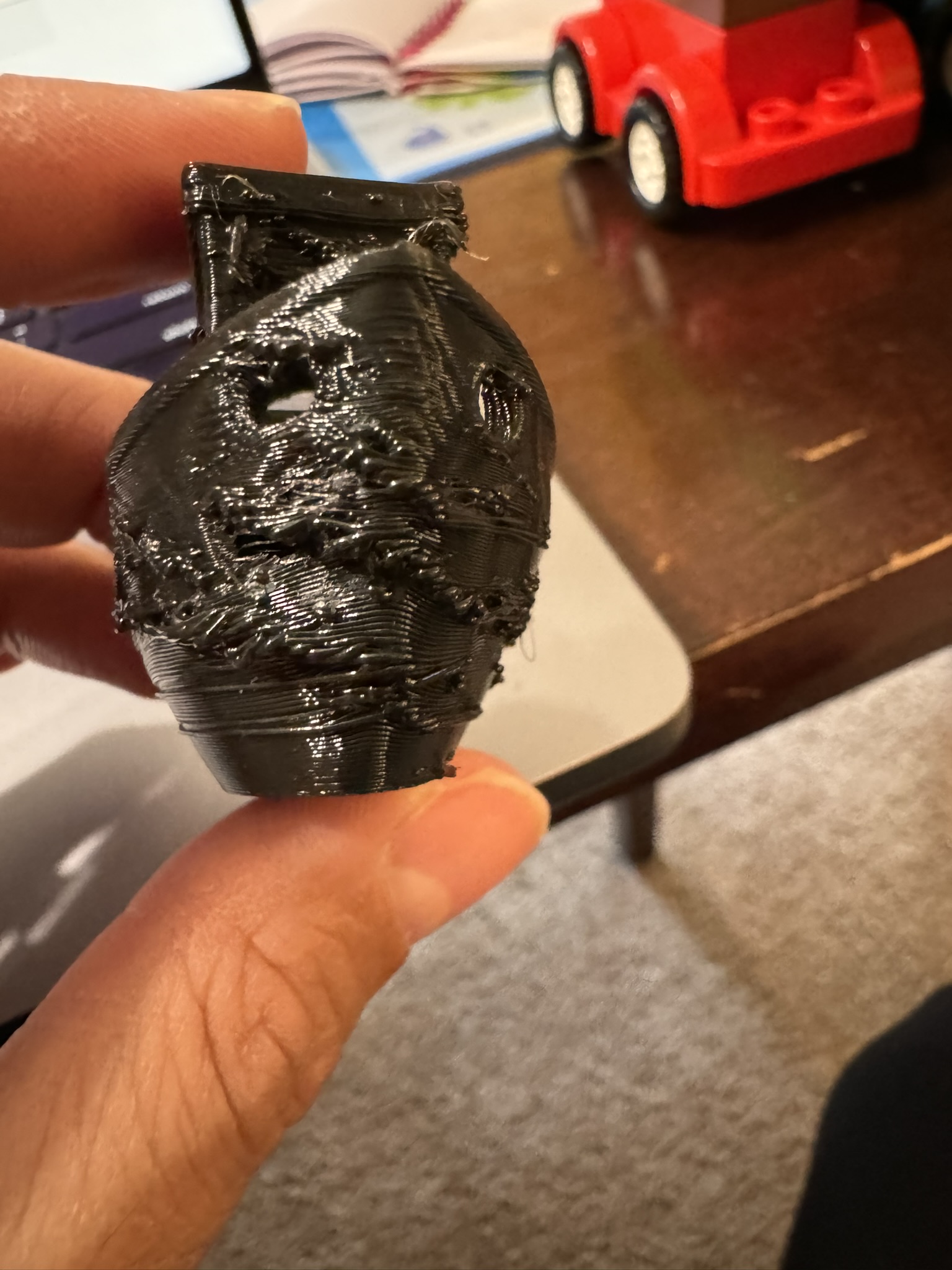

Were you able to print a benchy with the stock Ninjaflex preset? Mine completed but had severe deformations around the bow below the portholes.

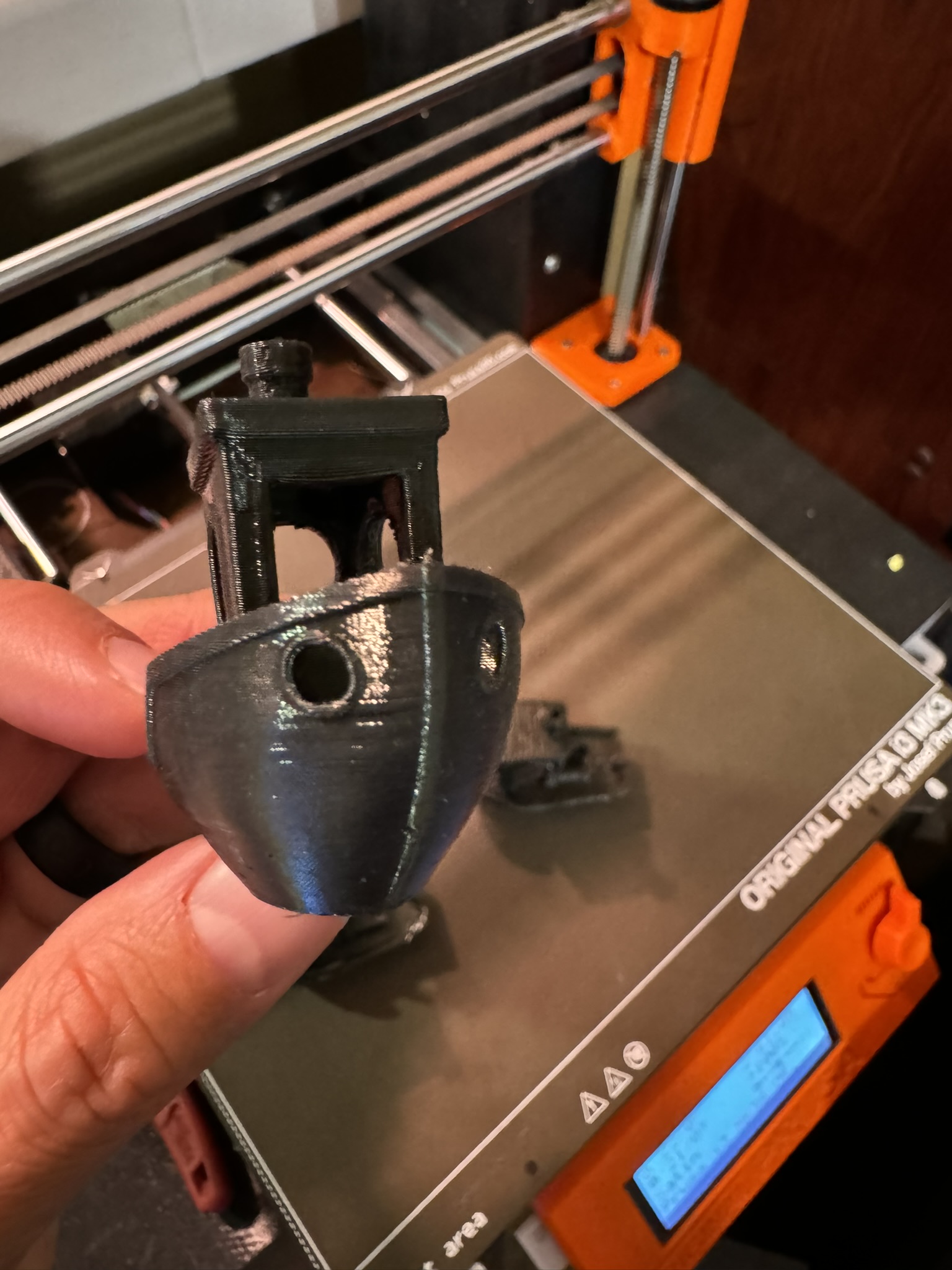

Ninjaflex is tricky but I have gotten a basically perfect benchy from my MK3S.
My frustration is that the Nextruder gears do a MUCH better job of not letting the Ninjaflex jam up, which is the source of all my Ninjaflex failures on the MK3. So the XL (and probably the MK4) would be perfect if I could get it dialed in.
I've tried making the stock Ninjaflex profile look more like what I have for the MK3 but I can't seem to get it right. I've tried drying the filament for days and still nothing. If anyone has a perfect benchy from the XL with stock settings it would eliminate a lot of factors.

This is what I was getting yesterday when I tried it.  sorry was waiting for icloud photos to sync to pc.  This was with the stock ninjaflex profile for xl.  which is 238 first layer, 230 every other layer.   it was printing beautifully and then as you would expect it started curling on those edges.  not sure how eliminate that.   But it shows that 230 does work for all those layers.

The curling might happen if the model is too unstable - what you could do is either print stabilization layers from time to time (petg or pctg fuses great with any tpu) or you could paint some support trees with a material which doesn‘t fuse well…

I think the point @pumpkinslice was trying to make is that on the MK3S you could do this without supports.   And I know that I've done it.  Here's a picture of one I did over a year ago on one of my MK3S printers before I upgraded them to MK4s this year.   This was done without supports.   To be honest I've not tried to replicate this on the MK4 yet.   The benchy in this picture was done with literally the exact same spool as the one that curled above.
