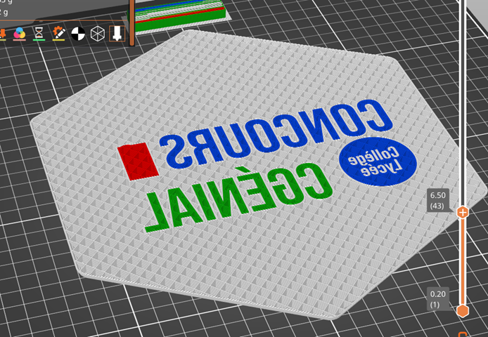

Hello
I'm trying to print a multimaterial project.
I draw it with openscad all the colors inserts have the same deep in the big white part.
screeshot project
the 3MF project is here : https://uncloud.univ-nantes.fr/index.php/s/2eoetgGxZe66APM
But when I slice, only the blus is deep in the white part. others colors have desapears.
sliced
What is the problem ?

RE: Strange multimaterial slicing
this is probably a matter of extruder order and the way that you arrange the colours.
If you cut the coloured elements out of the base white section, and then insert the coloured elements, I suspect that your colours would print as expected, however if the colour elements are overlaid on the white area as mesh modifiers, then the order of the colours will define whether they are displayed.
Drag the blanc part to the top of the list.
Posted : 17/02/2026 4:59 pm
or change the red, Blue and Green parts to 'Modifiers'
Please be aware that the order of modifiers is important when modifier parts are on top of each other.
in the image above, the Yellow, Grey, Blue and Black sections are all modifier stl's,  on top of the Blank red lid. if the order in which they are set up, is incorrect, some of the features will disappear!
