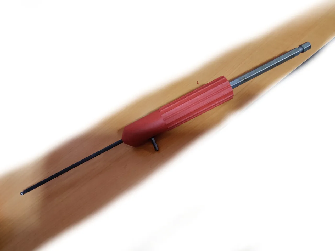

SvobodaT
(@svobodat)
RE: Dock fixing bolt - Becoming loose
Plus the single screw holding the dock(s) was very difficult to tighten properly through the long hole. I even made a tool for that:
https://www.printables.com/model/915686-prusa-xl-assembly-helper
Posted by: @fs5
I also thought it was odd when assembling to only have one screw holding the entire nextruder assembly to the frame.
Posted : 21/11/2024 3:32 pm
