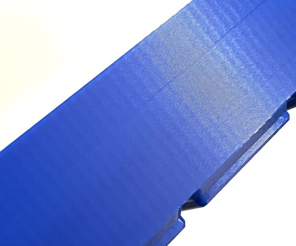

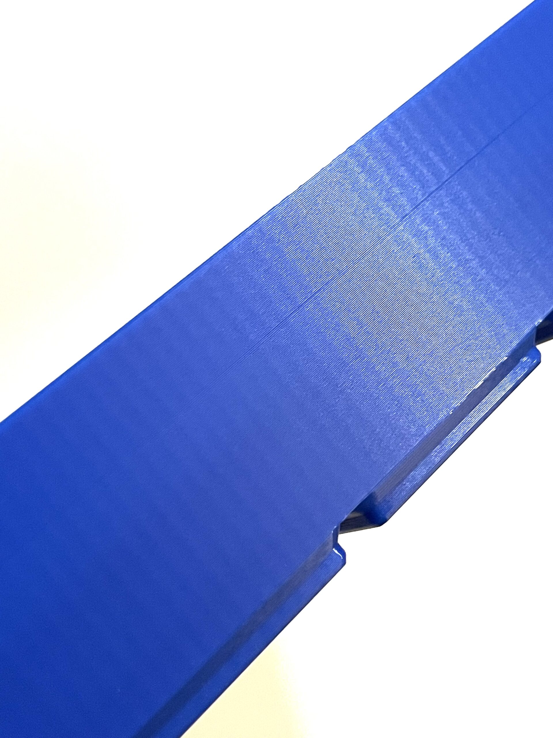

I printed a large part and placed it diagonally on the bed as it would only fit corner to corner. Ended up with wavy walls from what I think is the belts based on the pattern. Anyone else experienced this?

Yes, on the MK3S+ in x- or y one can observe the same pattern. That is exactly the tooth pitch of both gt2 belts. At a core-xy it is at  an angle of 45 degrees instead.

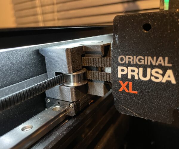

Looking at the belt paths all the smooth idlers have the belt smooth side to them except these, where the teeth are against the smooth face. I believe this is the cause of the ripples I see. It’s the same as the Bambu X1C printers. Why can’t this be a toothed idler?

RE: Uneven/wavy walls. Caused by belts on idlers?
Good question. Since it it the same on the MK3S which has been out in the wild for years, perhaps you can find in that forum area posts telling the experience from users who have changed their idlers (x or/and y) into toothed ones. I have not looked for this topic so far.
