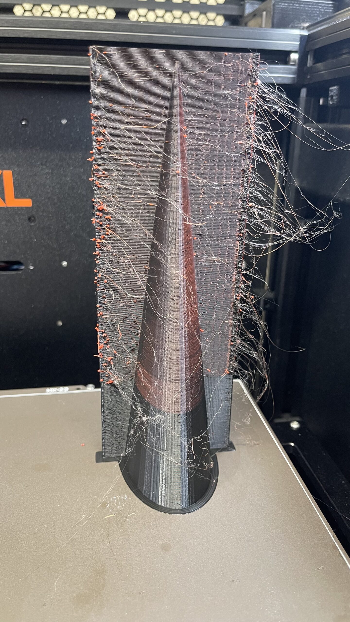

1. Lower the material temperatures. PLA should fuse fine at 200c. PLA goes from solid to liquid very quickly (like ice to water). As such you don’t want to be so hot that it takes too long to solidify or to melt.
2. In print settings view, extruders, each extruder has a “Retraction on tool disable” setting this setting retracts the material from the nozzle tip right before the tool leaves the print and travels to the parking place. I set mine to 11.2mm. The idea is to pull the material up and above the melt zone while it’s parked. If it works correctly the suction will pull it all up and it won’t drool down on to the nozzle sealer. No string.
thats it. No need for any added gcode. And I turn off the prime tower. I also turn on the setting to start from infill just in case sone material did not get pulled all the way up so that any gap or blob is off the surface.

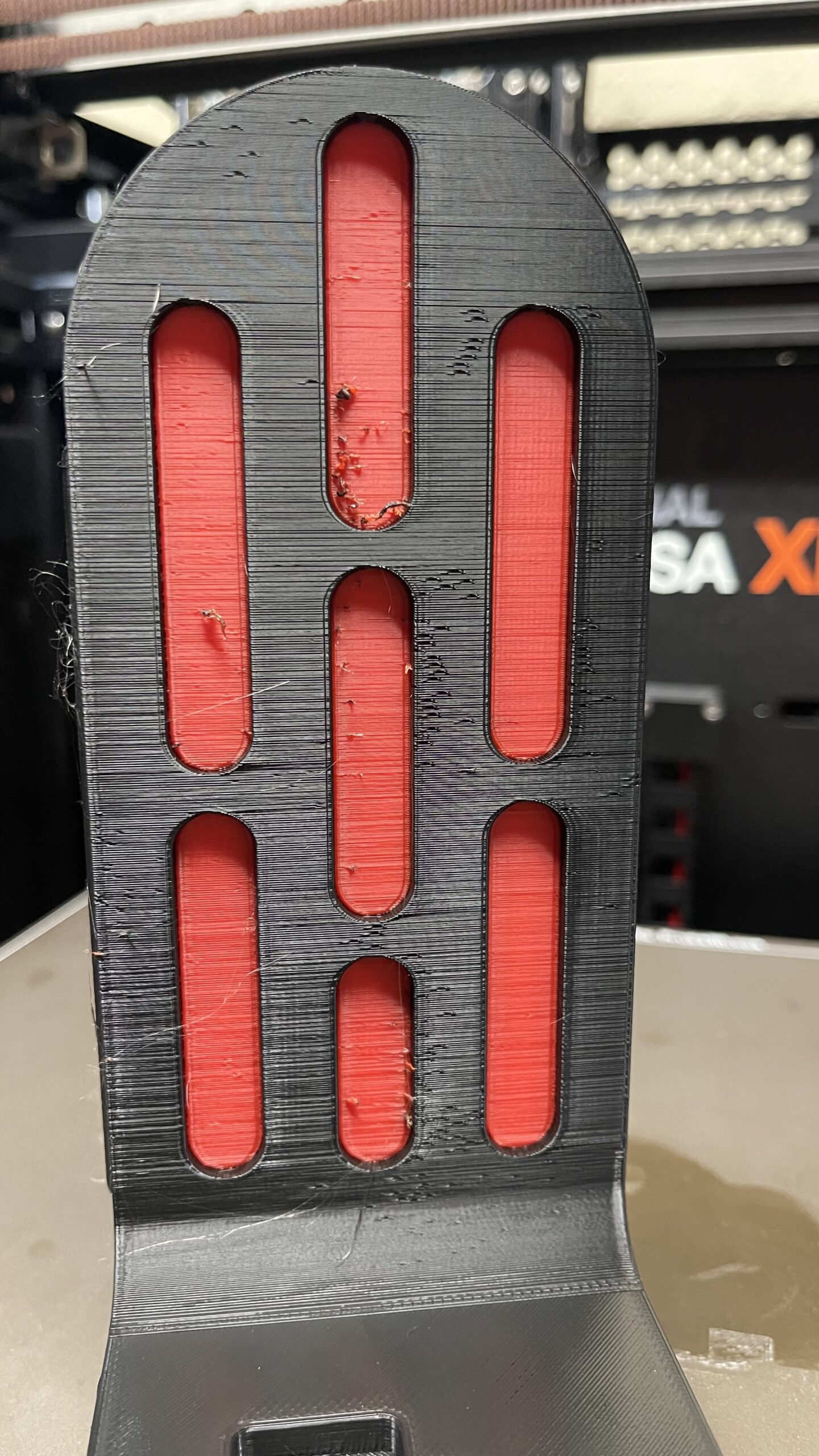

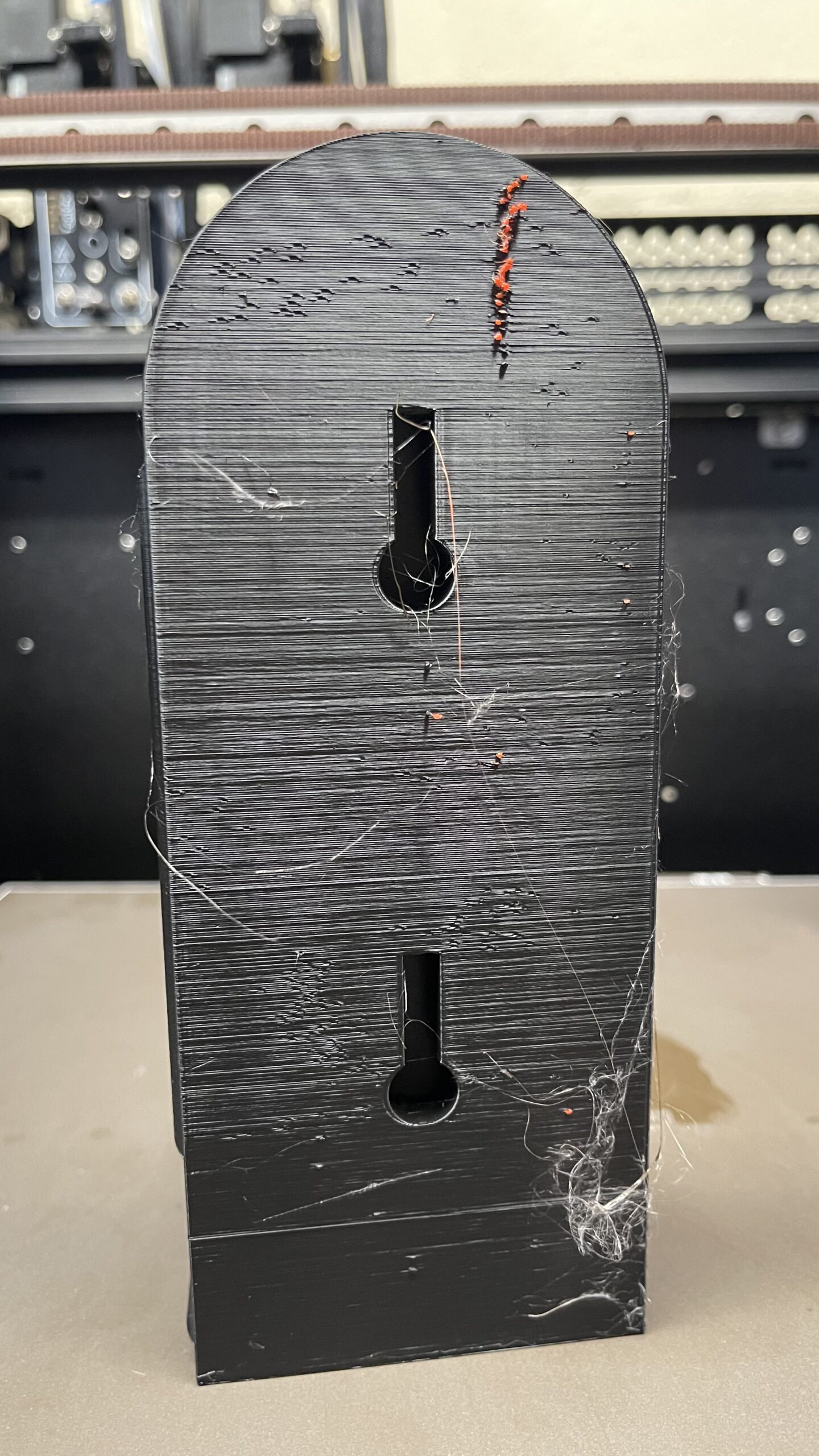

@Tobycwood, The 3D print dogs approach seems to be pretty helpful (for me).  It improved substantially the number of hairs to clean up.  Could be the model, but for me that alone did a LOT.
Just tried a no tower print and it's looking nice so far!One Tiny Little Hair by the eye.  PETg @ 230c, 10mm parked retraction. 3D print dogs.. No infill on this one.  Saving some plastic:
Printing the head with no infill, no tower:
The whole model.  The 1/2 head there is from a previous attempt with tower, had a big layer shift no idea what caused it.. First of that type of error so far:
If all goes well It'll be at a FLL tournament this weekend where the kids will get to name it.
