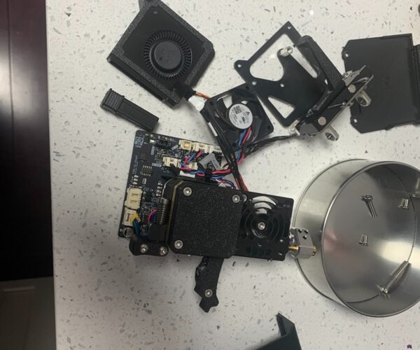

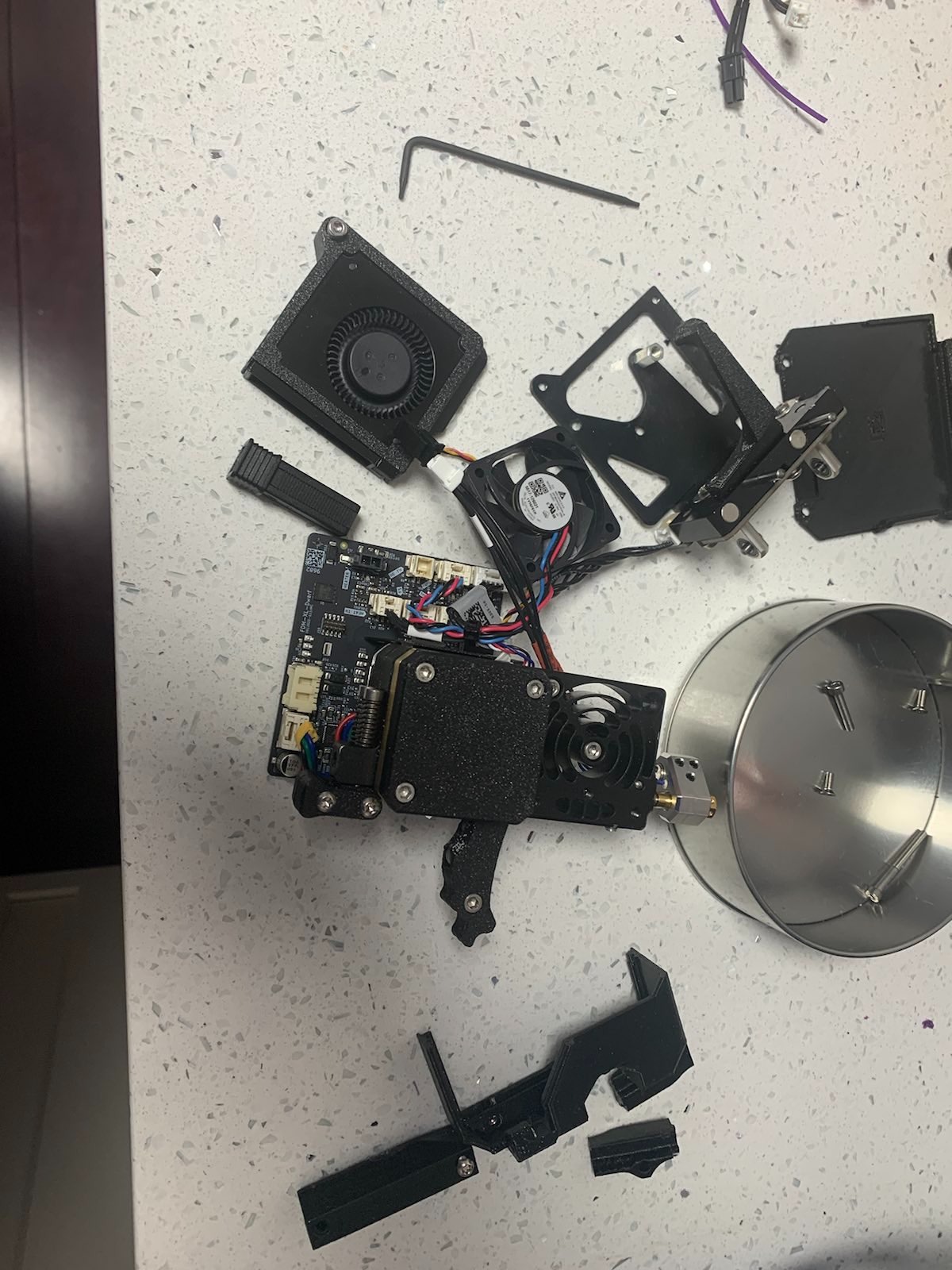

I had a catastrophic print failure and my extruder got all blobbed up with plastic. To remove the blob I had to unplug the heater and thermistor, and disassemble the extruder. I now have my replacement parts and want to put it back together.  I see the docs for attaching the extruder to the machine, but don't see the docs for assembling the extruder itself. I'd rather follow some steps than try to wing it.

i was looking for instructions as well and it looks like they have not published them.
i used the mk4 as a guide and looking at the the other 4 extruders i have
https://help.prusa3d.com/guide/5-nextruder-assembly_434014
on my pre-assembled extruders i found issues. extra hardware that fell inside during assembly, loose screws, junk stuck to the magnets.
when my machine failed the initial fan tests that was when i went in and started to take apart the extruders and see what was going on.
