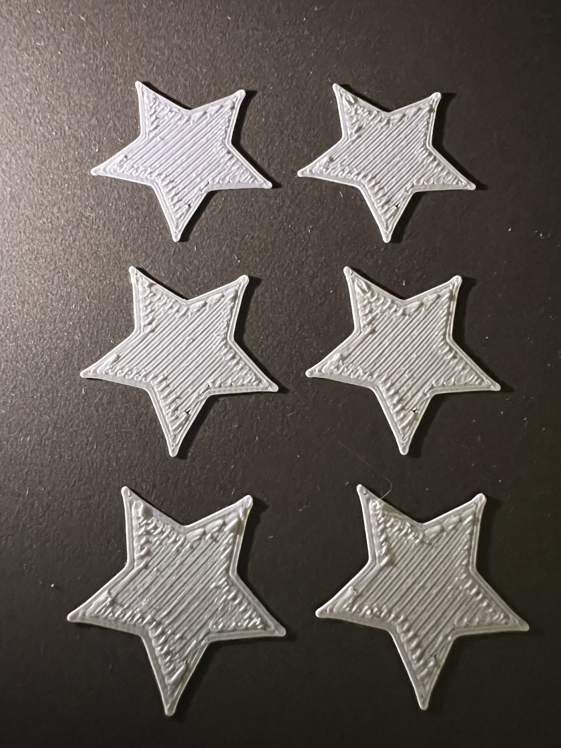

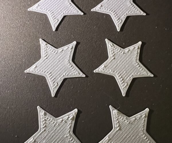

Material buildup at edges (direction reversals)
MK4S/MMU3, PLA
using default settings, a one layer full bed size print looks really good, except for the edges.  You can see the same affect in the single layer stars.
What setting changes are most likely to improve my results?

Do other slicers do the same thing with the same settings? Posting your settings would help. However, it might not be a slicer issue. Printer settings like speed, jerk, acceleration, temp. It is more pronounced on shorter runs, so i am thinking acceleration and jerk settings in the software. You might want to post those also.

I only use PrusaSlicer, and I am running the current version 2.9.4.  I am running FW 6.2.6 because of known issues with 6.4.0.  I am using the Prusa 0.2mm SPEED profile with a 0.4mm nozzle.  I have not tweaked any speed, jerk or accel settings.
I played around with the Pressure Advance last night.  When I set it very high (0.100), the buildup was significantly improved, but now I see pin holes around the junction of the inner perimiter and the infill.
I had previously run the Pressure Advance Calibration (the one that generates gcode of parallel lines with speed changes) and it looked like 0.055 was the best choice.  That is the setting I had used to generate the print in the original picture.

To me, this looks like overextrusion.
I'd try to calibrate the extrusion multiplier as described in this Prusa help article:
https://help.prusa3d.com/article/extrusion-multiplier-calibration_2257

You changed the filament diameter from 1.75mm to 1.72mm but left the extrusion multiplier at 1.00.
Did you maybe adjust the wrong field? This would lead to the inverse result (lower diameter -> more filament must be extruded to get the same volume -> Overextrusion)
When printing with your settings, I too see some overextrusion, with generic PLA settings, it prints perfect (MK4S with HF nozzle)

When I had started my repeat tuning, my multiplier was 0.95.  I kept that as a starting point but changed the filament to .172 after measuring it.  I then performed extrusion calibration and came back to 1.0 after measuring the calibration cube wall thicknesses (vase mode).  The wall thickness was 0.042 instead of 0.045, s0 roughly 7 percent under extruded.  The calculated multiplier would have been 1.017, but I chose 1.0 as my next test.  This should have resulted in slight under extrusion of the star, but the results appeared to still show over-extrusion.
scratching my head…

The only idea I have left is to try printing it with the Generic PLA setting and unmodified Print(er) settings.
Atleast I already "miscalibrated" filaments and the easiest is to just start fresh.
If you have other filament, maybe also print the model with that to determine if the issue is the filament or the printer.
