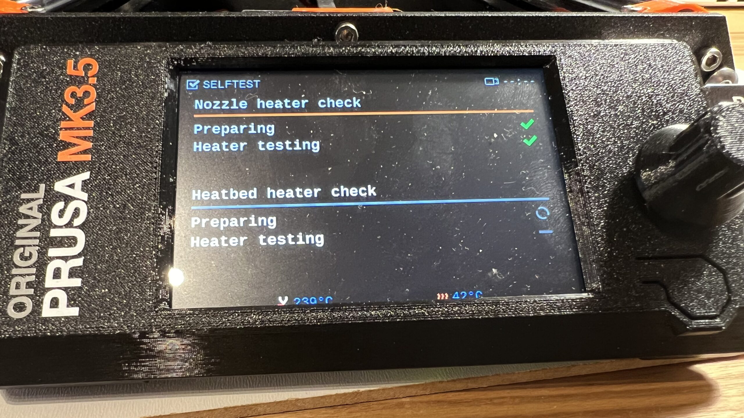

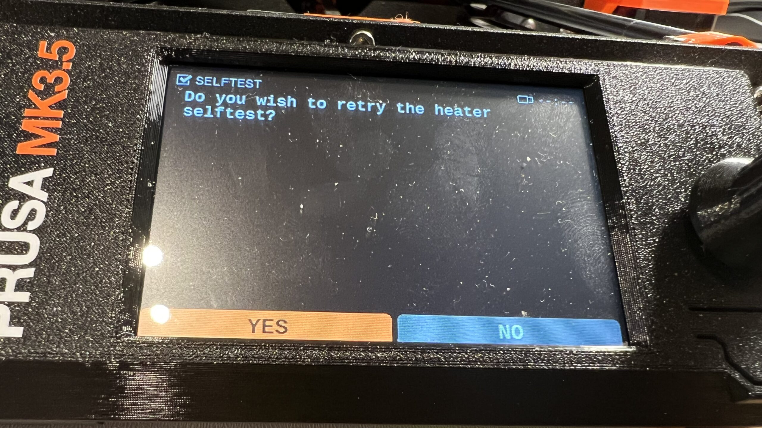

Revo 6 IS SUPPORTED in fw 6.0.0
After first heating calibration there was a failure and then appears screen to choose different nozzle. Then heating calibration was OK.

Unfortunately PRUSA confimed today that only the REVO 40W heater cartridge is supported. 😣
If you purchased the REVO 60W thinking that it will help the hi-flow and MK3.5 higher speed, than good luck... and hope than PRUSA will implement it in the FW.
They have no idea of  time plans, but the using the 60W does not pass the initial test check.
They suggested to use the 40W if I want to use the printer 😑
So today I removed the Revo 60W heater and replaced it with my old Revo 40W and it works well.
However I hope to have the 60W supported soon in order to fully appreciate the high flow.
