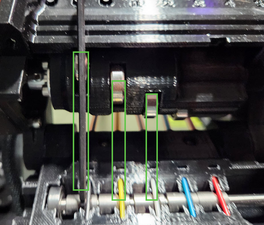

I was having a similar problem with filament not loading.  On closer inspection I found that the bearings were not lining up with the filament.  So, I loosened the grub screws on the selector and lined them up, using an Allen wrench to ensure alignment, the problem went away after the adjustment.  See photos.  This was an MMU2 upgrade, there is a lot of play, and the bearings are not as wide as the groove for the filament.  As long as the bearing touches some of the filament, it looks to be fine.
