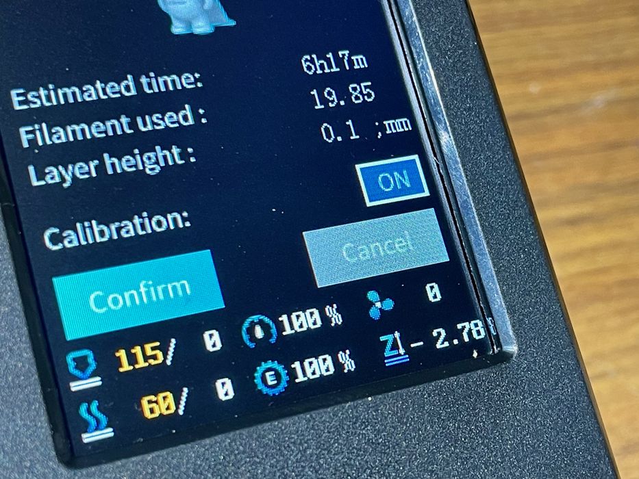

Thanks for an answer! So, first things first.
What I'm trying to achieve exactly is for my machine to display estimated print time/filament used/layer height in preview menu. The estimated priting time works correctly once I start printing, its just 0 on the preview. This works when gcode comes from cura, doesn't when it comes from prusa slicer. Like this:
After slicing in Prusa all these values are 0. So what I did is I compared the gcodes from Cura and Prusa, and noticed that there is metadata attatched in cura one - which I assumed is used by my machine to display these:

Just to confirm, I pasted this header into some gcode file:
;FLAVOR:Marlin
;TIME:7036
;Filament used: 1.20047m
;Layer height: 0.12
;MINX:86.48
;MINY:83.008
;MINZ:0.12
;MAXX:140.087
;MAXY:133.43
;MAXZ:34.68
;TARGET_MACHINE.NAME:Creality Ender-3 V3 SE
And it displayed the preview values correctly (even though it doesn't represent the real file times):

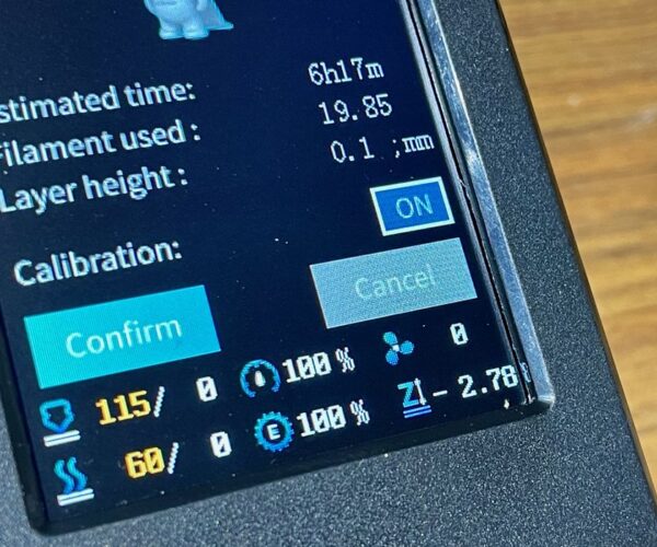

Comparing to other cura-generated gcode there's only some weird padding issues, not sure why is that. Cura example:
What I'm trying to achieve is to generate the second preview info automatically when slicing in Prusa. Attatching both files for reference: https://we.tl/t-IGb69flHKB
