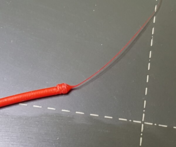

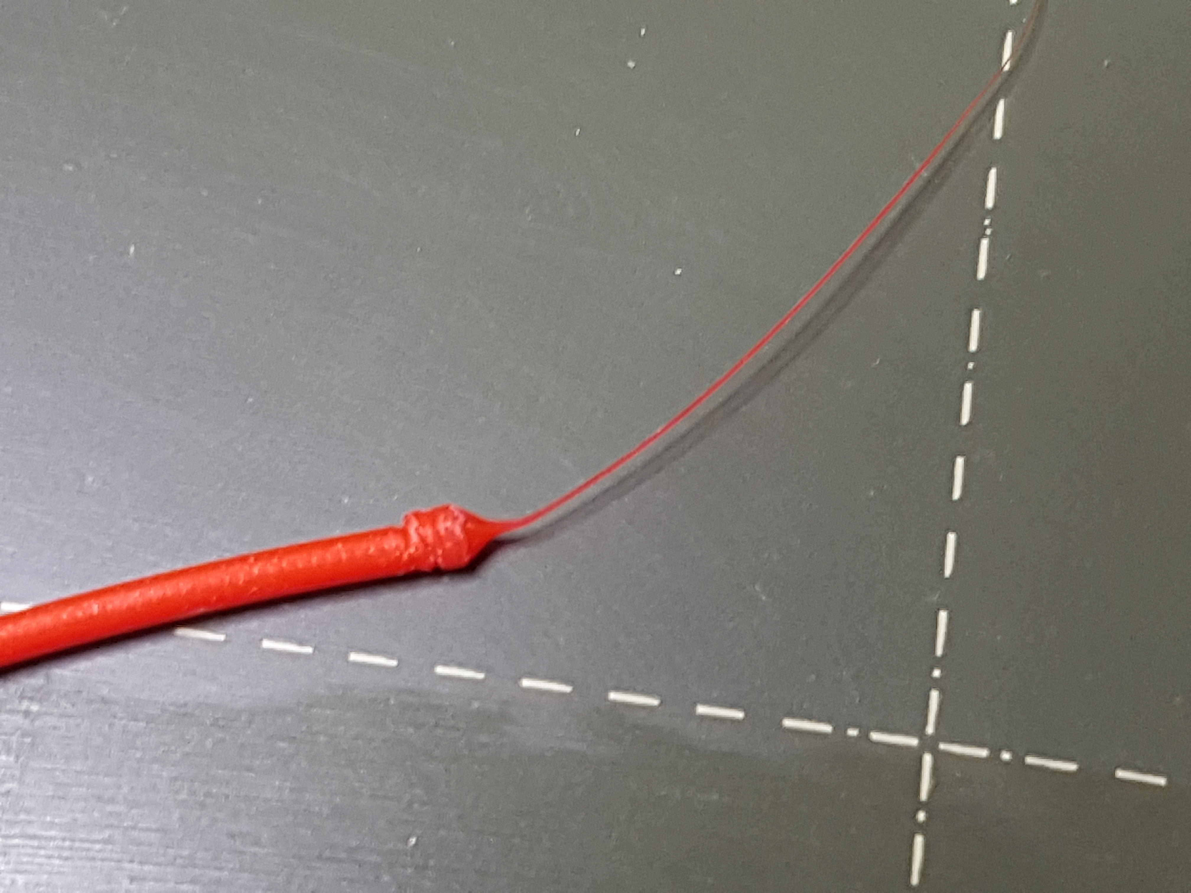

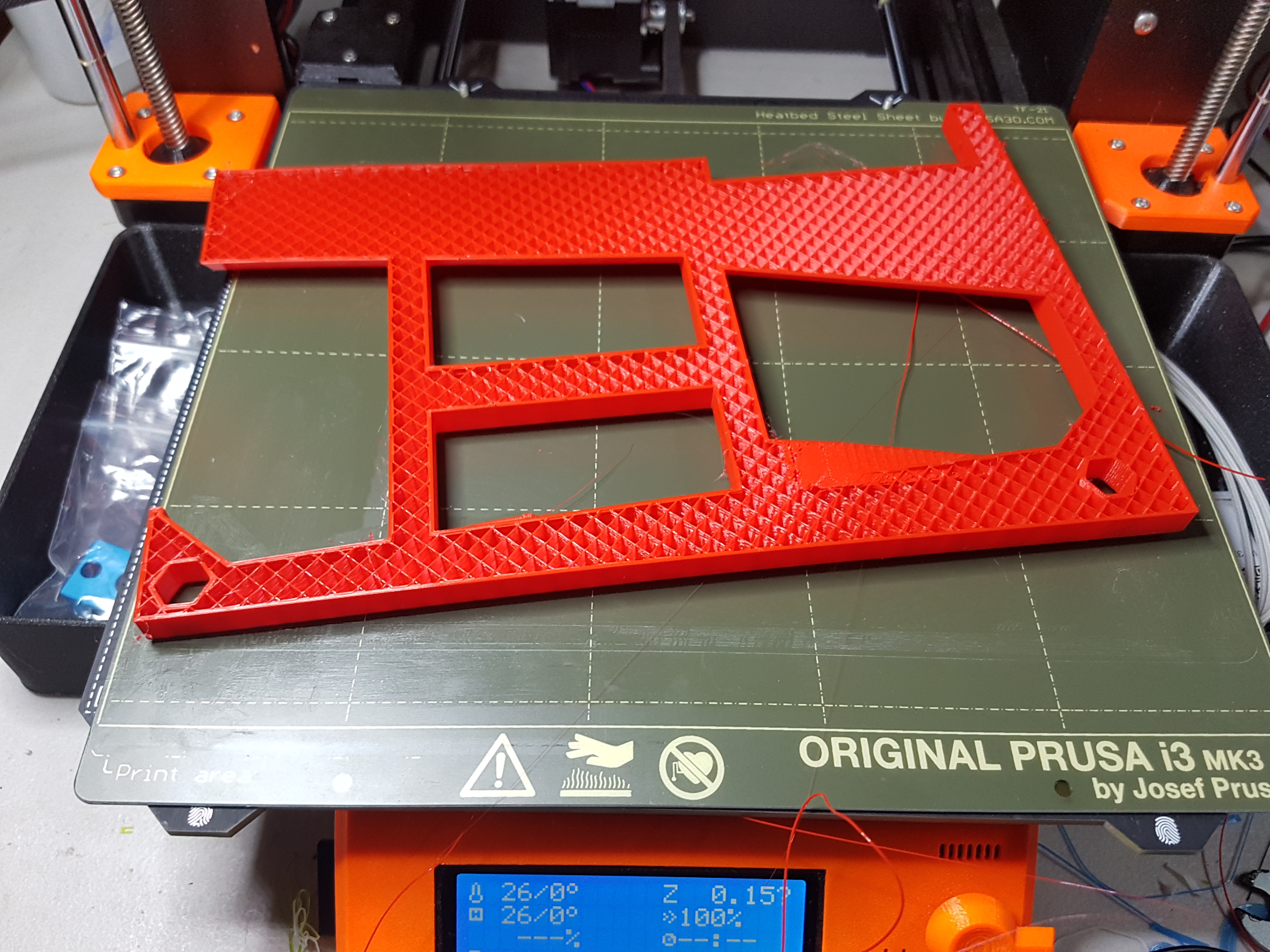

RE: PRUSA edition heat break easily jam/clog with PLA
I am about to upgrade my heatbrake from Prusa to E3d on my December 2019 Prusa.
Attached photos show the problem I am having on the standard Prusa-ifed heatbrake:

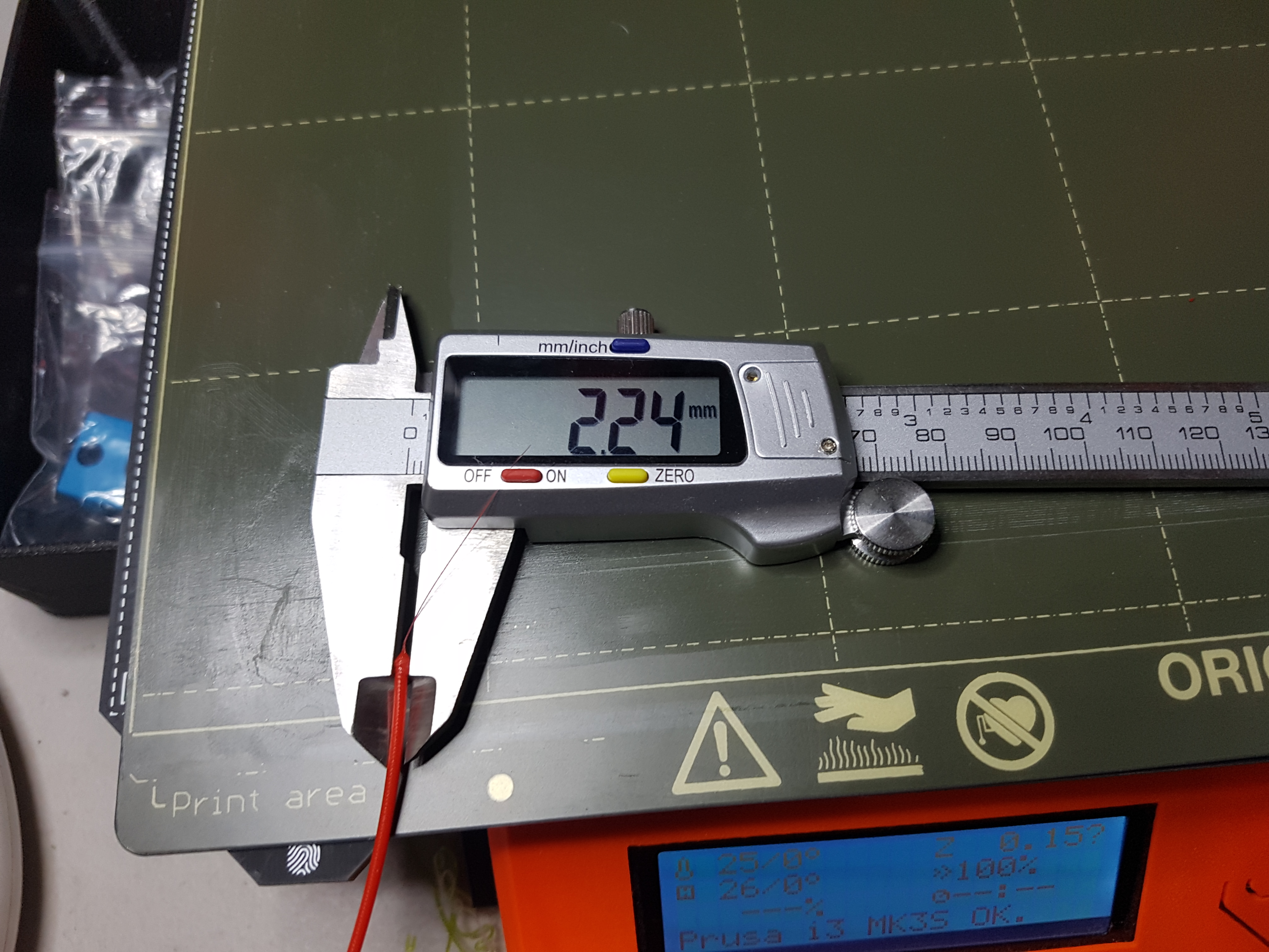

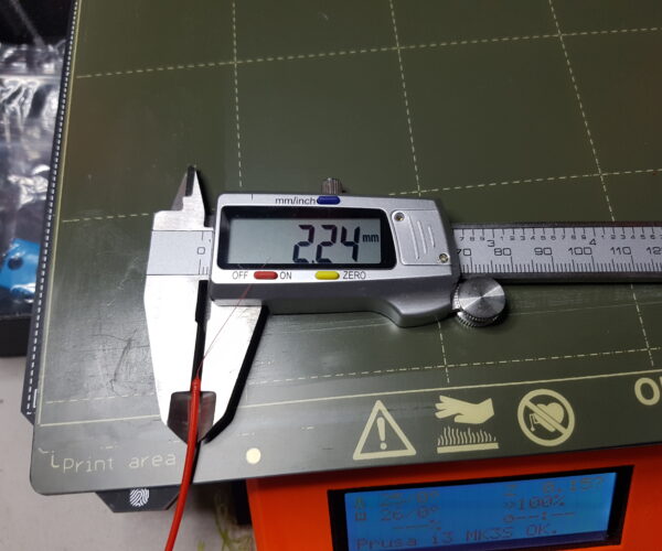

The 8 hour print failed about half way through because the PLA was melted into a 2.2mm blob in the cold part of the heatbrake and 2.2mm cold PLA won't fit into a 2.0mm metal tube.
Calipers showing the failure is because the melted PLA was 2.2mm wide. The point at which the PLA was melted and stuck in the heatbrake An eight hour print that failed on a retraction after many hours.
Posted : 05/11/2020 8:31 am
I also ran an extruder fan for the 8 hour print, which previous tests shows that the E-Axis motor is only a about 6 degrees above ambient when I run this fan.

It looks like replacing with the E3D heat brake has solved my problem.
After installing the E3D heat brake, I have started printing using the same filament and gcode that would clog previously. It has run for 30 minutes on a 0.07mm layer minature figure and not a single click from the Extruder.
Yep, even on a model with hundreds of retractions at 0.05mm I have not issues now. Not in 12 months of owning this printer have I been able to do that.
