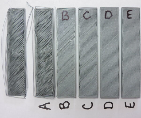

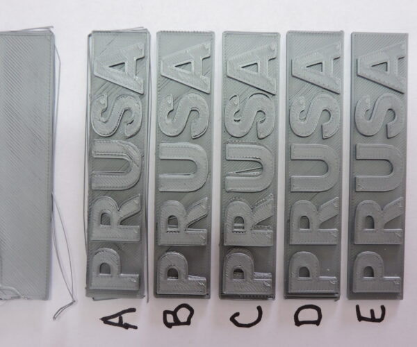

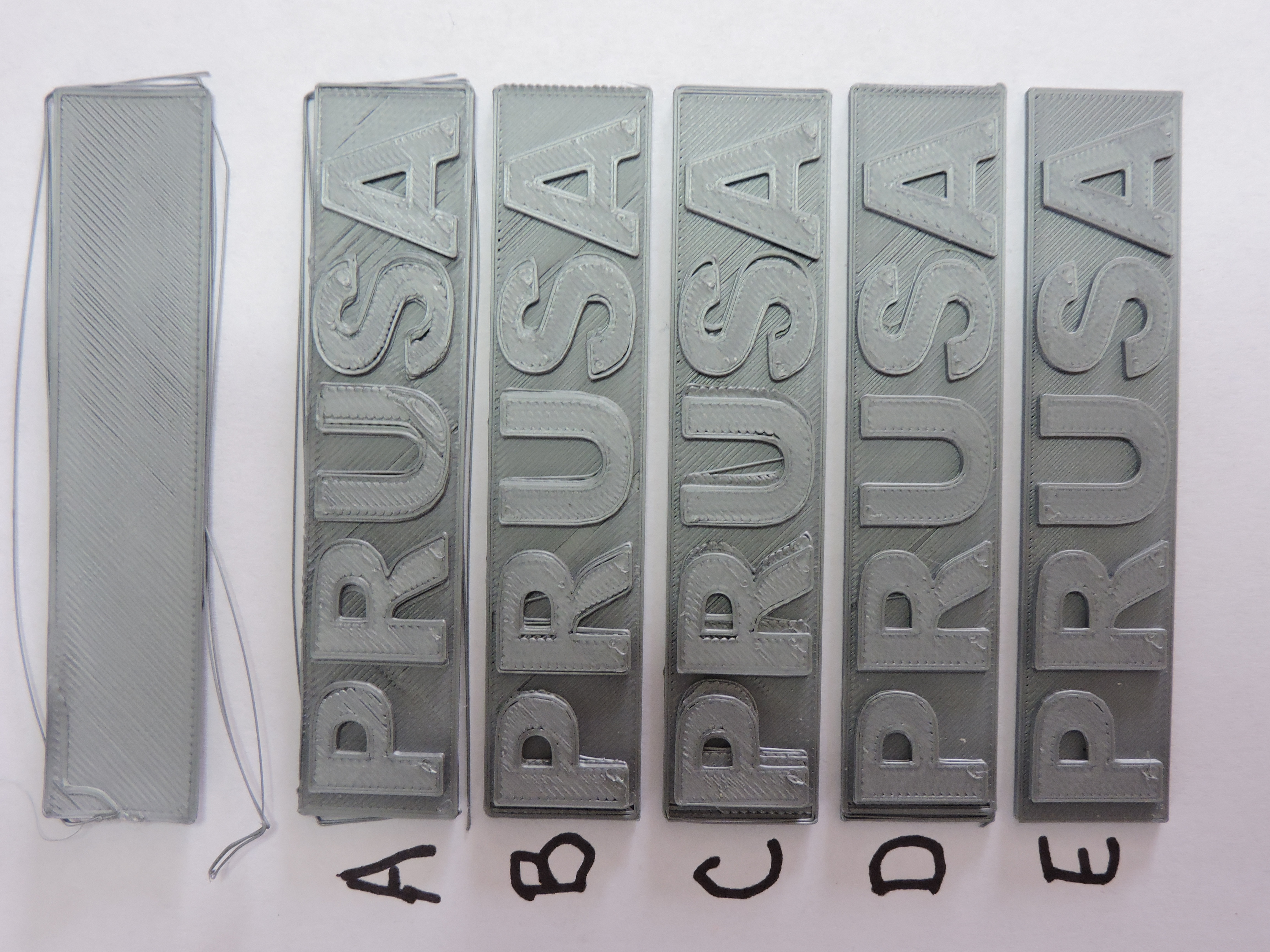

This issue is now resolved.  I believe it is important to participate in this forum by reporting here the diagnostic steps to arrive at a reliable and permanent solution.
Summary:
Anomalie :
Started the Calibration Wizard.  Self-Test completed successfully.  XYZ Calibration failed at the end of the first round (end of 4 sensors points detection phase).  Error is "XYZ calibration failed. Bed calibration point was not found. See manual."
Solution :
Tighten the gear screws on the X-axis belt motor shaft.
Details :
Note 1 : I assume you read my very first message on this post.  The following is complementary to this first post.
Note 2 : Two pictures accompany this solution.  The first shows the front sides of print results for each diagnostic step.  The second picture is the back sides.  Please, refer to those pictures.
First of all, you should know that after assembling the printer, the very first use of the “Calibration – Wizard” function was completed without any problem.  I launched a first impression of the «Prusia» logo.
The top test (without a letter) represents the very first impression of the Prusia I3 MKS. You must know that I did not make any Z axis first layer adjustment prior to that first print.  (I know, that is crazy, but it is what it is!)  So the Prusia logo took off from the surface.  I pressed the emergency stop button.  It is from this moment that the XYZ calibration refuses to complete itself, ending after the fourth detection of detection points.
Several calibration tests show that the PINTA detector still manages to position itself on each point.  So I decide to ignore this calibration, to perform the calibration of the first layer, and to launch another «Prusia» logo print, just to see what happens.
“A” Print: First layer Z adjustment set to -0.750
-              Marked improvement, poor quality.
-              The observation on the back shows that the Z adjustment is not sufficient.
-              Slight shifts of the layers on the X-axis.
“B” Print: First layer Z adjustment set to -0. 985
-              Marked improvement, poor quality..
-              Slight shifts of the layers on the X-axis, especially when filling the base of the logo.
-              The reverse side shows a better adhesion of the first layer, but presents incomprehensible offsets on the X-axis.
“C” Print : tightened by half a turn, the filament idle gear tension screw.  I also adjusted the height of the first layer to -1,000.
-              This is the worst result so far, but I think it’s only circumstantial; the last adjustments are certainly in question to create this excessive offset of the X-axis.  There must be something else, something that manifests itself at random.
“D” Print: Tightened the X-Axis Belt
-              Noticeable improvement.  No offset of the first layer (see the reverse side).
-              Some random X offsets are still observed.
Print “E”: Tightened the gear screws on the X-axis motor shaft.
-              The impression is almost perfect.
New XYZ calibration test: Positive result.
I had to readjust the first layer Z position after that calibration.
-              My conclusion is that the lack of repeatability on the X-axis positioning (caused mostly by loose screws on the X motor gear) is the cause of the XYZ calibration failure.
Here are some items that I printed afterwards.
Posted : 23/03/2020 5:22 pm
