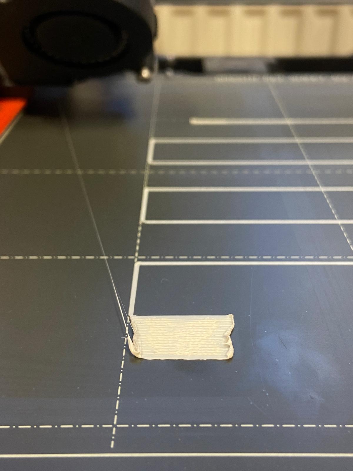

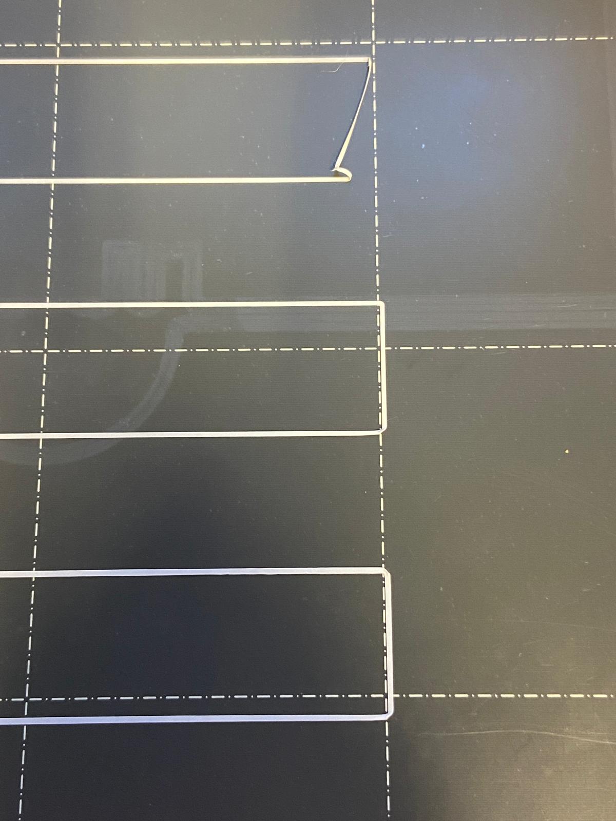

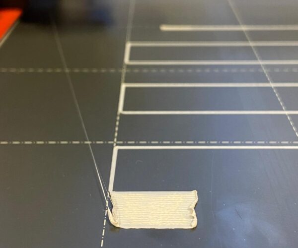

Hey Community,
My MK3s+ working with a 0,4mm nozzle is printing straight lines quite good.
As soon as the printer turns 90 degree (especially when he turns 180 degrees) the print is not sticking on the headbed.
Filament: Extrudr PLA NX2, 1,75mm grey
Temperature: 215 degree, 60 degree headbed

You may have a build-up of filament residue on the build sheet. A really thorough clean might be enough to fix it, if not (smooth sheet only) a wipe with acetone may be needed.
You probably know that in addressing the problem you have dialled the first layer offset a lttle too low.
